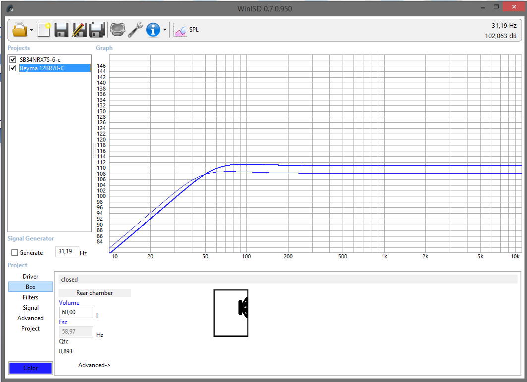

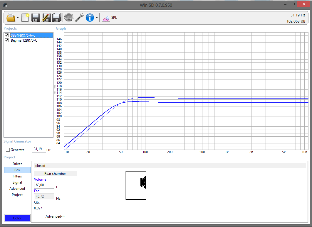

I can't read that picture as the resolution is to low.
But for the record, i simmed the SB i mentioned in a 60L case wit an 100W power amp and the Beyma in identical conditions, so you can compare. The Beyma is slightly more efficient and sounds good, the SB goes lower and sounds better. The choice is yours...
Even after clicking "expand to actual size"?
Jpeg compression blurs it a little bit, but other than that it reads just fine here.
I don't have that option, maybe it's my browser (Google Chrome) that i use for surfing. IE is configured to stay offline for my job on this computer (only intranet connection) for security reasons... But when i download the file i can see it. And again the SB looks the best for me on how low it goes (the main factor for the OP i thought).
