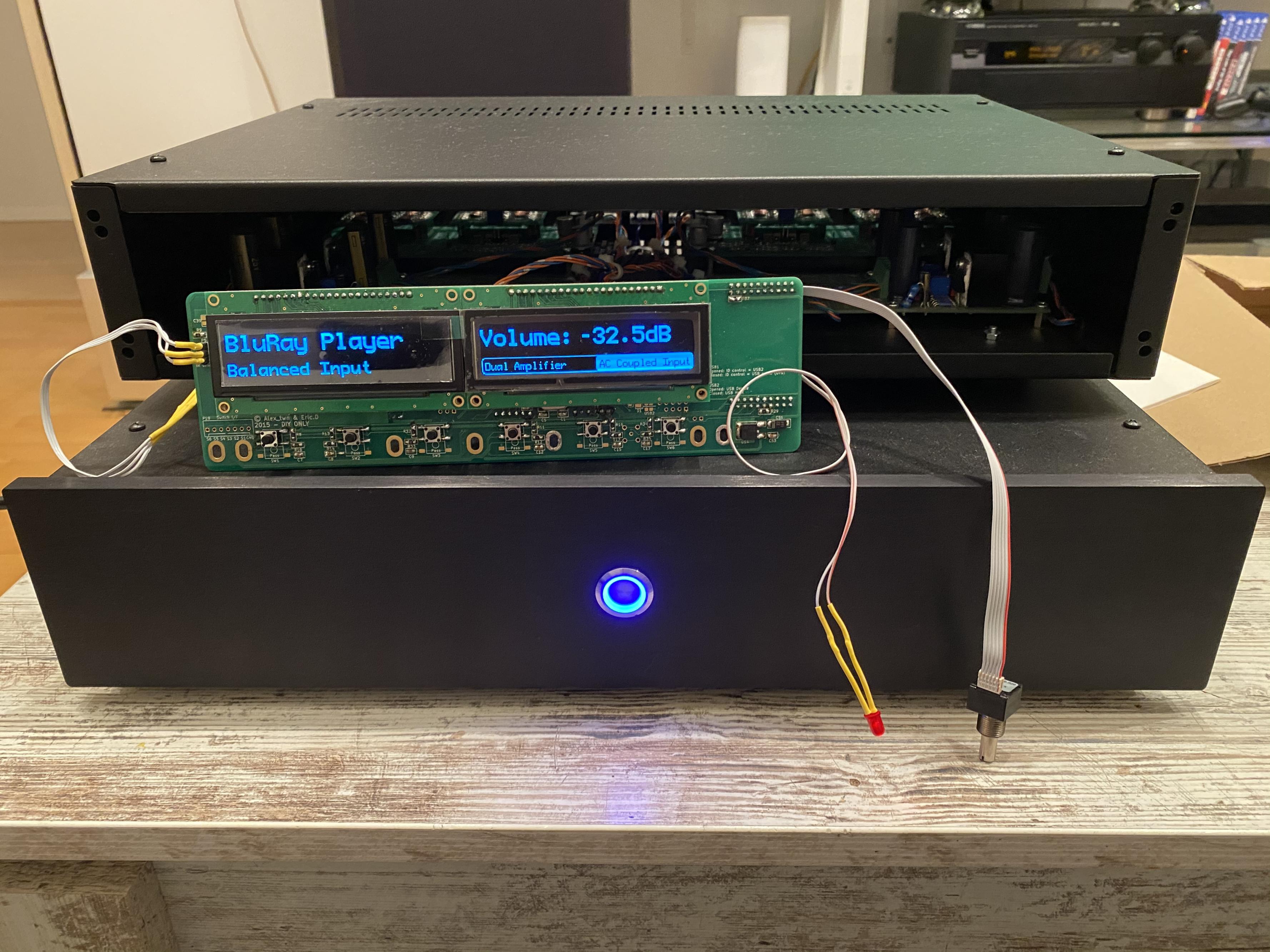

The firmware is ready. I am waiting for some to beta test it then release to all.
Who has already a working preamp?
I have a working unit (but with no switches and 2nd encoder not connected). But I won’t be sat in front of it until Thursday.

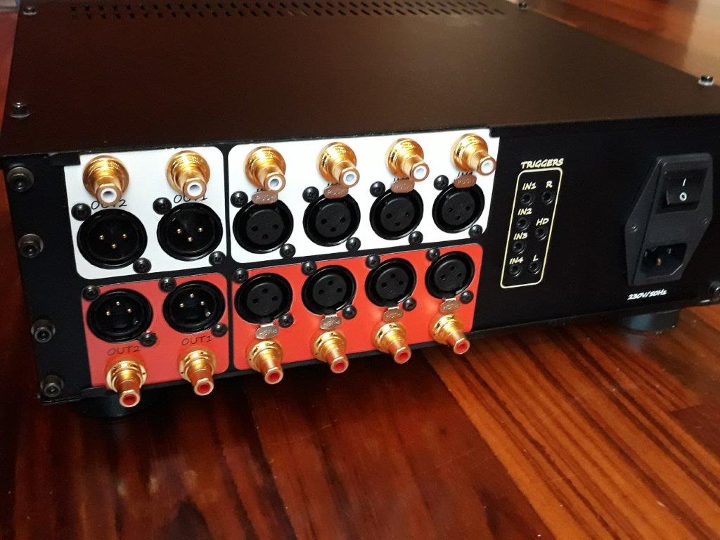

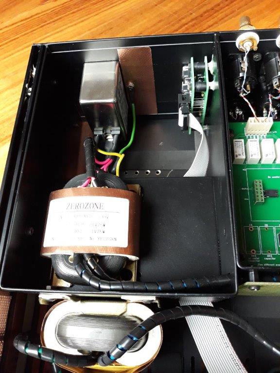

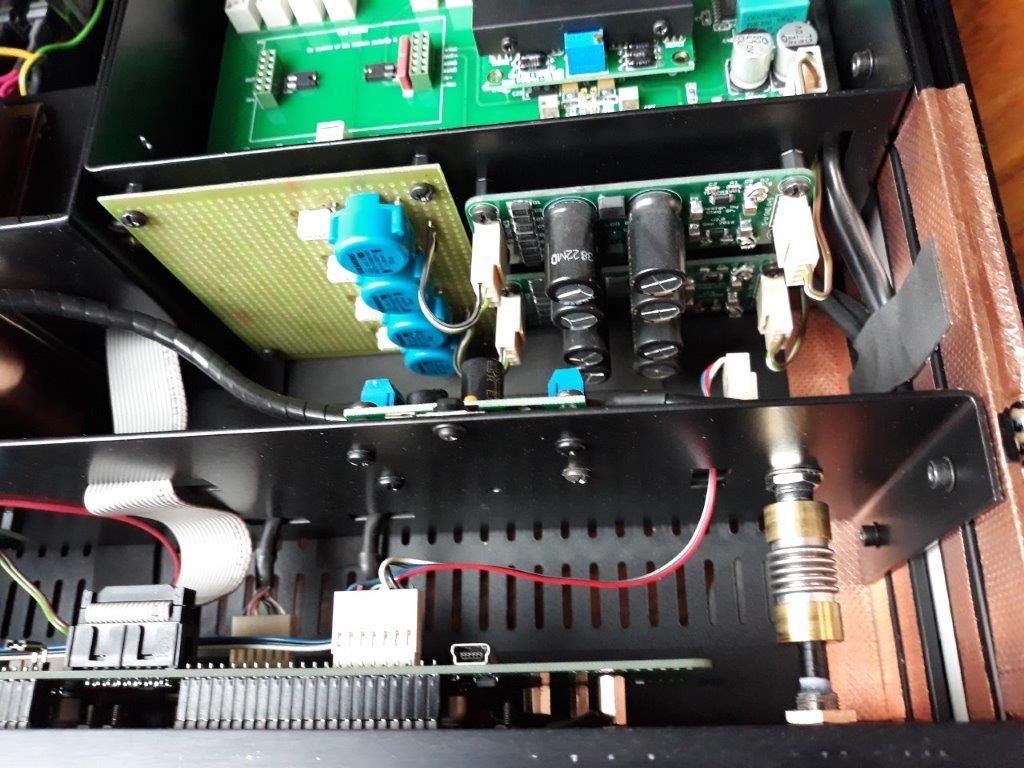

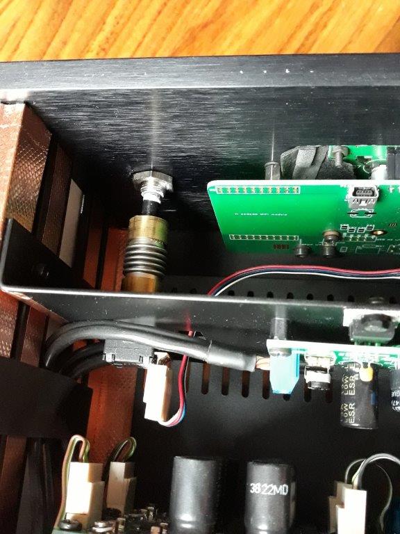

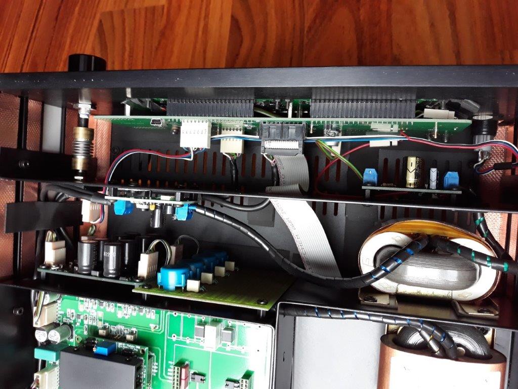

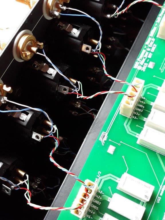

one enclusure
Some time ago there was a question here if this is possible to have one single enclosure for preamp and PSU. My preamp is kind of following this concept however I do not use original PSU.
So the concept is that both L and R preamp PCBs are symmetrical making it easy to located them one on the top on another. And this is what I did - in the section of enclosure where preamp PCBs are located enclosure is divided in half in height and PCBs are mounted to this bracket. This also applies to analog trafos. In the front controller board got its own mounting bracket which also provide some sort of shielding. And in the middle section there are +/-24V PSU and auxiliary +5V.
That resulted in pretty small factor preamp in enclosure 34 cm wide and appx 10 cm height.
