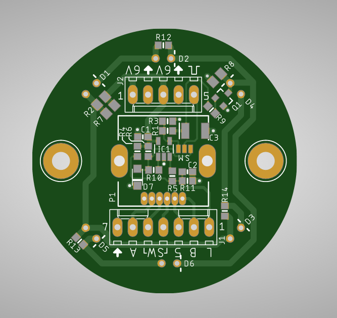

if i had to guess, the led behavior logic was mis-interpreted.
from what i see, it seems that the led was intended as positive switched... while the uC board bypass a series current resistor towards ground.
I think for a "standby" <> "operation" effect.
I think you can work around that by using the +5 line from the encoder and then (bypassing the trimpot) feed back via the led pin.

on my side i have designed an adapter to better suits my needs.
if it works as expected i can share the gerbers.

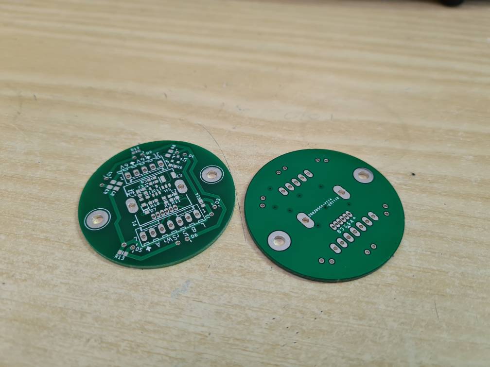

same board will be mounted to both left and right encoder, uses the 6v voltage line for the uC board to drive 6 (or 3...) led. the led will be the backlight of my "big" knob. like that (photo don't make justice...)
(that with just one led to see the effect)
they should ramp to full brightness ( ~2s ) when uC trigger it, and then ramp down to idle brightness when in standby.
One board will be the master, the other a slave. daisy chained.
... but that is all to be tested
@Chris, can you check the encoder board. Sorry for my doubts but I don't see + power supply for LED. As my understanding, P1_7 is connected to P4_1 on uC board that is also ground connection.
... there's always the possibility that i have brain farted, and mis-understood completly the initial intention of the designer 🙂 so... take my speculations with the proper grain of salt.

Sorry, just now seeing this. Yes, that is probably an error as this was done very quickly and I hadn't asked about the LED, but assumed. And we all know what happens with that.

My implementation is to carry two separate circuit, one for left and one for right encoder, with more current capability to drive 12 led in total.
Also i need a way to attach the 6+6 led to the front panel, and a pcb was a natural way to do that. Furthermore, two hex spacer will secure more nicely the pcb to the front panel.
Brightness ramp up / down is a collateral feature that cost me nothing to implement (always if it works as expected). Beside that, via firmware i think is achievable the very same effect in the current state of things by just pwm'ing the gate of the mosfet across the limiting resistor... not ideal, but could work.
sure, already noted, as reported just few posts above...
