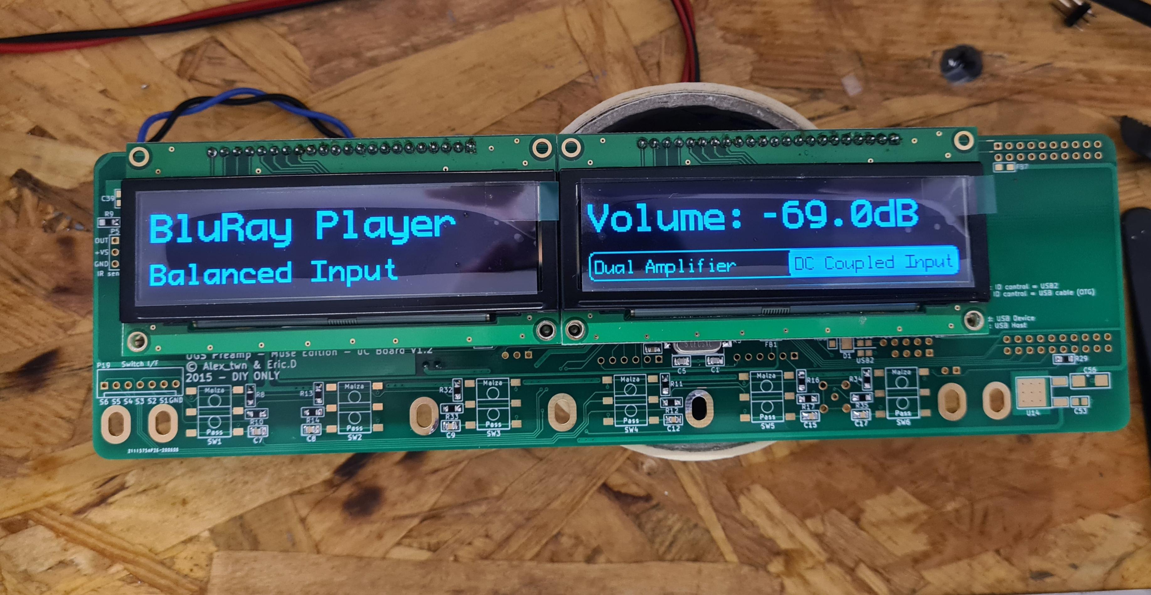

Hello,
yesterday i was able to complete the assembly of the uC board.
fitted with two OLED.
was able to push the firmware into the mcu. that, BTW, after latest windows 10 update seems to have broken the Dfuse utility.
The alternative, and the recommended utility to use from st is the "Stm32CubeProgrammer".
It support's perfectly usb dfu mode, but no longer read the .dfu file.
the .dfu is easily convertible to .bin or .hex (that is supported from the new tool by the utility "dfu file manager" that came with the Dfuse demo utility.
if someone needs the converted bin file...here is the latest .dfu available from alex, converted to hex
Dropbox - UGSMusePreampPCB1.2_v2.9.3_00.hex - Simplify your life

Good job Gionag 🙂
Right I should upload the .hex file as well now that indeed STM32CubeProgrammer is the right tool to use (I am still using Dfuse on my Win10 PC BTW...)
Anyway this binary is not the latest one and thanks to Paul M trial & feedback I am going to release very soon a new one fixing several display bugs and adding new modes to control the trigger & bypass.

... (I am still using Dfuse on my Win10 PC BTW...)...
I suppose you have installed the dfuse before the latest windows 10 update.
If that was so, then it continue working.
I have used the latest .dfu file available on the hcfr thread. is there a new file that i am not aware of that is already uploaded somewhere ?... Anyway this binary is not the latest one ...
Thanks !
No this is just a version under debug that Paul help me to kindly validate.
As written above will be released later on.
