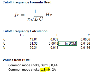

Eric06 - Can you please verify the common mode choke value for the digital section? I think the BOM may be wrong. To get a consistent cut off frequency should the value should be 18 mH (p/n RN112-0.5-02-18M) not 1.8 mH?
Also, can you elaborate on why 20 Hz was selected as the cutoff frequency?
Edit Reason: I didn't consider both capacitors when I first did the calculation so the cutoff was 30 Hz rather than 20 Hz.
