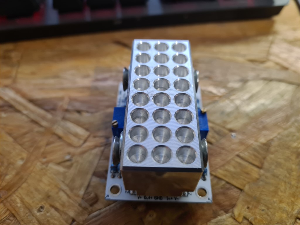

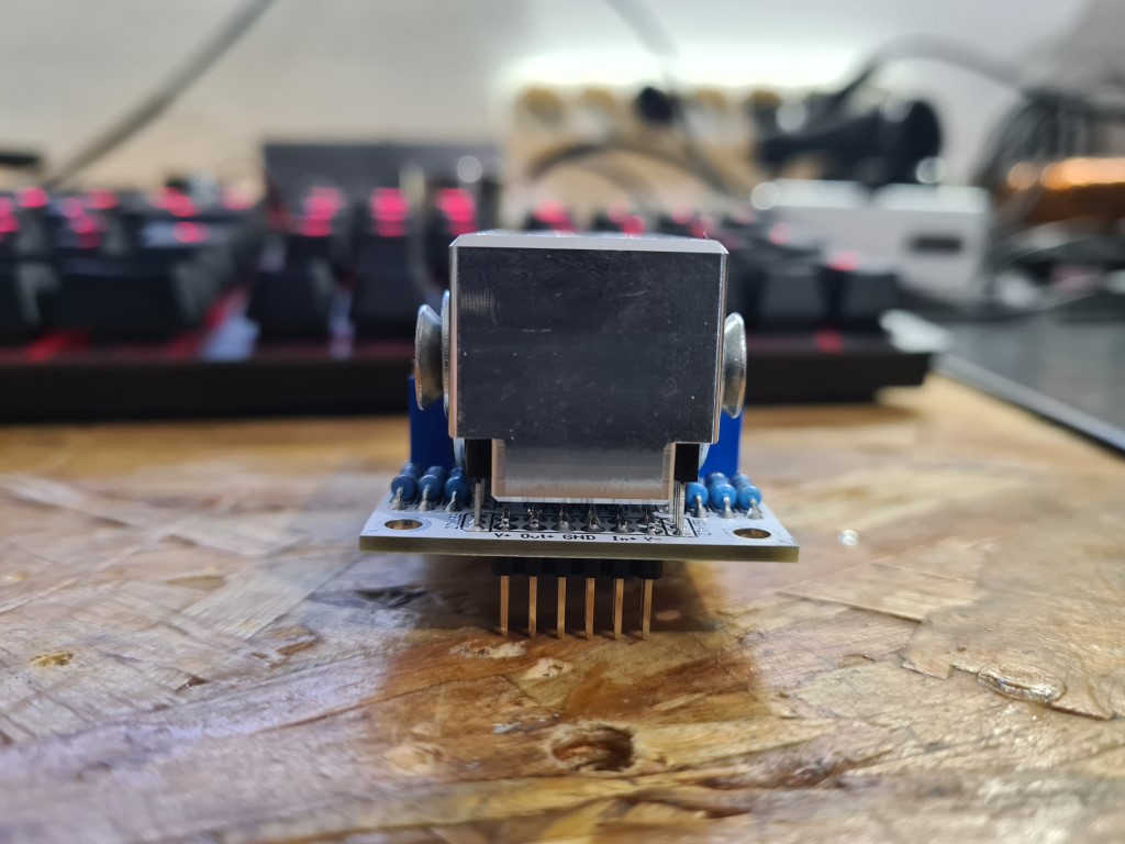

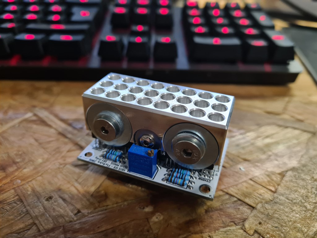

4 UGS modules (2 gain stage + 2 buffer) are already made (i was already using them on my "el cheap-o" pre amp).
BTW, if someone is interested, i have made a fancy heat-sink-coupling-mass for the ugs gain stages. just be aware that suits only the sk389/sj109 combo.
if someone is interested, we can arrange some groupbuy also for them.
I have a cnc at work (where i have done mine...) and i can replicate them at price of cost (+some margin for the consumables).
don't mind the ugly washer's / screw combo, i haven't got the right bolt length, and i have improvised.
Surely can be anozied in whatever color you like.
The triple slot per each side is done in order to take into account the slight differences in the component body width and guarantee the best possibile adhesion.
just let me know.

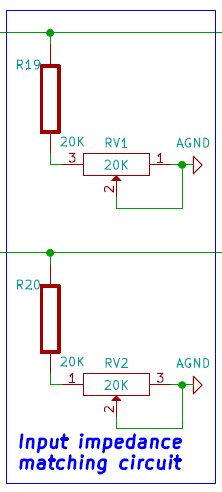

can someone make some light around this input matching network ?
how it supposed to be tuned ?
i will use both M1 as gain stage and M2 as buffer.
what is the best input resistance that ugs gain stage is supposed to see ?
my instint says that i will tune that for maxmim Zin... but maybe i am missing something.

Hi Gionag,
I’m sure Eric and Alex can give more details on the input impedance matching than I can.
In the meantime, the way I adjusted it in my implementation is described here: <<UGS - Muse edition - Page 25>> - 30058092 - sur le forum <<Amplis et Preamplis>> - 1056 - du site Homecinema-fr.com
Basically, without any module and without power, adjust the trimmer for each leg of the circuit in order to get the same measured resistance between AGND and the corresponding test point. I remember setting mine to 12K, but not sure if another value would be more optimal.
Hope it helps

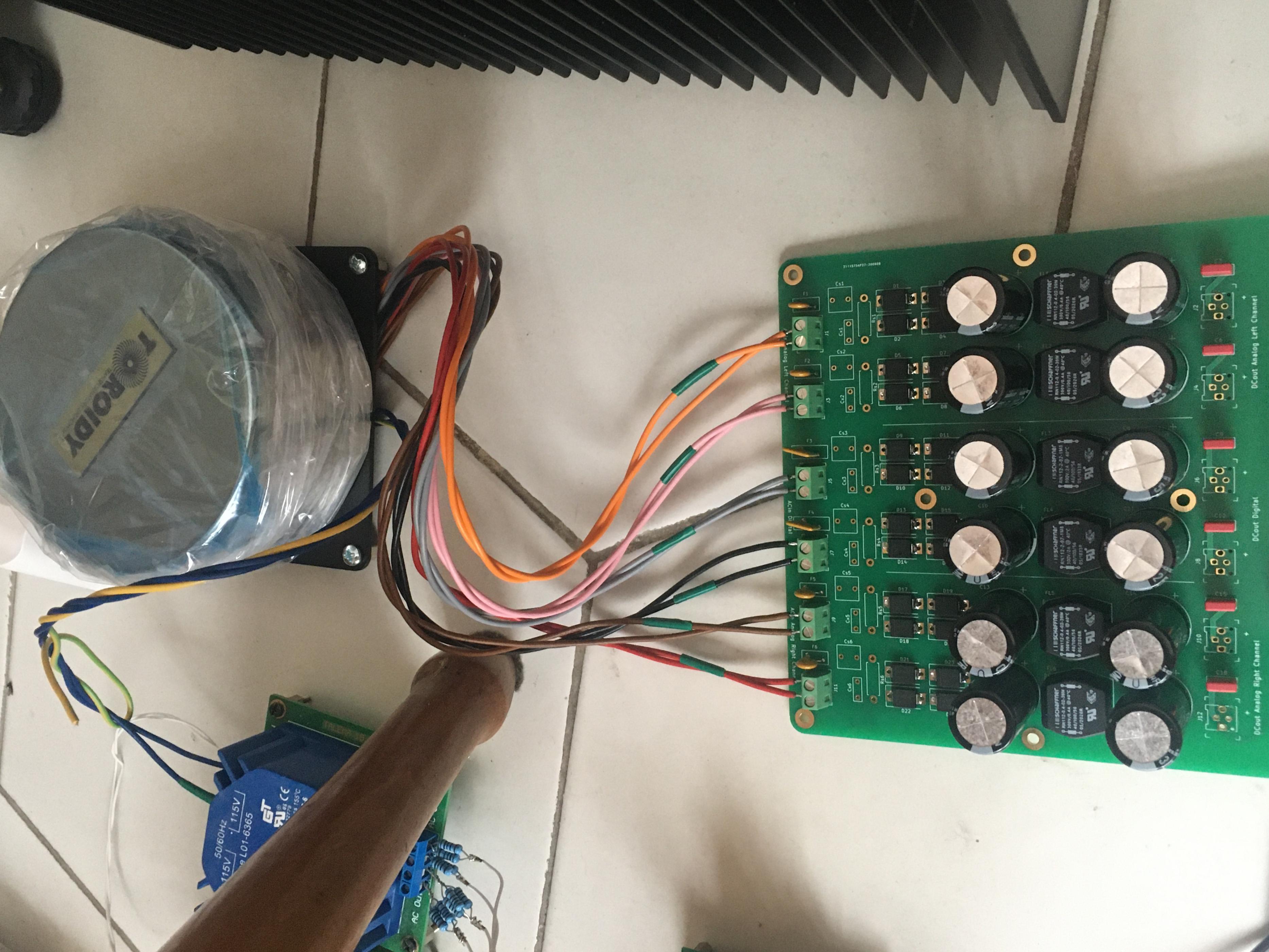

I got my transformer today. The waiting time was not so long as Toroidy quoted initially. Working nice. With 28vac secondaries I manage to get 37v at the input of the shunt regulators. I think I will go for 30v after the shunt regulators.
