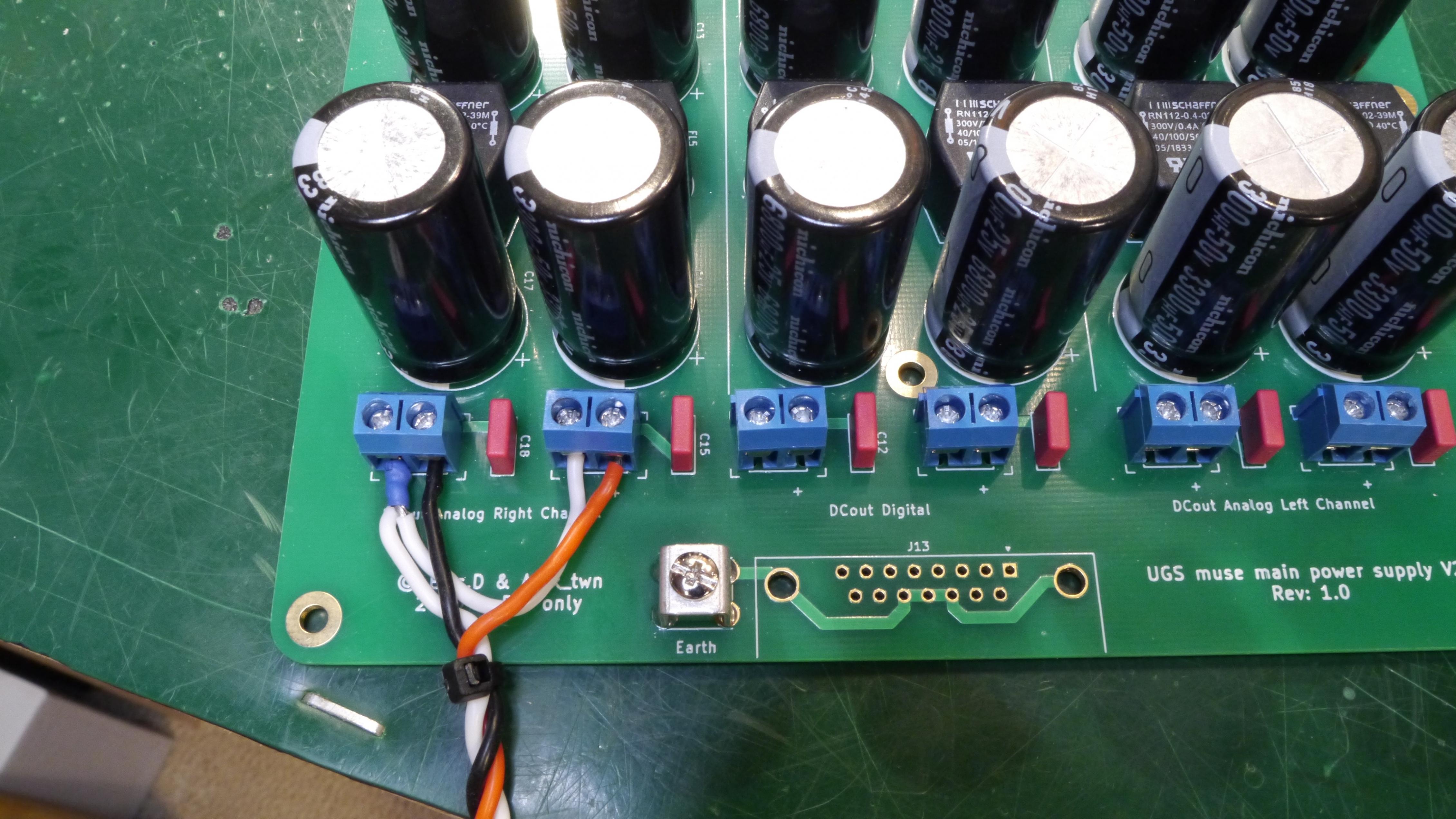

I've been doing some testing on my main PSU board and can't get the desired +- voltages. Per a post by Eric awhile back, he provided a diagram that mentioned you need to tie GND-R and GND+R together when going from the Phoenix connectors on the PSU, to the 3-pin connectors of the regular PCB.
Therefore, according to the PSU schematic I tied those (pins 1) together and still cannot get a negative voltage (-46), as would be expected if I tested with my DVM. Shouldn't I get a - and + voltage relative to the GND? I get the correct positive voltage(+46), but if I leave the negative probe on the tied together GNDs, I still get only the positive voltage regardless of which rail I measure. At the moment, I'm not planning on using the DB15 connector.
First of all, do I have the wiring correct shown in the attached image below? I'm obviously doing something wrong, or miss-reading the schematic. I did notice a difference between the Left and Right channels of the PSU, but I think it was just some miss-labeling when it was originally laid out.
Sorry for such a basic question. 🙂
Thanks guys, that did it. However, I think the markings on the schematic may need to be revised. Clearly, pin 1 on the left connector (J12) is shown as tied to GND-R and pin 2 to V-R. I hope I haven't damaged the one completed Salas Shunt due to this. Further testing now to check. If you look at the L-channel rails on the schematic, the markings are different. 😕
Yes you are right, I just checked the schematics and it looks like there is a little problem here with the net labeling on the right negative rail.
GND-R and V-R seems swapped.
Sorry about that.
If you connect as it is you should have 2x positive rail, hopefully your negative Salas shunt did not suffer from this...?
To all please hold on while we provide a corrective, I am going to check with Eric.
Oops, indeed my mistake. I picked up and inserted the wrong schematic when I created the overall documentation for this board.
Here is already the schematic that matches the PCB that you have received.
The full spec will be revised later on (tonight hopefully if I managed to recreate my usual working setup as my main PC died a week ago).
Deeply sorry for the trouble and I hope your negative Salas regulator didn't get damaged by this polarity inversion.
