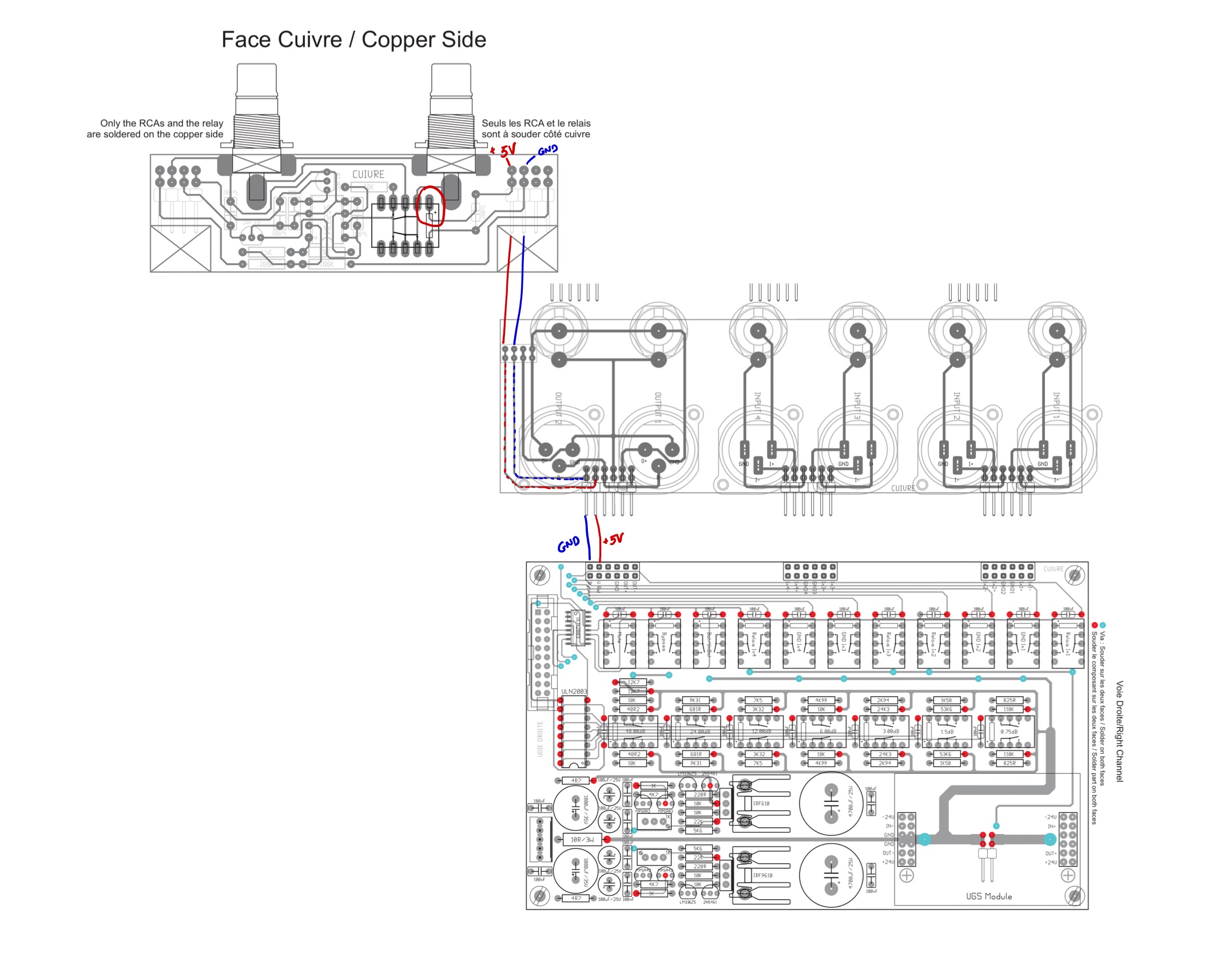

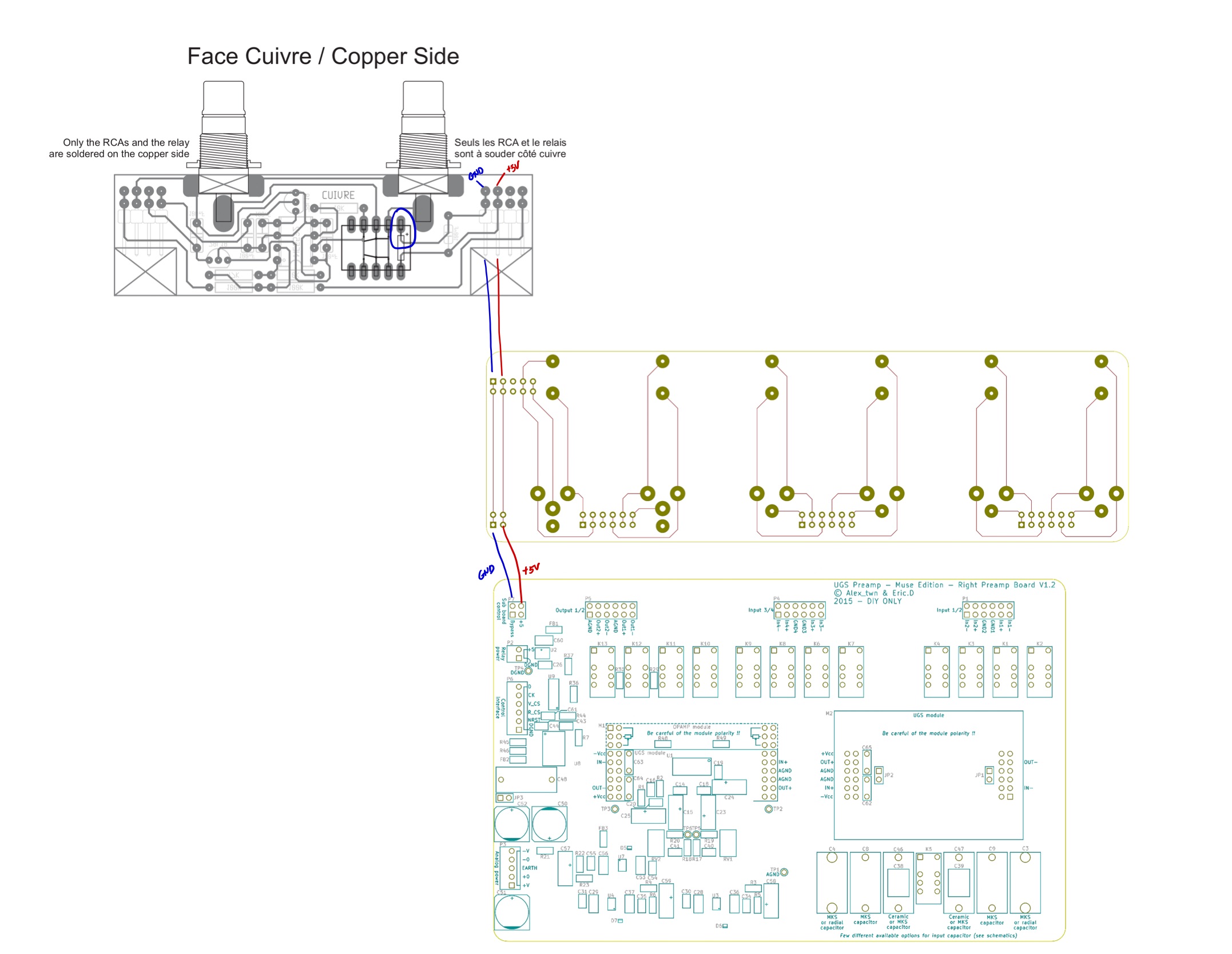

I found a small issue with the upgrade from the UGS All-Inclusive to the UGS Muse. After finishing the upgrade, I couldn't get any output from the subwoofer board: the relay wasn't activating.
The reason is that when using the subwoofer board from the AI set of boards, the sub relay +5V and GND are reversed on the Muse version. The result is that the relay coil polarity is reversed and the relay is always set to bypass mode.
When mounting the relay on the subwoofer board you must disregard the small + sign and mount the relay on the same side as all the other components. If you are re-using an already built subwoofer board from the UGS AI, with the relay mounted according to what was specified for the UGS AI, you must remove the relay and mount it on the other side of the board (with the other components).
I'm adding pictures to make it more clear.
Paul
Thanks a lot Paul for your investigations, you are right !
Damned I did not realized this 😱 😡 but probably because I don't use the subwoofer board which I find useless on my side.
Sorry about this and yes mounting the relay on the other side will set back the polarity correctly.
