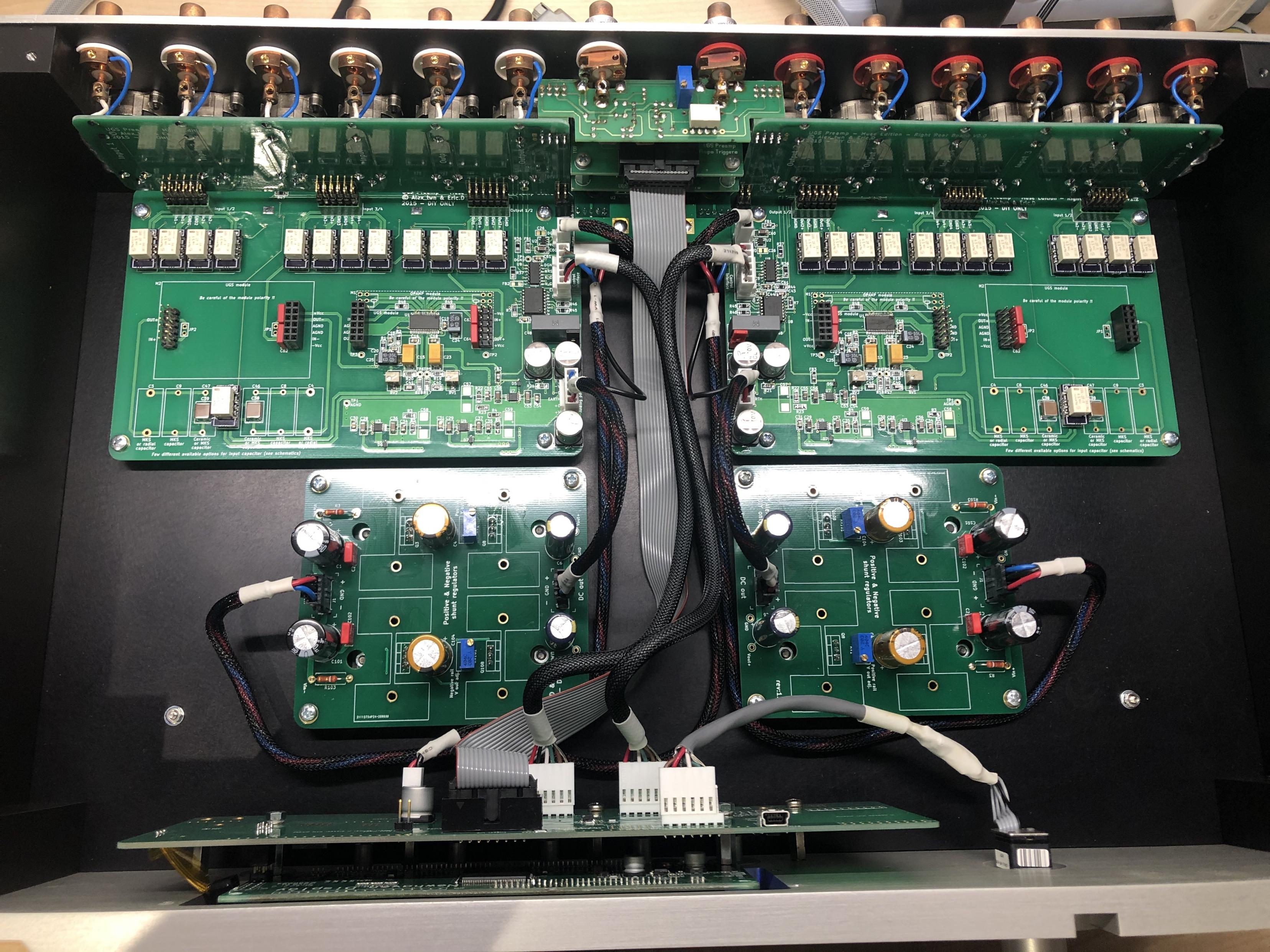

I'm finishing a 2 channel build of the UGS Muse and I was wondering if you could add an option for a 32 step encoder. I'm re-using the Grayhill 62A11 optical encoder from my original UGS all-inclusive build.
With the encoder settings to 1 step I need to turn the encoder 4 times to get a change of state, and with the settings to 4 steps I need to turn it 8 times. Given that it an optical encoder that functions like a mechanical one, I've added R23, R24, R36, R37 and C26, C33 as specified for a mechanical encoder (10K and 10nF).
As for the rest of the build, just a bit of a warning for others: I've had a very hard time getting rid of solder bridges with the Muse ICs. I'm not sure why since I usually don't have this sort of problem with other fine pitch ICs. After having burnt 1 Muse (did I overheat it trying to get rid of the small solder balls behind the pins? or did I leave some behind?), I've pulled out a DSLR with a macro lens to make sure I didn't miss any, and I still had some solder stuck behind some pins that I couldn't see with a magnifier (I'm a young padawan, so my eye sight isn't a problem yet and still missed them).
In the meantime, here is a picture of my almost complete UGS Muse to encourage others.
Paul

Hi Paul,
Nice job ! You are fast ! If I remember well I sent you your parcel not too long ago.
Let me check at how I implemented the prescaler on the encoder, it is just a software adjustment, should be quite easy to do, I could even add more settings to accommodate other encoder resolutions.
You mean that now you need to do 4 steps to have 1 increment / decrement?
Right for the fine pitch, DSLR with a macro lens will do, on y side I use this kind of microscope camera and definitely prevent any shorts, I recommend this or similar to one that would value the investment Microscope camera
