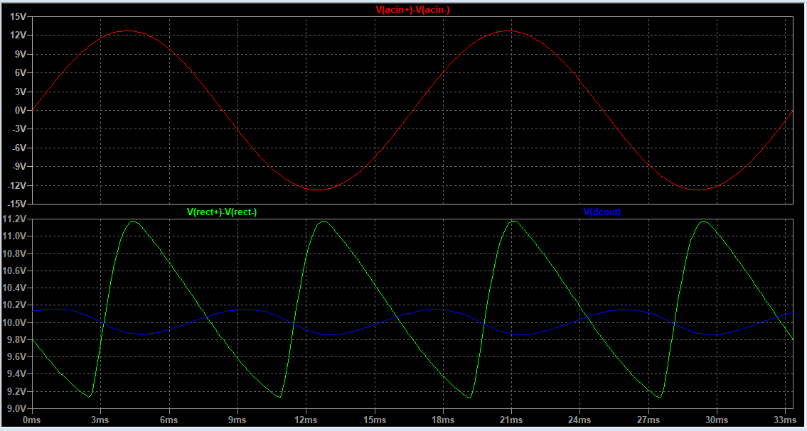

You also need to consider the max current rating of the RN112 choke (2A for the 1.8mH vs only 0.5A for the 18mH) and I didn't want to make tradeoff on this parameter.
Given I am using a full wave rectifier, the ripple frequency is 120Hz in your case so if I agree a lower cutoff would provide even better ripple characteristics, the present filter seems pretty OK to me if I trust my spice simulations results (using the 1.8mH choke).
In red, the AC voltage provided by the transfo, in green the voltage after the rectifier bridge, in blue the digital DC output.

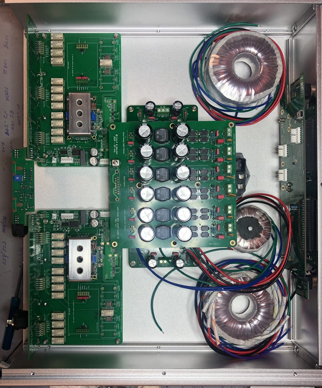

depth is 350 ?
alu top / btm is good as the steel one ? (any issue with the internal clearances ?)
on top of that, can someone share some picture of the details for the trigger two-board assembly ? i don't quite get how it is supposed to link together... maybe with some wire bridge ?
thanks

Mine is shorter, 350mm is not needed.
I think some people did it in 170mm but personally I don't like as it look too short from an esthetically point of view especially when stacked with other audio equipments.
In the end it is really a matter of what you put inside.
Mine is steel but I know some used the aluminum without issues.
And right for the trigger boards it is just a resistor leg that you need to put in all wires that faces each other after chosing the right vertical PCB position in your chassis
