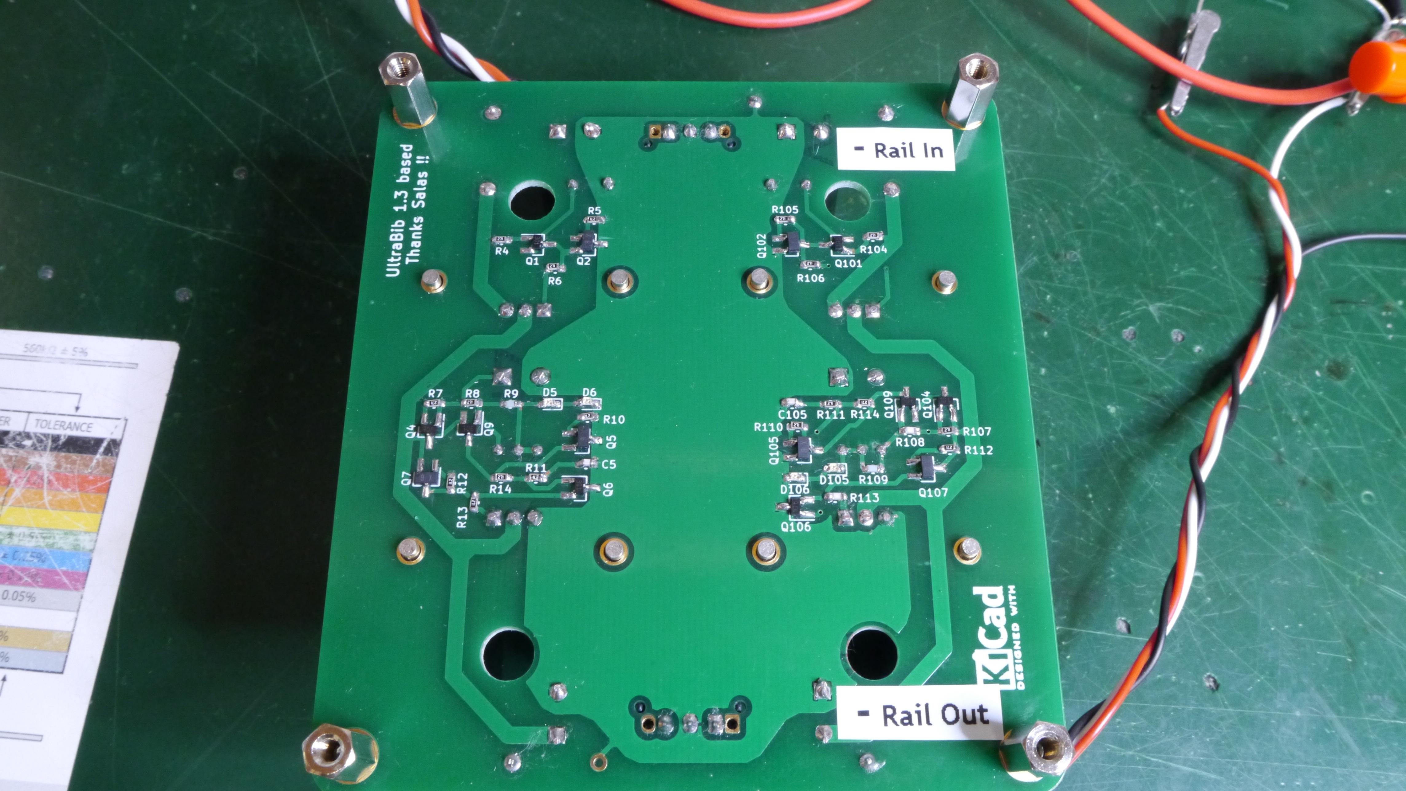

Could you post a pic? are you sure of the value of each component..and you measure also R5,R10,R12 voltage like you did with R105, R110 and R112 to compare with NRail

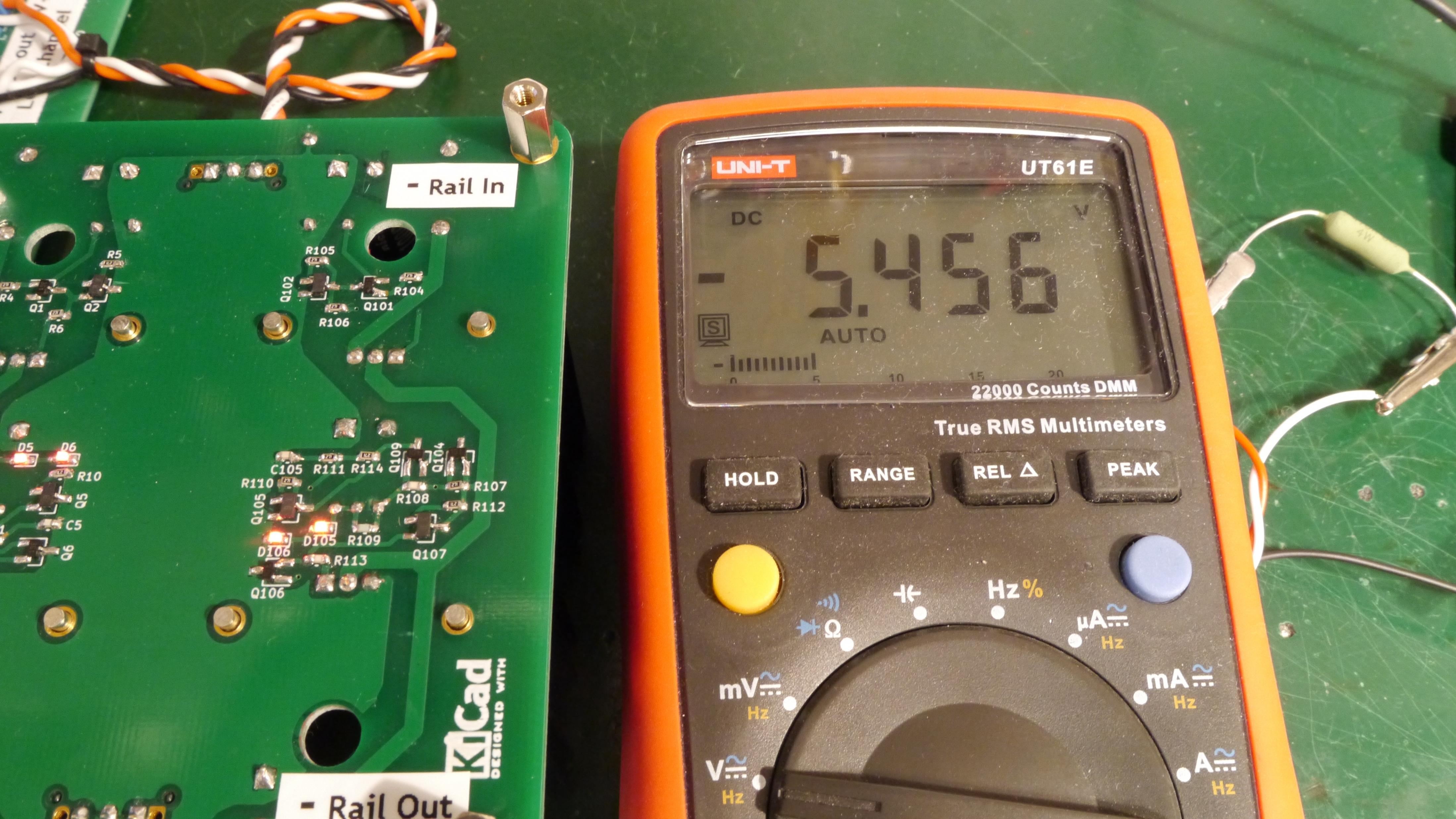

At this point all the MOSFeTs have been replaced and several of the 270ohm resistors. Still no change. I'm not sure what I'm getting crazier over; trouble-shooting this PCB with no positive results, or our US election and the aftermath in the news non-stop. I'm a bit of a political junkie too! :) This hobby is suppose to help balance things out a little.
Is-it the board you power voltage reverse?
If so, you may also try to unsolder the electrolytics caps one by one starting with C104.
But before doing so, do verify there is no mistake with the passive resistors values if not done already.
Power to the board is correct. I'm getting +- 40VDC after rectification and going into the shunt board. Haven't verified every resistor yet, but a few of 270ohm ones have been replaced including the 75K one.
Not this then! Damn.

Across R103 I get 600mV
Across R105 I get 261mV
I replaced C104. The old one measure a bit low at 192mfd
Nothing changed. Still about -5.4V output.
