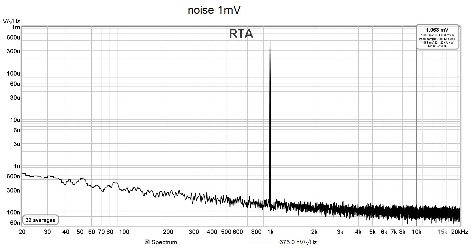

out of curiosity I`ve done a measurement to look at the noise on the output. The input of the soundcard that I used was calibrated first of doing this measurement.

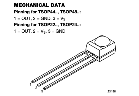

No, it seems to be in correctly per the datasheet. What key combination did you use for pairing it? I had started with holding down MENU and right arrow for 6-10 seconds per the paperwork. I then tried MENU and SELECT. Neither worked. I believe they are TSOP2436 IR receivers. Board markings match (OUT, Vs, GND).

I am not familiar with the procedure you are attempting.
Once the ir receiver is connected properly you should power on the preamp then enter the Menu after which you will navigate to Remote ctrl settings and enable Remote 1 then go to Remote control setup. Select the NEC protocol and then go to Remote control code setup and select the functions you want to implement from your remote.

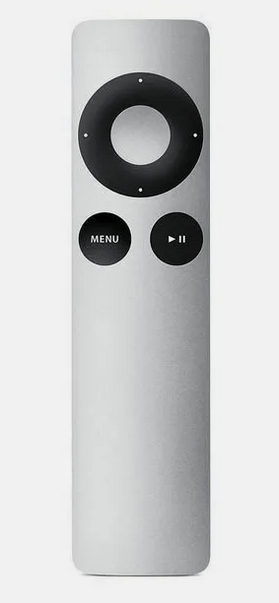

I went to the Remote ctrl settings on the preamp, enabled Remote 1, and selected the NEC protocol. I'm not seeing a Remote control code setup? Is this in the UGS menu structure? This is the remote I have:
