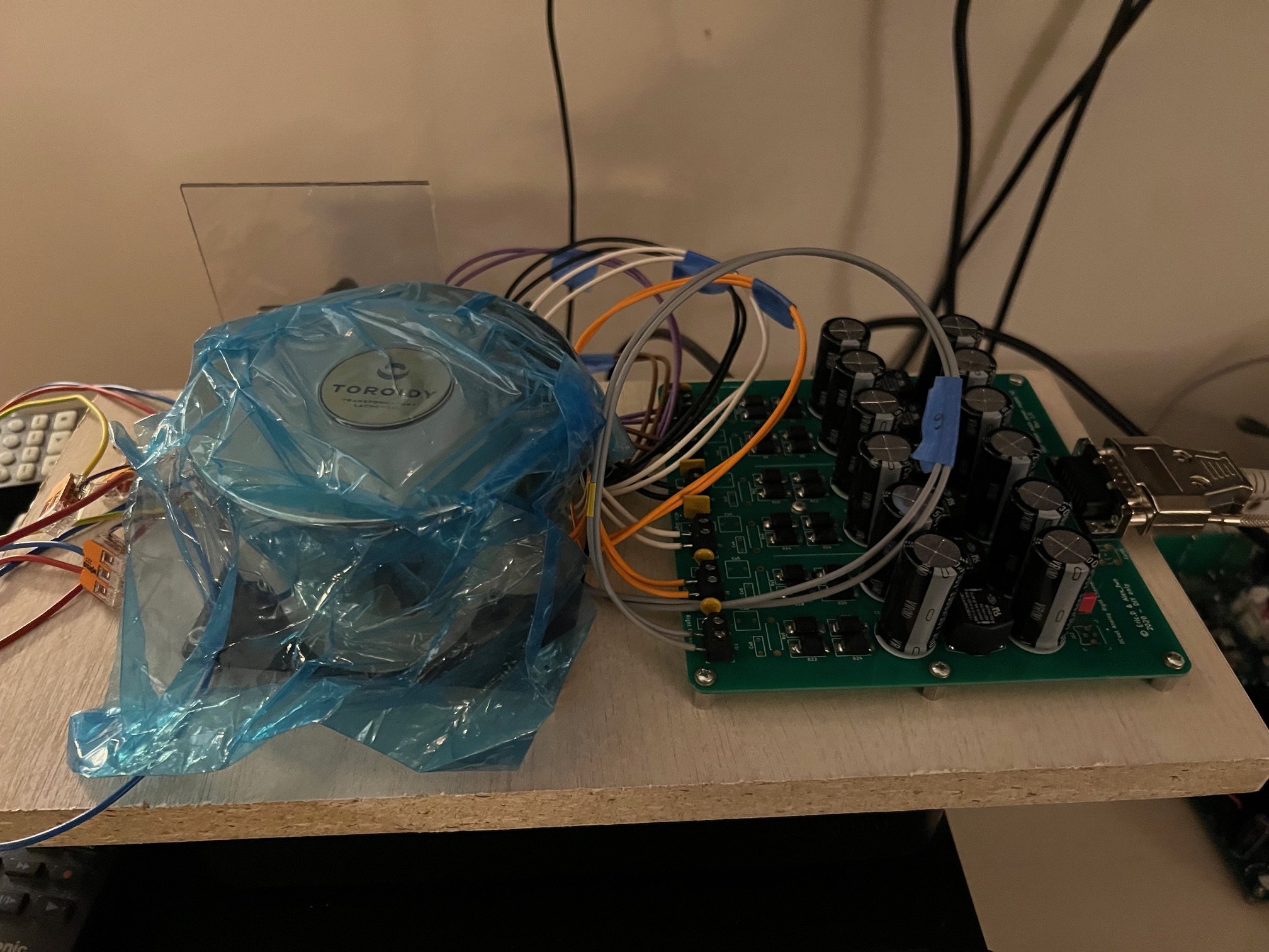

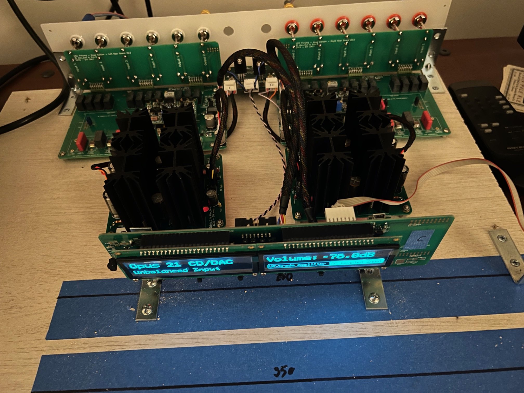

Getting there with this, should be able to test functionality next week. Built both UGS cards, and they both came up with no issue. Checked a couple of things from the troubleshooting guide, but no issues.

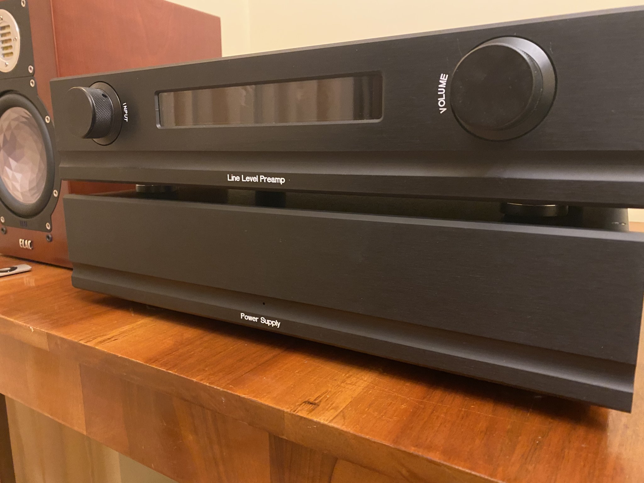

Got around to firing this up and testing it. No issues. Ran RMAA on it, looked pretty good. Put it into my main system this afternoon and it sounded good. It will take awhile to decide whether this will replace my Pass Aleph P or not, but it is nice. It will also be awhile before I get around to casing it up, so it won't stay in the main system at this time since it is just on a couple of boards.
The gain stages are UGS 3's. I had some J109/K389s already, and built it with standard parts (ZTX450/550), though I did use some Wellwyn RC55s in a few spots on them.
