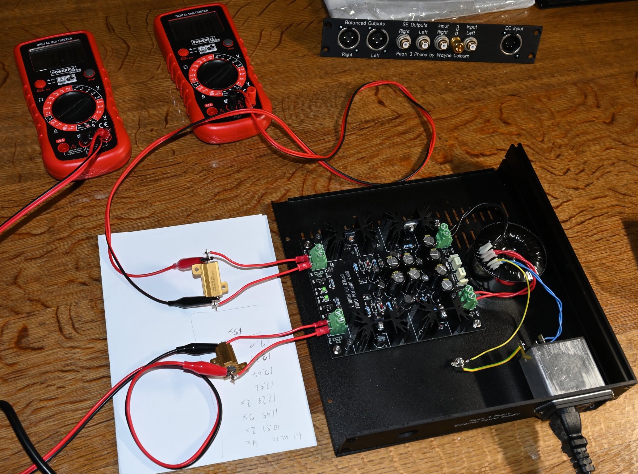

I powered up first time for testing if everything looked ok. It seems so.

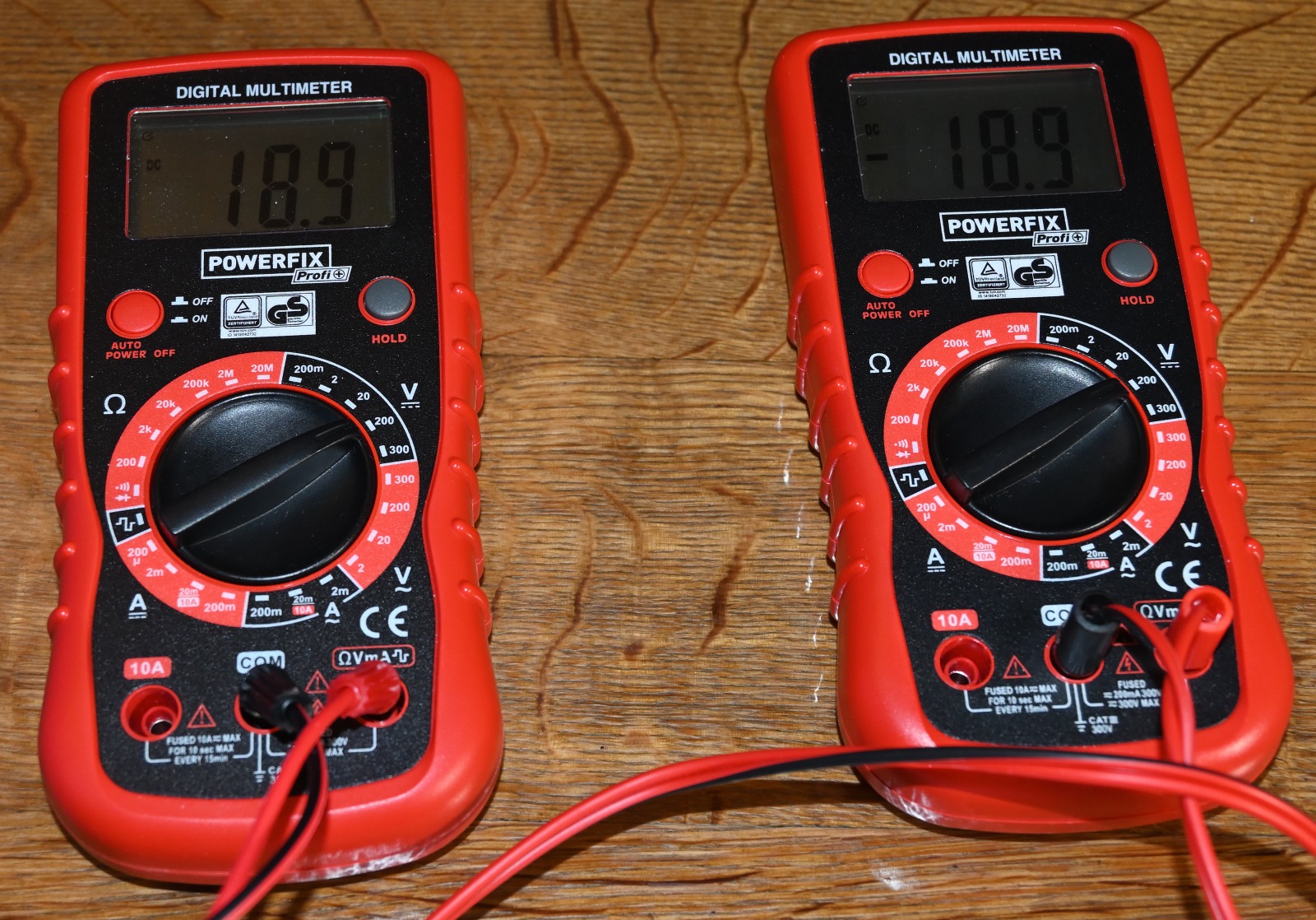

I get -+ 18.9 VDC out with 100R as load resistors. AC-in is 2 x 22.3 VAC.
I will let it "cook" for some time.

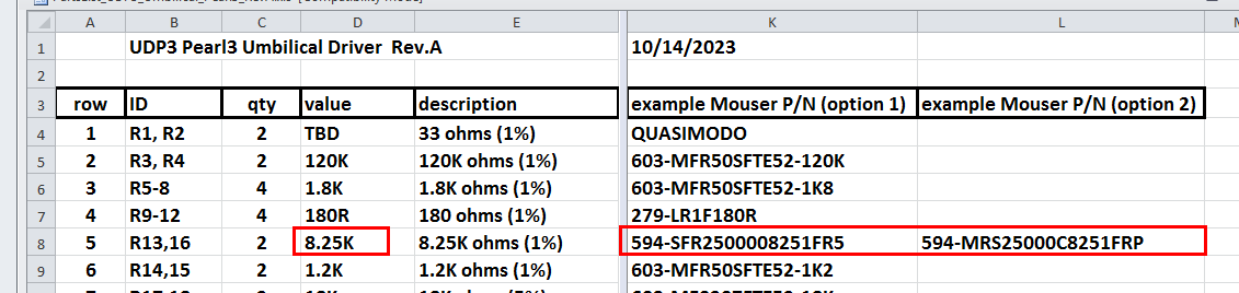

Reason for 18.9 VDC and not a bit higher might be that the 8k25 resistor which has something to do with the adjustable voltage reference I installed 8k2 as I already had those. I measured them to find high values but they were just low on 8k2. But think I am ok with 18.9 V. There will be a little bit of loss in cable but still at least 3.5 V for the 15V regulators to regulate. I guess it is about perfect.

Yes, 18.9 volts is indeed "approximately 19 volts" as the UDP3 design promises, and Pearl 3 will operate perfectly normally with that input voltage. A margin-of-safety has been included, to accommodate any additional voltage dropped across the umbilical cable and the DC connectors.
It is not a wise move to haphazardly change resistor values in the control circuitry of a chip (AZ431AZ) that you paid extra money for, to get a guaranteed accuracy better than 0.4%. Especially when the Detailed Parts List presents another option.

Yes, yes I know......but my assumption then was that I had the 8k2 and I calculated the value to be within the +-1% 🙂
I also measured the 8k2 I used to be sure there were within the limit of -1%.
I looked a little bit into the voltage reference to try to predict if I would get a bit lower or higher voltage. I think I concluded that maybe the voltage would be a little bit lower.
It has run for a couple of hours now and only the load resistors gets really not. Mechanical it is 100% silent.
I tried the inrush test a number of times to see is primary fuse (160 mA T) could take it. Toroidy specifies 160 or 180 mA T for the 20 VA transformer.
Looking at DMM it takes 8-9 sec. to reach the final 18.9 VDC.
