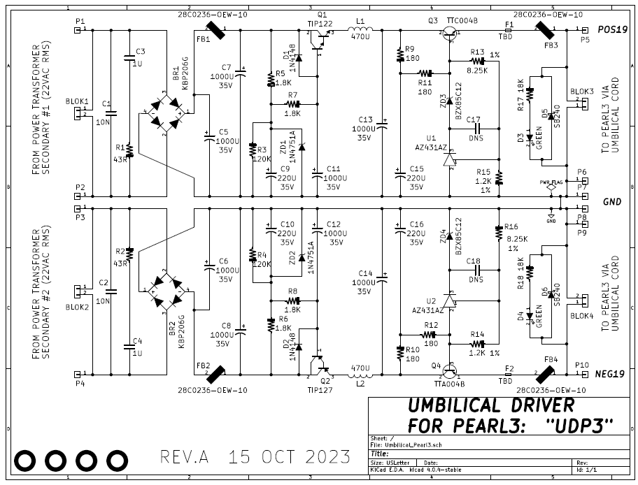

Readers of this thread might get a couple of chuckles or minor amusement from posts #1 - #3 on (another thread). Those members say that output protection diodes (exactly like D5 and D6 on the UDP3 schematic) improve "low high mid very details". Who knows, in their experiments, on their gear, in their listening room, using their source material -- perhaps it does. Please enjoy their thread as a bit of jolly mirth, and acrimony-less diversion.

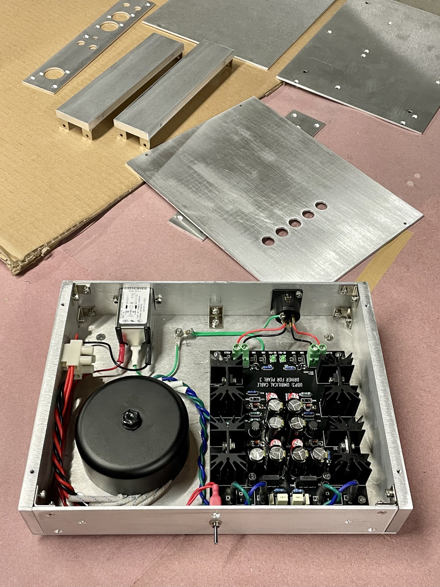

Some progress today. UDP3 board finished with Rs snubber value, baseplate drilled & trafo and board mounted. Will finish drilling and filing out the backplate and mounting the plugs & sockets before power up, most likely.

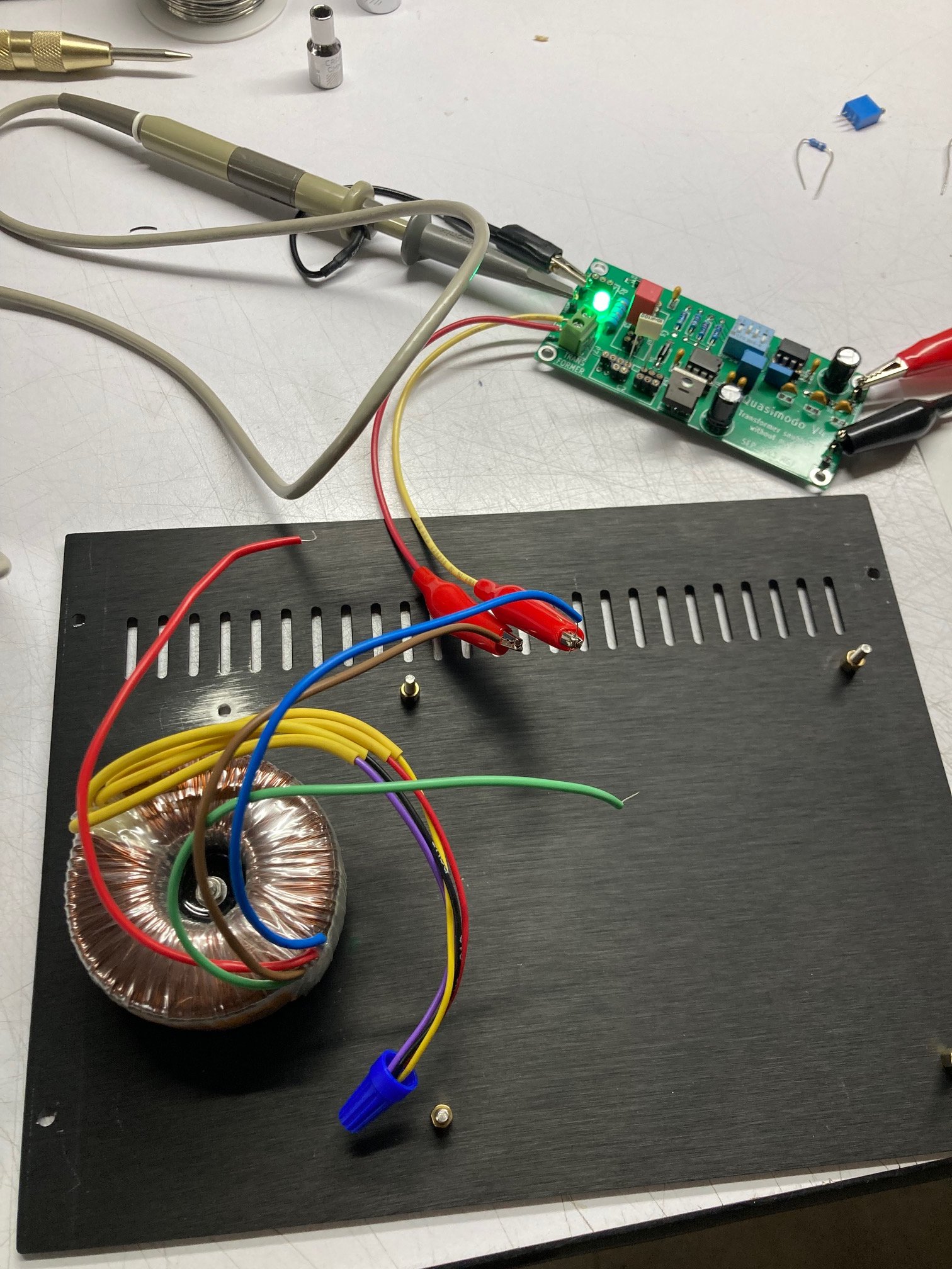

It looks like you purchased and installed and soldered C3 = C4 = 1000 nF = 1.0 microfarad as shown in the schematic and parts list; those red WIMA box caps look familiar. Post #1 of this thread says,
If you run it on Quasimodo, remember to use 1000 nF and not 150 nF in your QM testing.
You'll notice I have used C3 = 1000 nanofarads, and 1000 != 150. I spoke to the Quasimodo inventor about this, explained my reasoning, and got his approval. So use 1000 nF in your build (see Detailed Parts List) and be happy.
I did indeed Mark, thanks for checking! One can just see the same red box Wima 1uF and little pale yellow guy in the photo below of my Quasimodo testing rig. I would be curious to know the rationale behind the change in the snubber capacitance values for the UDP3.
For my transformer there was a negligible difference in Quasi waveform for the 1uF vs 0.15uF "standard"....22R in my case seemed to look the best, per the docs.

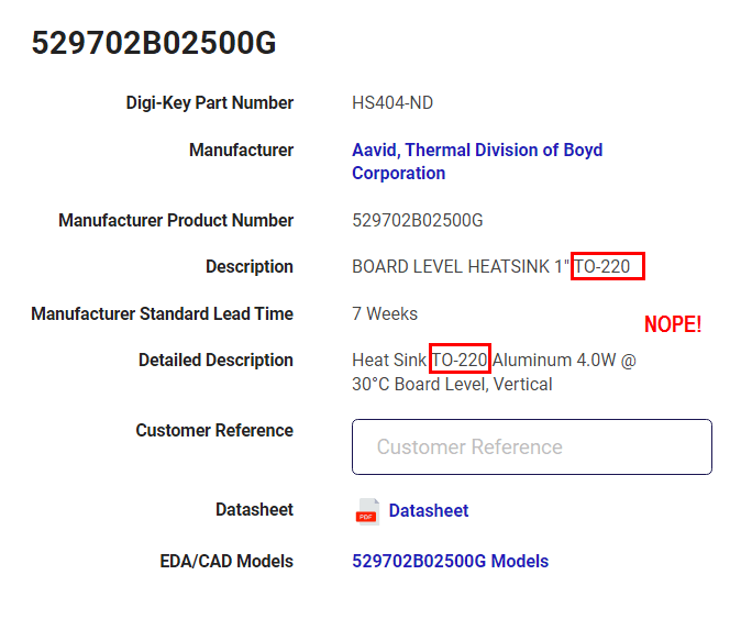

Some people are worried that the same heatsink (AAVID 529702) is used for the TO-220 packaged Darlingtons and for the Toshiba TO-126 packaged singleton BJTs with high-fT and high-Beta. But, but, but ... the worry warts blubber ... the distributor says that heatsink is only for TO-220 and not for TO-126. Attachment below.
Fortunately, fearless amplifier builders actually TRIED the combination, and in practice: son of a gun, it actually works just fine. This is because (a) even though the transistor mounting bolt-hole on the heatsink is far, far away from the PCB surface, a TO-126 has leads long enough to penetrate all the way through the board and offer plenty of leg length on the other side for your soldering iron; (b) diyAudio members generally order standard-thickness PCBs (1.6 mm thick) and not I-am-a-crazy-person extra thick PCBs (3.0 mm + huge price increase).
I recommend you use the heatsinks in the UDP3 price list. They work. Look at the photos in post #39 above. The TO-126 transistors + heatsinks work together delightfully on the PCB. Despite what DigiKey and AAVID might caution you.
