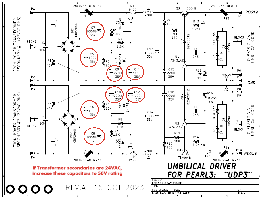

Remember that UDP3 uses 22VAC secondaries instead of 18VAC.

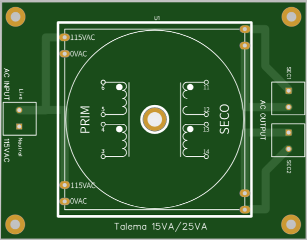

I’d be interested in a similar PCB as well, those little blue transformers are great.
UDP3 yes 22V but are you using 15 or 18v for the regular pearl3 PS? I went with the BOM 15Vx2, comes out to ~22 V filtered under load (per side). I figured ~7v drop on the 78(9)15 is sufficient to clean the DC up.
With the heatsinks specified on the UDP3 detailed parts list, the power transistors will survive nicely if you use a 2 x 24VAC transformer.
Unfortunately, the first stage electrolytic capacitors will not. Especially when the AC mains voltage is at the top end of its (Nominal ± Tolerance%) range. These electrolytic capacitors need to be rated for 50 volts when using 24VAC secondaries.
The detailed parts list tells you the required lead spacing (to fit the PCB footprint on UDP3) and the capacitor diameter; these will help you perform a Parametric Search on distributor websites like mouser.com . Capacitor height is 100% your choice; pick any range you can live with. I personally prefer electrolytic capacitors which are not as tall as the heatsinks (26 mm) but sometimes that's not possible with the parts in stock and on the shelf, the day I am placing an order.

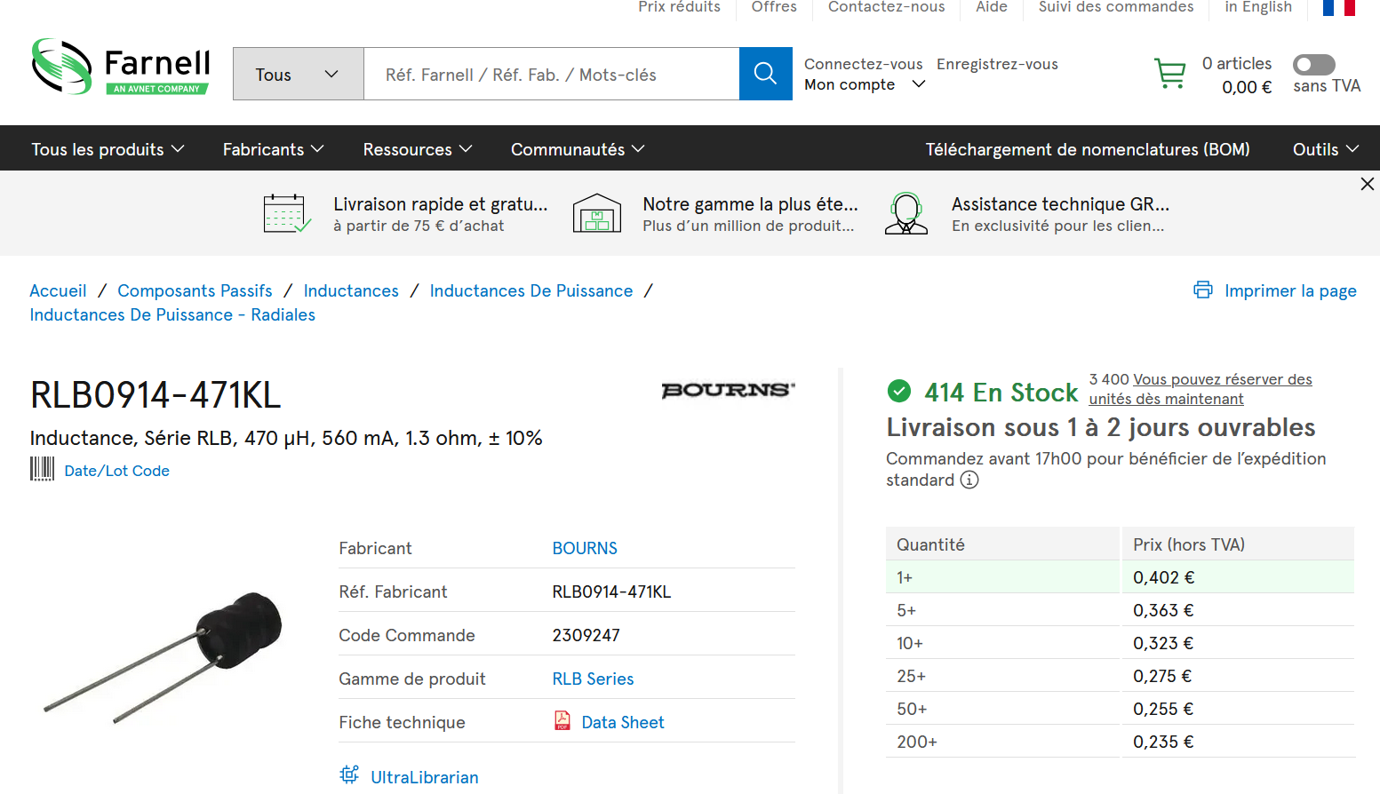

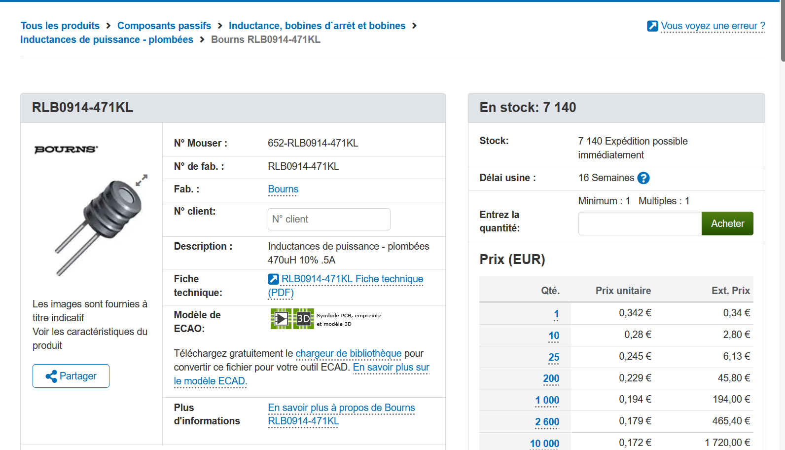

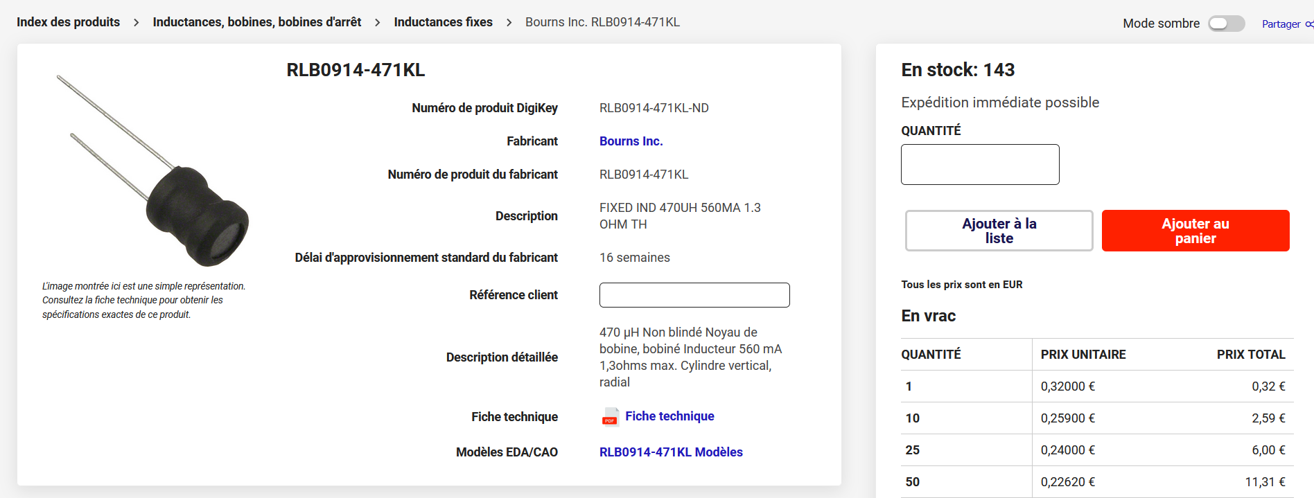

These three inductors are the only ones I recommend for UDP3. Buy them at the same time you buy the ferrite beads, from the same seller.
