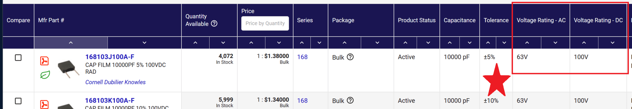

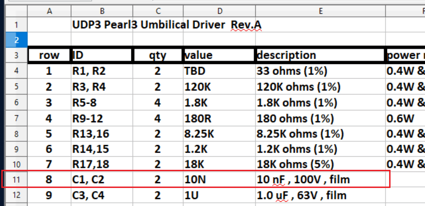

Are 63volt 10nf’s are acceptable
For UDP3 capacitors C1 and C2, you want extra safety margin because noise on the AC mains gets transferred from transformer primary to transformer secondary, and that gets directly applied to C1 and C2. So you want capacitors rated at least 100V DC and at least 63V AC. Take a look at the attachments.

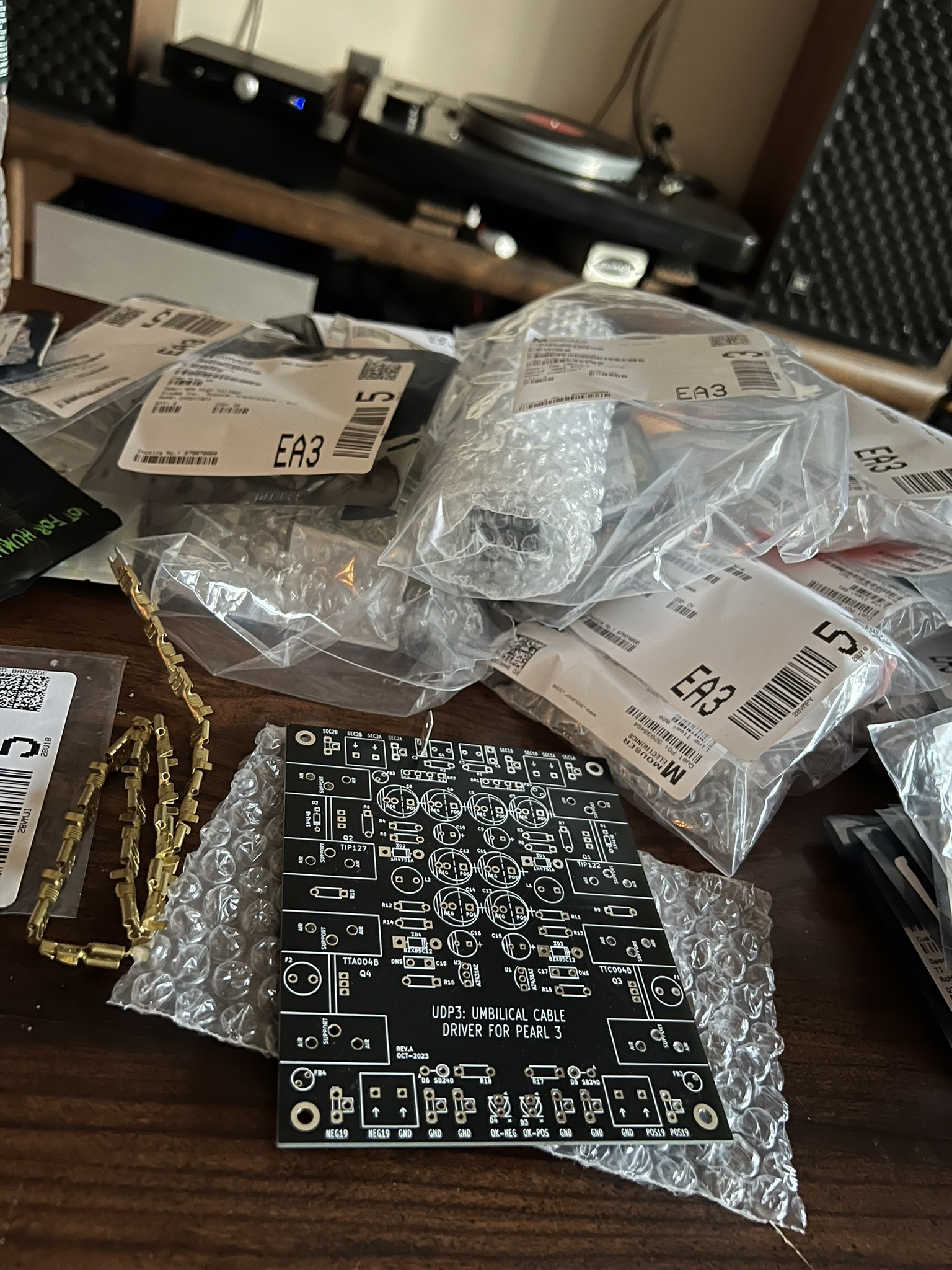

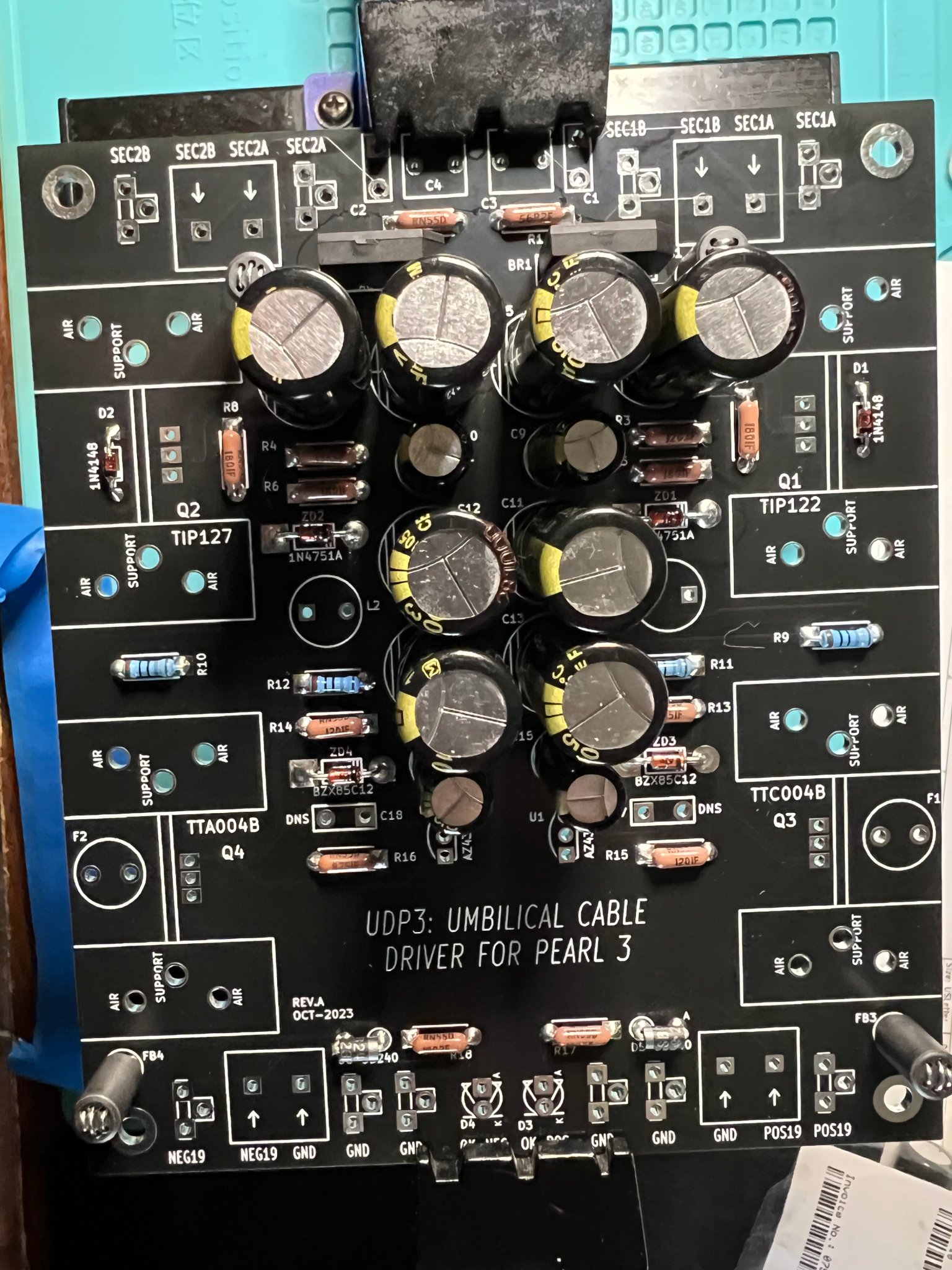

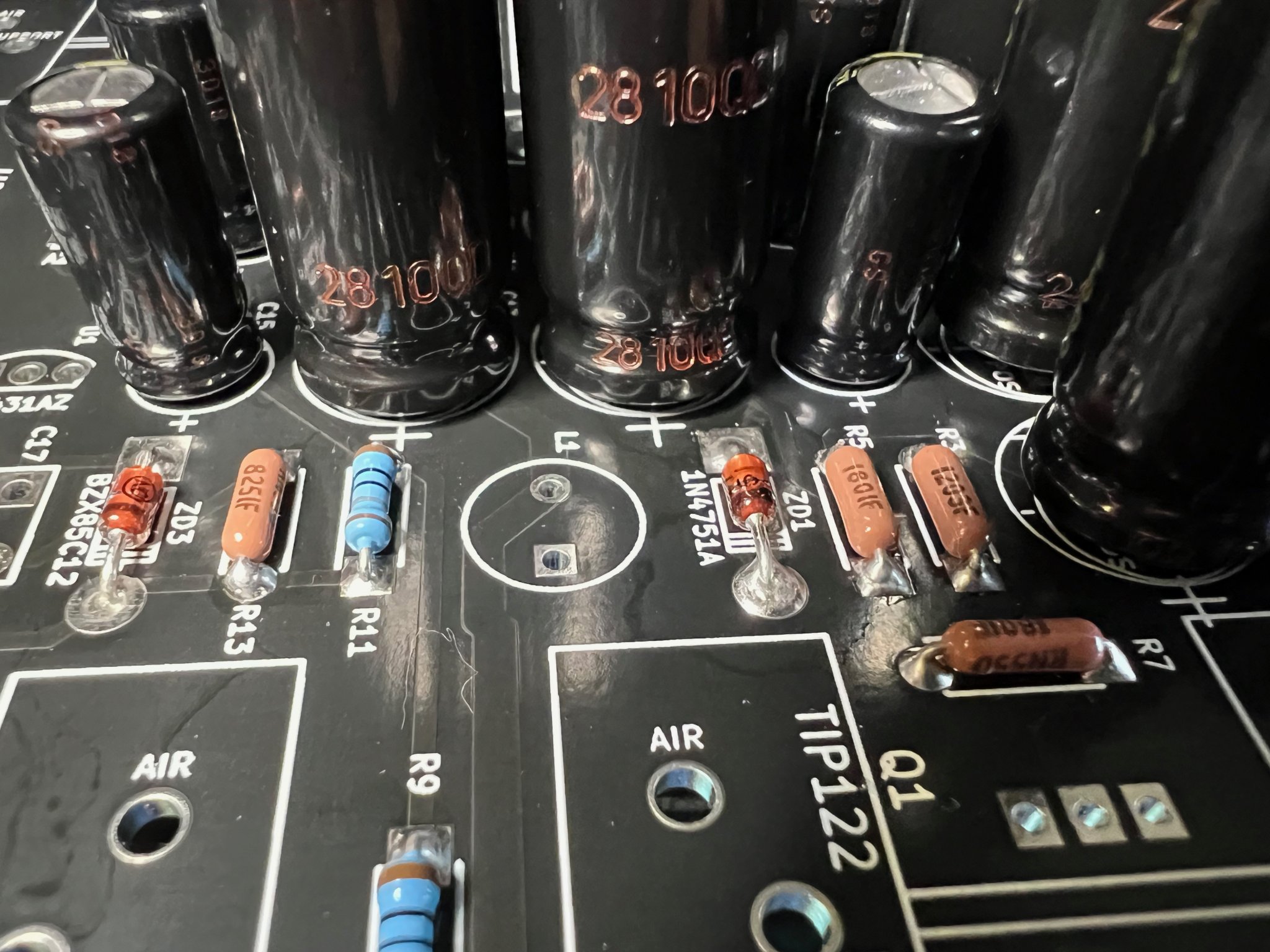

I have the UDP3 board, ready to pull the trigger on BOM at Mouser and put it in a taller chassis.
Wouldn't the Triad give +/-19V output also? Please forgive my ignorance - i can see I'm missing something basic here. Why would different transformers work with the CRCRC but not for the UDP3?

18v secondaries feed Q3 about 25vdc, 22v secondaries give a higher rectified voltage?The Q3 circuit can be considered a "clamped capacitance multiplier" because its output voltage is clamped and cannot exceed (approx!!) 19 volts, even as the input voltages rises far above 19V, thanks to U1 and ZD3.
@6L6 I see the italics.. but it's over my head the distinction you're trying to make. I'm confused why different voltage inputs from different transformers are not possible, as the clamped output is 19v regardless?
If Mark is saying the UDP3 circuit accepts only 22VAC input, OK i get it. Would it follow to just get one of the two encapsulated transformers the Quasimodo designer so kindly listed on thread with measurements as the most appropriate?

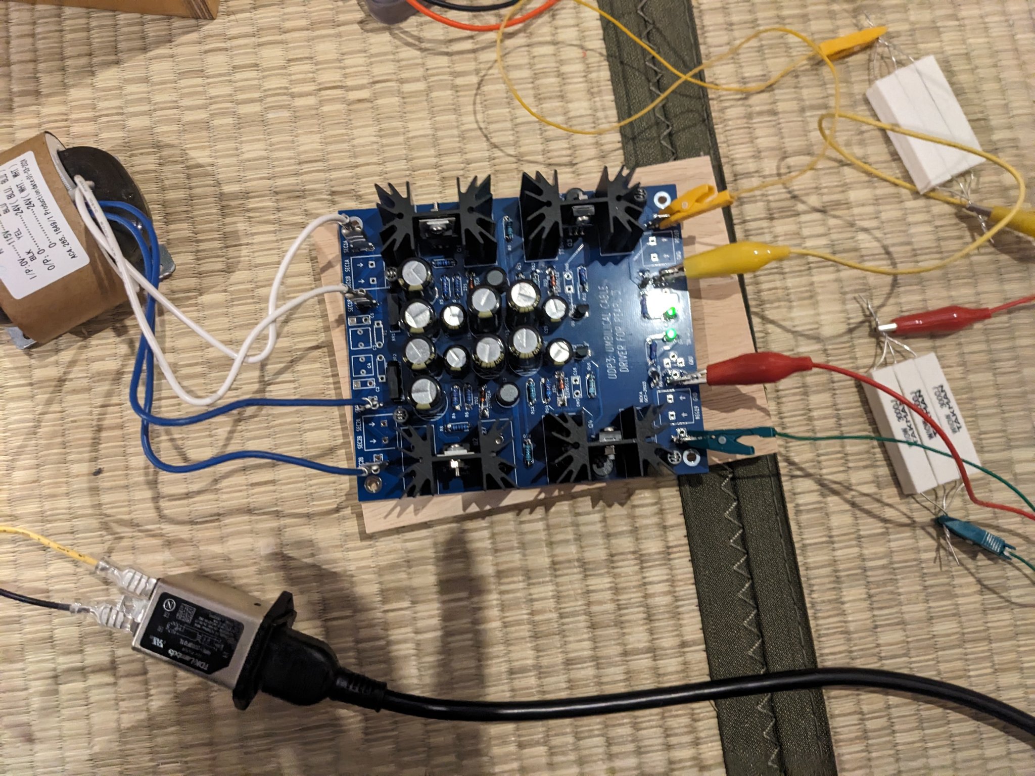

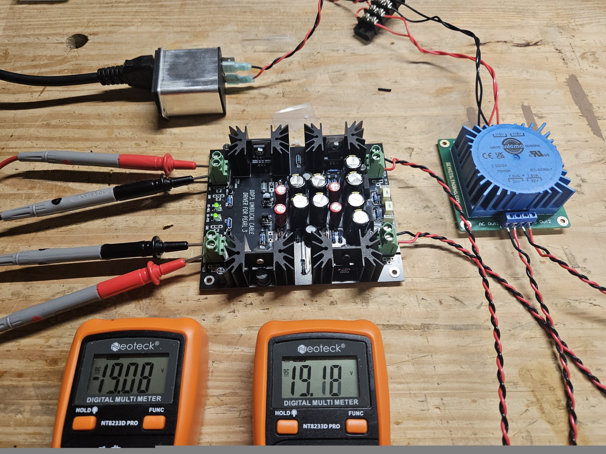

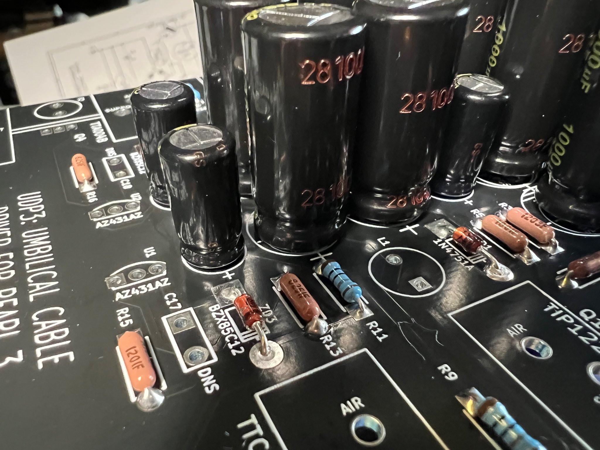

Well, it took a "few" months before I could start on this project, but the power supply is complete and as intended, I have approximately +/-19v. Continuing on with the Pearl 3...
