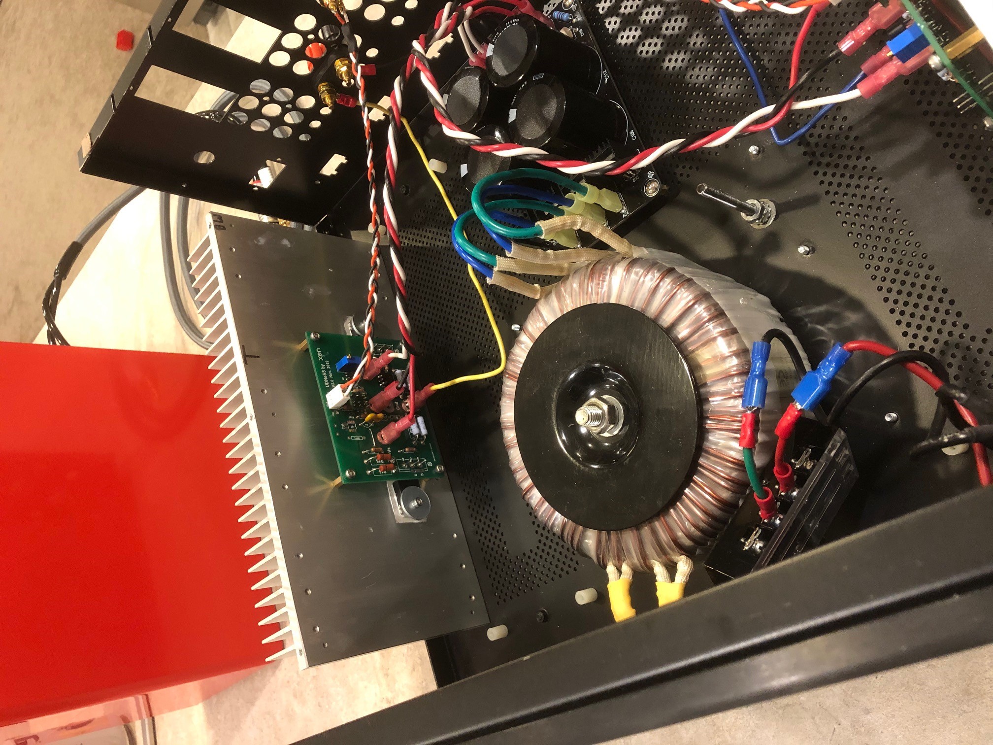

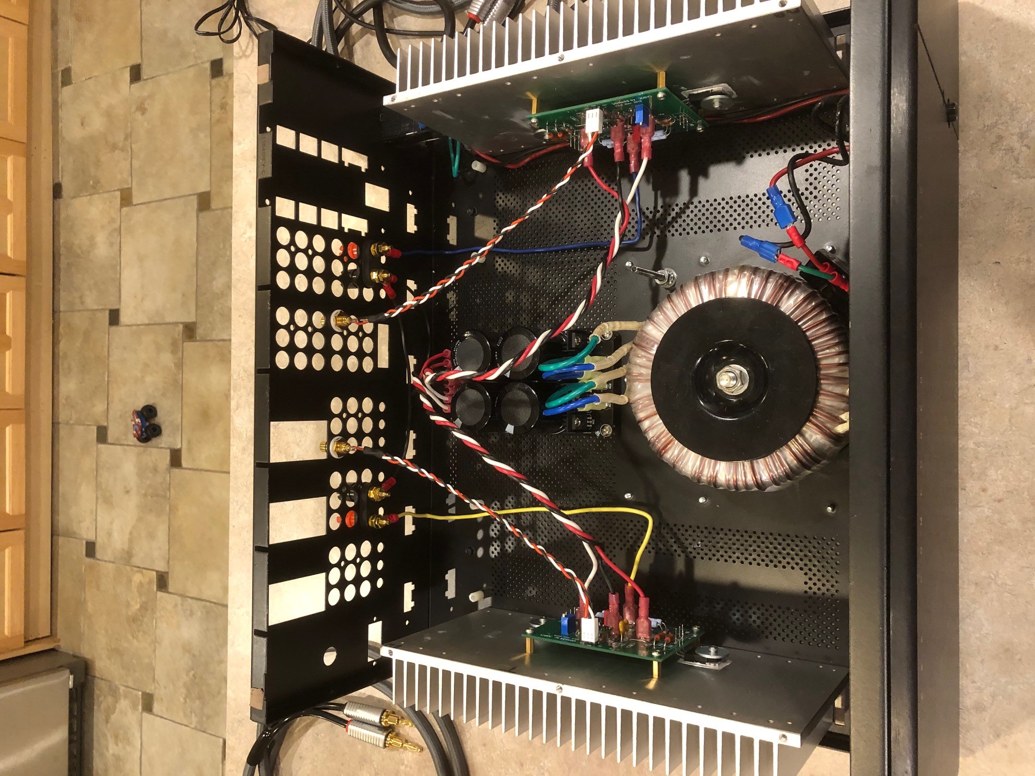

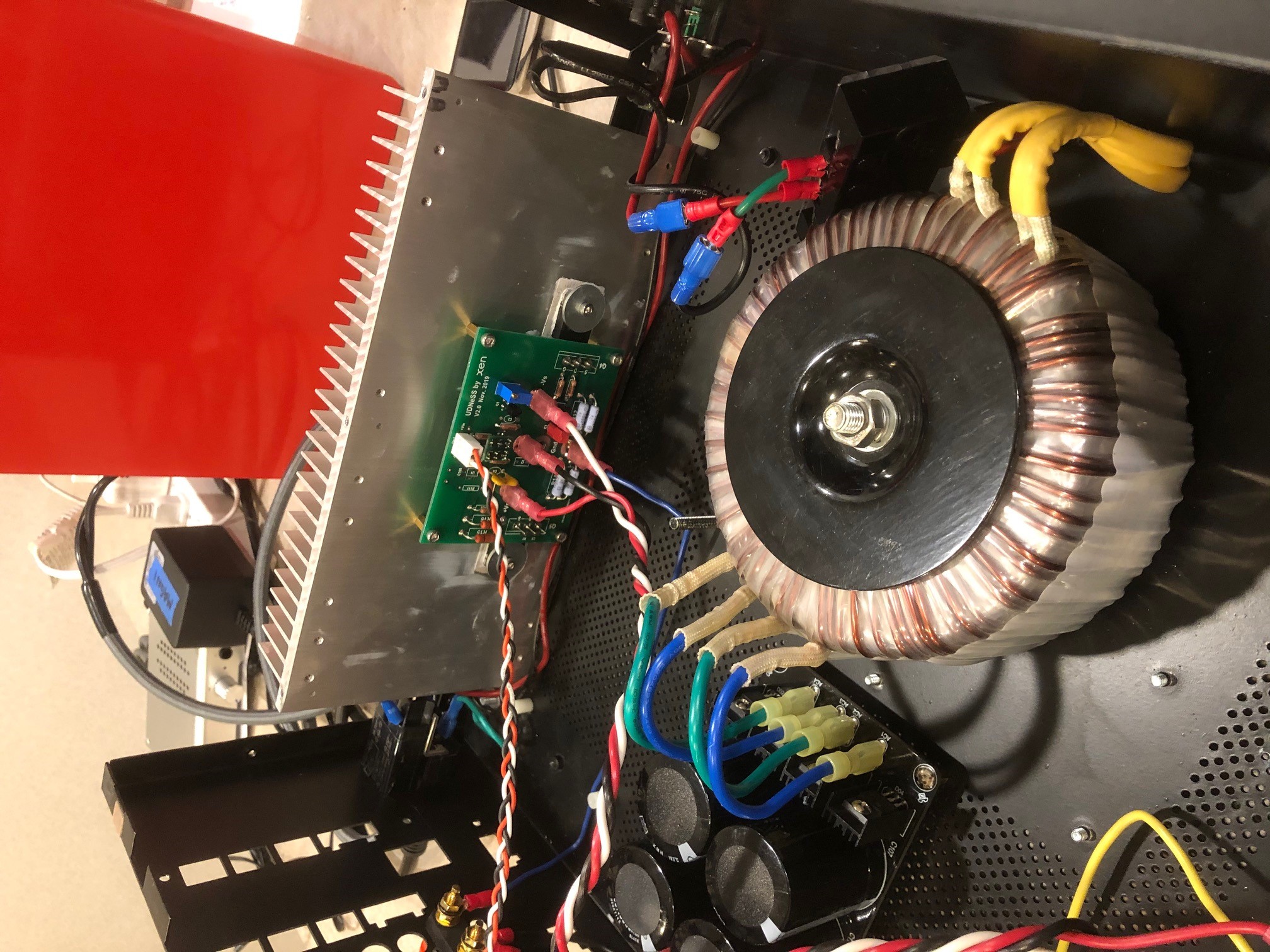

Well, here are some close to final pictures. What's in the case - 2 channels of the UDNeSS by Patrick, an AnTek 400VA 2x18V toroidal, a 50Vx40,000uF PSU (planning to upgrade) and running with RCA inputs all housed in a recycled B&K CT600.1 chassis (4U case, but heatsinks are 3U height)
I have let the amp idle for more than 2 hours with the chassis lid on - and never got over 53C (checked every 15 mins for 2 hours). I have also let it run with music at my typical listening level for over an hour 3-4 times and heat is consistent at 50-53C.
Bias is rock solid on both channels at 1.31A (ended up with 2x110r parallel for R6, or 55r to set the bias - on both channels - initially using the 2x200r for R6 they were both running high at 1.41A)
DC offset is the only odd thing - left channel starts at 0 and immediately goes to 20mV in less than 1 minute, but the right channel starts at 0 and then slowly goes to -25mV but takes ~5 mins. They both come back to 2-3mV and only fluctuate 2-3mV once warmed up (warm up takes 20-30 mins.).
Difference is the Left channel quickly comes down to 3mV, only takes 10 mins. but the right channel takes 20-30 mins to come back to ~-3mV Doesn't seem to affect anything, plays fine, no turn-on or off thump - very well behaved. Very minimal hum, which could just be the mostly temporary wiring I have in the case and not really tried any alternative grounding schemes.
Best part - it sounds so nice! As I've mentioned before, this is my first experience with a Class A amp and also my first experience with a Nelson Pass design. Very impressed and really think this amp shines with classic rock, jazz, but doesn't object to some heavy metal and Top 40 either. Wasn't sure how it was going to behave on my test speakers since they are nominally a 5-ohm load, but they have done quite well. Right now, I'm making sure I don't have any issues (DC, thermal runaway, etc.) before I hook up my higher-end DIY speakers - would hate to have an "issue" with them. Also plan to add speaker protection, but trying to figure out that, while also deciding on the PSU upgrade and do it all at the same time.
I have included some pictures - keep in mind it's 90%. Still need to figure out the additional capacitance (currently 40k uF) I have 160k uF (16-10k uF Caps) to put in the case, but I'm trying to be strategic and find the best place (and boards) to place it and the right amount (I think is 60-80k uF per channel). I am also trying to decide how to plan out the back panel, since the case is being repurposed and I think I will need to replace the back panel to use XLRs, but it sounds pretty good with RCA currently. Not sure I can stop listening long enough to completely re-work the case for XLRs - so we will see how that plays out.

a) Many congratulations. 🙂
b) It is a reversed-polarity circuit from me based on limited information published by Nelson.
So anything not OK, you should blame me.
If it sounds good, then credit to Nelson.
c) 40mV offset is nothing for a power amp. Perfectly OK even for headphones.

The amp is supposed to clip on the negative swing earlier than positive swing.
It is not a symmetrical amp.
But if the dynamic current is indeed largely coming from the lower FET, then it also contributes to this asymmetrical clipping.
But in normal listening, you should not be near clipping.
If you need lots of power, then this is not the right amp. 😉
P.
AC across R15 tells you how much AC current comes from the lower FETs.
Not sure what value of R15 you are using.
The total output current would be 4V/RLoad, or 0.5A at 8R.
If the dynamic current is shared equally, then the driver FET will be providing 0.25A.
With 0.5R for R15, the dynamic voltage will be +/-125mA.
If you want to find out whether the lower FET is providing more current, you can place a 0.1R resistor between -Vs and Q4 drain.
Use the scope in AC coupled and measured the AC voltage.
You can then recalculate the dynamic current by dividing that voltage by 0.1R.
The values provided in the schematics are based on the FQA FETs used by Morde.
You can change the current ratio by changing the ratio of R11//12 and R13//14.
Best to play with it in Spice first to get an idea.
P.
That’s a lot to take in to make an adjustment.
You don’t seem to be signaling there is an issue, so I will accept it the 0.065/0.5r=~130mA is safe and not an issue.
Very happy how the amp sounds and enjoying it. I just wanted to make sure these measurements didn’t signal a problem with my construction or lead to an imminent failure.
I have CRC PSU boards coming (China fab) and will try with double or triple the capacitance just see if there’s any audible difference.
