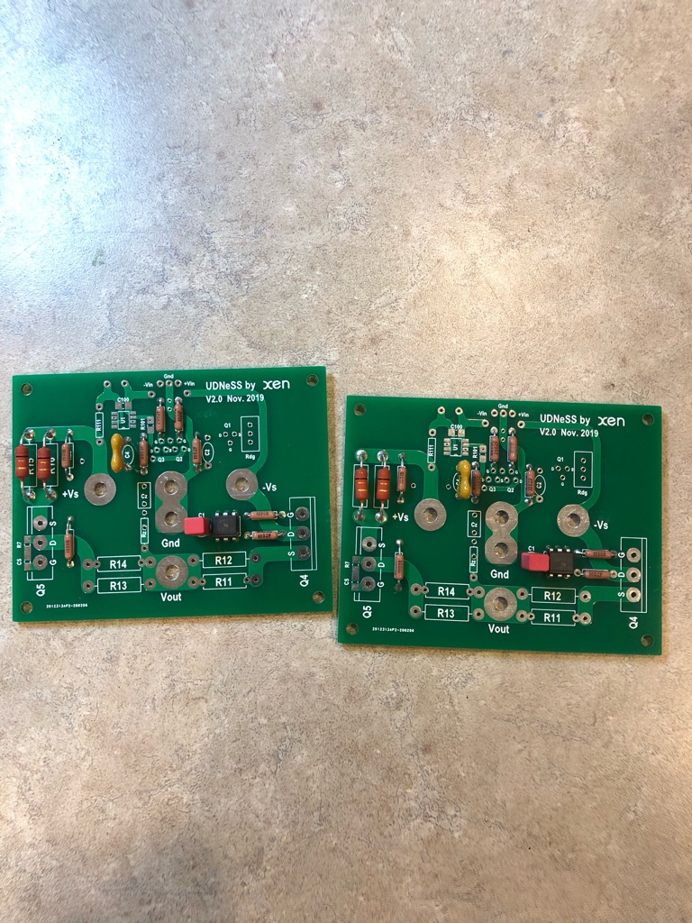

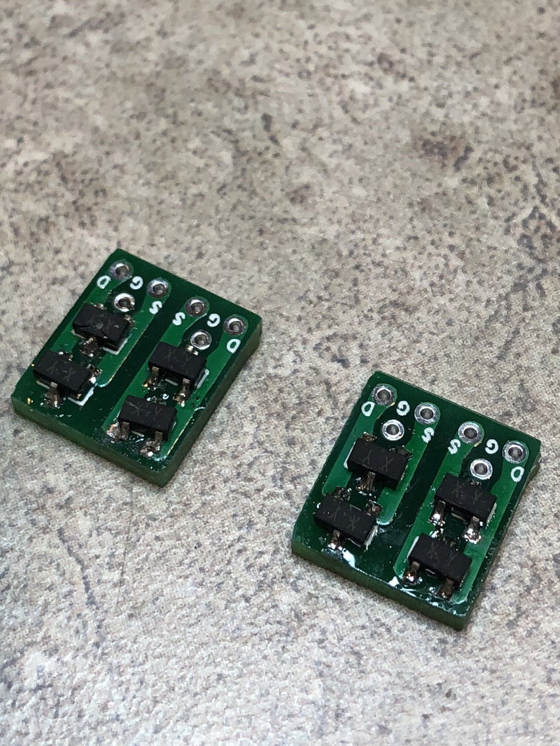

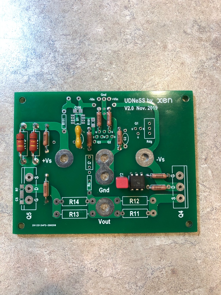

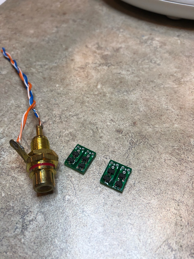

I finally got some real work done on this amp. I have spent a month learning how to match, buying all the parts for a constant current and learning to read a schematic and bread board the circuit.
First time to solder smd components, nerve wracking but I get continuity on all the solder tabs, so it should be good.
I ended up matching the 2sk209s at 1.82and 1.85mA, because they were the closest quads matching together and to the 2mA goal. We will see if I need to adjust R33 up a little.
I have verified every component prior to putting them in and matching them across the two boards to try and get them as close to matching as possible.
Still have a lot of work to do - just thought some pics might encourage someone else’s to start this project.
Great board design, solder very easy and plenty of room for every part.
Thanks for posting for the diy folks like me and for answering all my questions.

I'm definitely keeping track. Truly appreciate you posting the progress. Learning from your hard work.

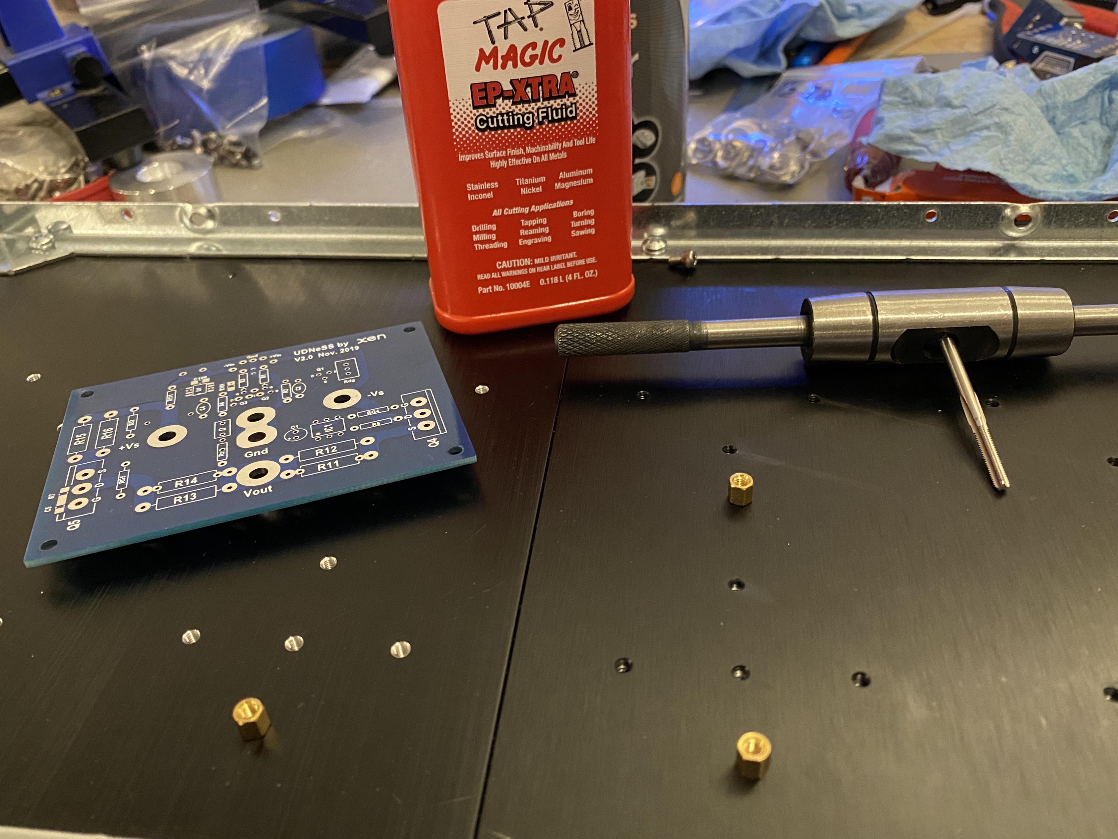

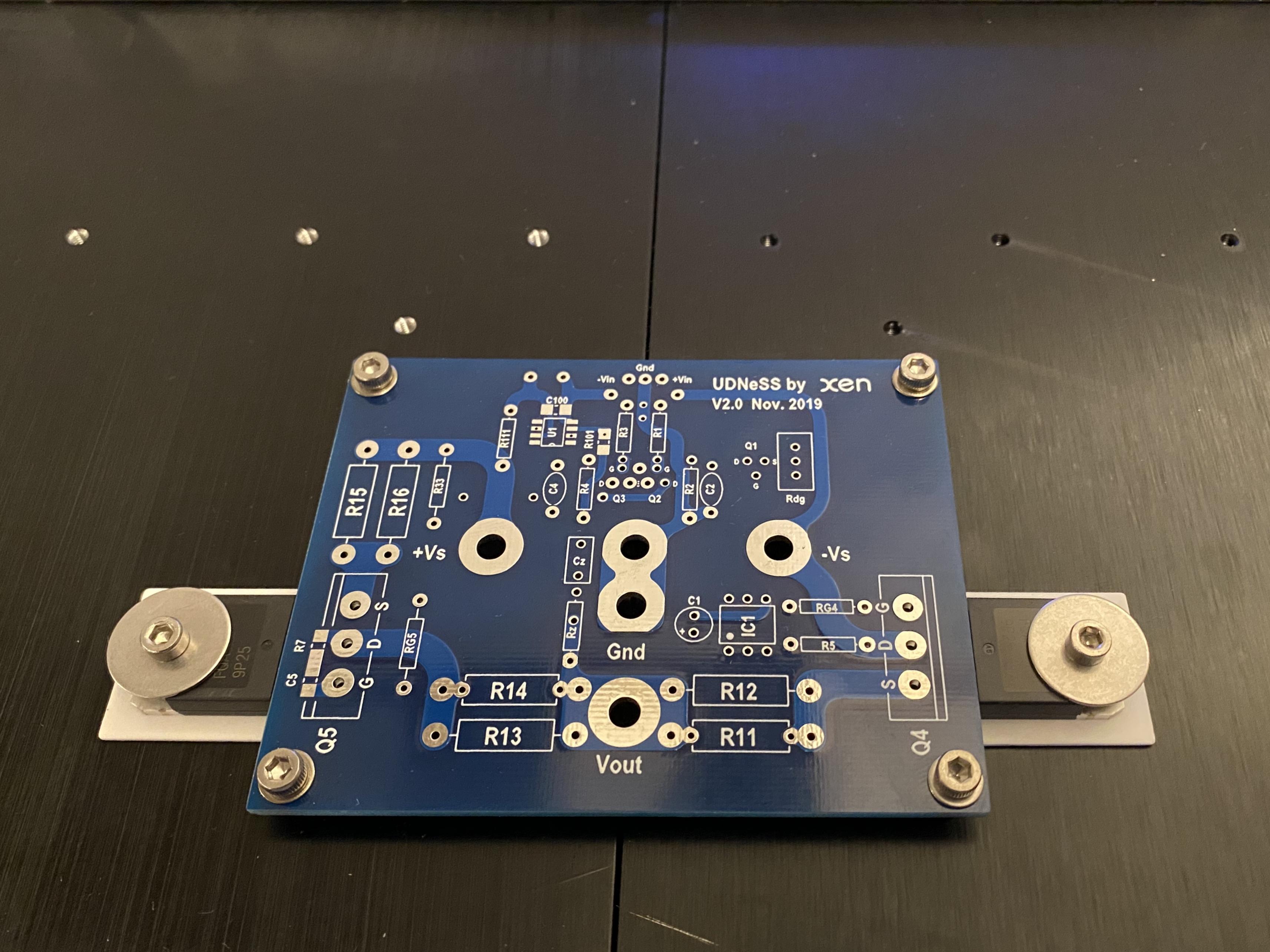

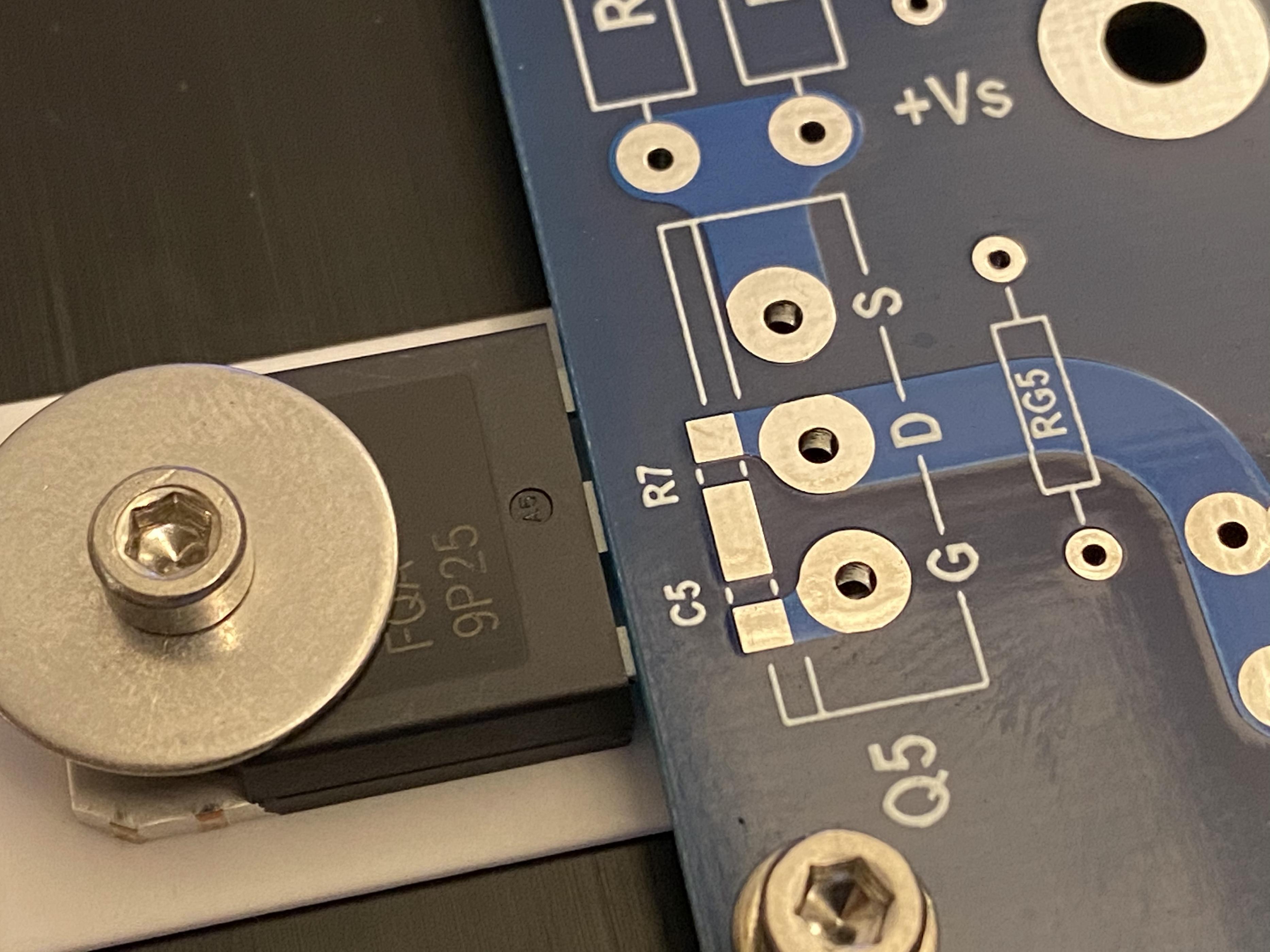

I’m also following along. I had some boards made up by JLCPCB. Thank you for the gerbers and the development and documentation on this project Patrick! Just finished tapping some extra holes for the boards in a 5U deluxe chassis from the diyA store. This was my first time tapping. It went very well. I invested in some good quality taps, used the right size drill bit for the holes, and used plenty of tapping fluid. Looking at the new holes you can’t tell them apart from the ones that came from hifi2000. 😀
The holes for the mosfets were original to the sinks and fit the required spacing perfectly.

If you leave out the power MOSFETs first during soldering, you will find that it is easier to adjust and trim the front end on its own.
Especially if you have matched the power devices and know the required Vgs for bias.
You can actually set the voltage across R33 to the correct value before putting in the MOSFETs.

And I suggest using 8mm standoffs.
6mm is absolute minimum.
You need some gap between PCB and heat sink.
Or the space in between will actually get hot.
