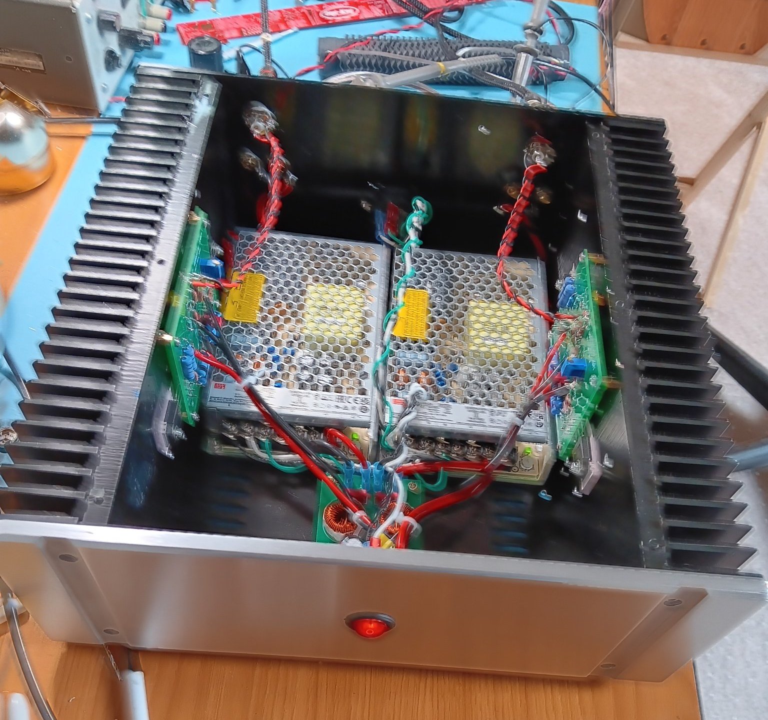

Someone just sent me a while ago picture of his newly built UDNeSS.
Nicely done.
Many Congratulations,
Patrick
Nicely done.
Patrick

The amp pictured in post #387 is mine, and the congratulations go to Patrick.
I've always been a tube guy, but a friend of mine let me borrow his Aleph 3 and I knew right away that I had to build a Class-A amp of my own before he asked for it back. I studied the various Pass designs, but the designs that interested me all involved various unobtania. The UDNess, however, seemed like a path of low resistance with available parts. Since I'm basically cheap and lazy, I chose to pursue this path. I ordered pcb's from my favored supplier, pcbway, and gathered up the parts. Fortunately, I had an unused chassis that I was able to repurpose. It took a few hours of drilling and tapping, but I'm pleased with the results. I.e you can't see my mistakes.
I chose to utilize SMPS's as I'm getting too old to hoist 60-lb amplifiers around. The design uses a pair of Meanwell LRS150-24's, one for the plus and one for the minus supplies. Although I regularly use SMPS's in audio to good effect, I didn't know how the switcher noise might affect this particular design, so I designed a pcb that combined 2 of the switcher filters, documented elsewhere on diyaudio, in a +/- fashion. To enable fast changes, I used 1/4" quick-connects wherever possible.
The amp worked correctly from the get-go. I did need to change the resistor R6 to set the current through the output transistors to about 1.22A. Offset is very low and stable after tweaking Rdg; I did not use the servo. After stabilizing, the heatsinks run right around 55 degrees C, even after I forgot to turn it off one night. And there is NO noise. Try that with tubes. There are some very slight turn-on and turn-off thumps, but they don't cause very much woofer cone movement.
Anyway, the amp is a pleasure to listen to. My thanks to Patrick for a great design.
