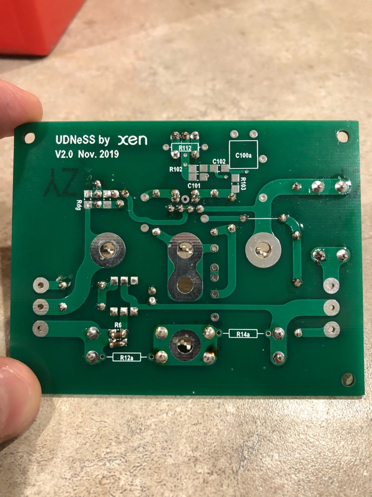

Hello all. Progress is slow but every step forward is closer to a working amp 🙂
I have a quick question which I cannot see an answer for.
Resistor 11a on the schematic does not seem to be used by anyone. It would in theory occupy the space under R11 (labelled R12a)
I just have the trimmer to install and then am ready wire it up for a test.
Thanks for any insight to R11a
..dB
Thanks Patrick.
I thought that was the case based on the table you added to the PDF. I was just surprised to see that R11a is listed in the BOM and based on the schematic it is in parallel to R11
Seems I cannot load images from my phone, will just leave it out and see if i need to trim. I used the same FETS as Morde so let's hope it all works without additional tweaking.
