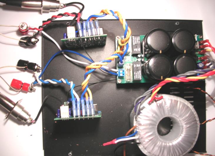

Finished my amp. Just a couple of hours, but not so much honor: all the stuff is from Hypex. 😀
Before I wire up the amp I'd like to check the connections shown in the picture attached: somebody may help?
If it is all right, then Ucd kits from Hypex are suitable for absolute beginners.

maxlorenz said:
Congratulations 🙂
Sorry, I don't know Hypex' PS.
Two questions:
1) What are those wires that go from PS PCB to speakers binding posts? Some form of protection?
2) Are you planning to put some heatsink on those T-bone blue pieces?
Good luck!
M
Congratulations mean I can risk the power up?
Hypex SupplyHG has just 6 wires going out. I tested it and is ok: +46 (yellow) -46 (orange) and grounds (blue).
The wires from speakers binding posts are a DC protection for speakers (the circuit is in the PS).
The two Ucd are going to be set vertically and the blue T screwed to the chassis.
Many thanks
Thomas
Well...errrr...If you followed Hypex's instructions and there's no obvious short-circuits 😀
*Try to fix those BP's as accidental contact can happend.
*Do you have a variac on hand?
*Maybe you can try it with a 100W light bulb in series with Power cord to reduce VAC and do the checking 😉 .
*Can you power-on/power off fast enough? 😉 .
*Measure DC offset at speakers BP's with and without signal.
*Do not attach speakers until sure of safety.
*Use cheap speakers first no matter DC blocking capacity.
*Don't do anything if you're tired or sleepy!

Re: Ucd 180 SupplyHG
Small tip;
Remove the black protection material on bottom of the UcD180. This is for ESD and mechanical protection of the board. It will possible damage the UcD180 if you switch it ON without removing this!
Jan-Peter
Re: Re: Ucd 180 SupplyHG
Jan-Peter said:
Small tip;
Jan-Peter
Thanks for the tip. Of course I should have tested the amps with these 😱. If this is your blessing, I'm going to power up the amps today.

UCD 180 and SupplyHG from Hypex: success!
Powered up the two Ucd 180, SupplyHg and transformer from Hypex. Success at first attempt 😀.
Total time needed for an absolute beginner (like me) is three hours. Though I've spent the most of the time soldering two couples of signal cables: unbalanced to balanced for the test from a CD player and balanced to balanced to connect the amp to my DAC later.
The question now is: if me, diy beginner, have already built the best amp, what I'm going to do now? 😡
