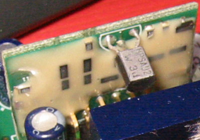

Hil Folks!
I've an old version of the UcD180 modules. Does someone know what is the new transistor use on the socketed card. Mine doesn't have this.
Is the DC Offset pot coming to the UcD180?
I don't know what this transistor does.
I have a related question. On the modulator daughterboard for my UcD400s (made in April) I have the new DC offset potentiometers.
The UcD180s I received in the same shipment were made in February and do not have the DC offset pot. It would be nice to know if and when they will become available on the UcD180. If the daughterboard is really on sockets then can we buy a new modulator board if the DC offset becomes a problem?
I have heard that DC offset problems can occur after shorting the on-board input caps with the AD opamps even when using external input caps.
Guy
To answer my own question:
Hypex product support told me that there is no current plan or date to get the DC offset pots on the UcD180. I think they want to keep the cost of the entry level module down.
They don't sell the modulator daughterboards separately (I guess we already knew that).
Guy
