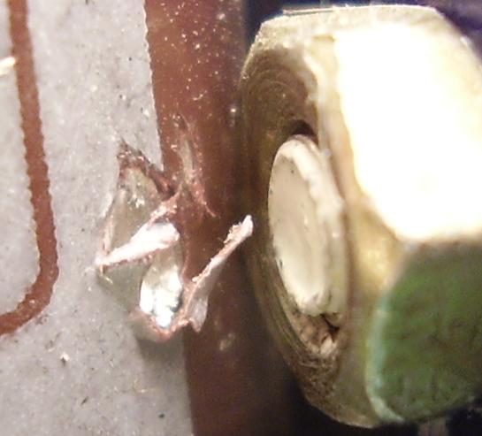

I enlarged the holes in the heatsinks of my UCDs with a drill, so screws could fit in, and... just one slip and the drill touched one of the caps... I'm attaching a (close-up) pic with the damage. Do you think it's safe to use them like this?

It looks like you just scratched some of the plastic sleeving off, as long as the actual metal cap body does not short out on anything it should be fine.
I skin all electrolytic caps (where suitable) anyway🙂

Well... not quite. The metal is not just scratched, there's a conic hole about half a millimeter of depth. It's hard to tell from the pic, because of the angle (the T-shaped sink wouldn't allow me other angle), and because of the lighting.

Sorry to hear that, if the can is pierced then I would think they will need changing I'm afraid🙁
You'd have to check first to be sure but would it be possible to either stick a bit of super glue or something to make the cap air tight? if its only a small hole it may be possible to cover it😀

No, no, no... it's not pierced (that you can see from the picture) 🙂
Maybe the term "hole", isn't appropriate, maybe "dip" or "pit" is the word. It's not pierced, but it's about 0.5 mm in depth (I didn't realize until now that the cans are so thick). Anyway, I'll power it up and see... let's hope it doesn't explode.
