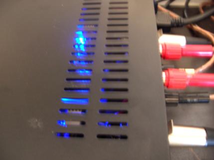

My UcD180 boxed
Here is my amp....
To encourage beginners to try Ucd, here is the complete bill of materials, including chassis and screws 😉
The materials are divided in three "shops": Chassis, Hypex and the electronic shop near home. All material is anyway avalaible to www.audiokit.it, including Hypex stuff.
Something to add?
Thomas
