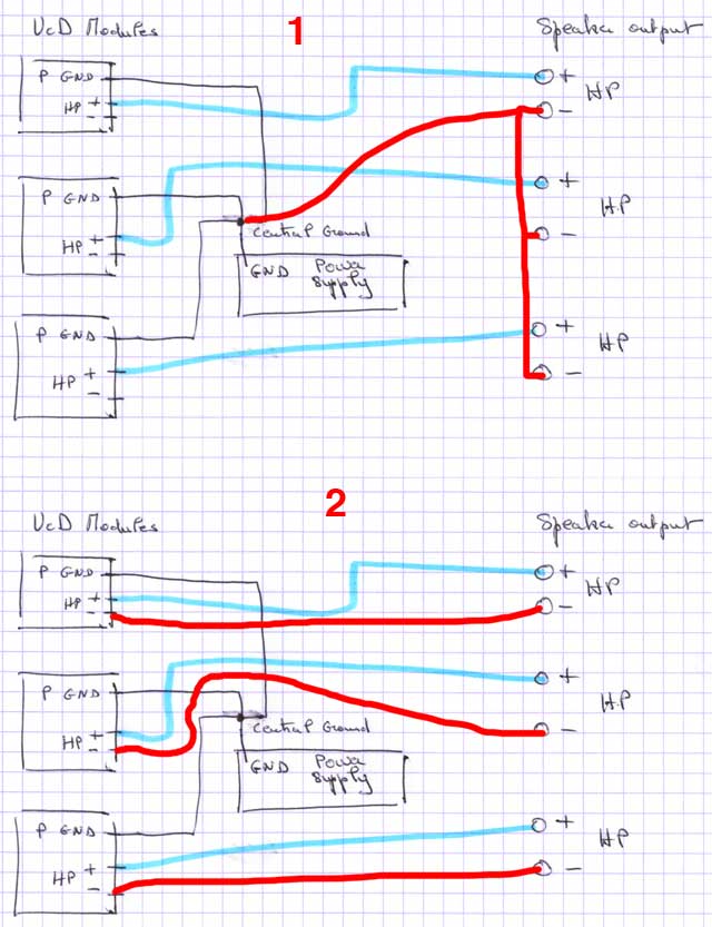

A nice question concerning ground management when using 2 or more UcD modules. In my case, UcD180.
I've made a sample drawing showing 2 kinds of solutions to connect power supply GND and speaker GND. Power supply GND is connected using a start topology as usual. But for speakers we can imagine 2 differents solutions.
To simplify, I show only one power supply but in fact, I've 3 power supply for 5 modules in my formal project.
As I'm building a 5 channels amps, solution ONE is interesting because that's one use less wiring but does this will work with UcD modules?
See the the enclosed picture here.
Stephane

Don't do 1.
UcD feedback is optimal when the - terminals of the speaker outputs are not connected to a common ground. Using common ground will affect quality!
This has come up at the UcD400 thread also, but for another reason - a DC protection that took all speaker grounds together.
Don't go cheap on a few inches of speaker cable when running these wonderful modules!
