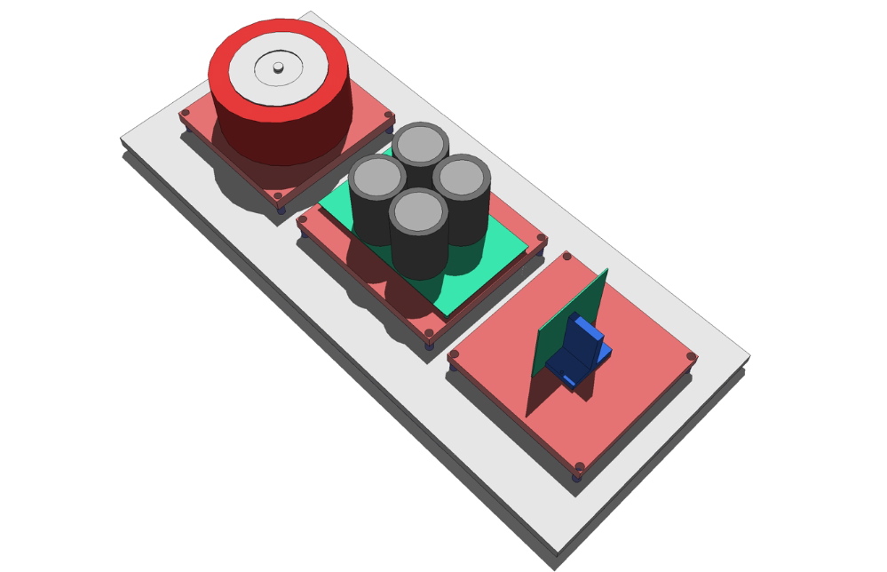

Do you think it is overkill to use one high grade power supply only per ucd180 module?
I plan to build four monoblocks, each main component sitting on copper plates, resting on compression springs for vibration isolation. When I suspended the modules only of my current 4 channel ucd180 amp, the sound opened up in ways almost too good to be true.

If you go this far, then why don`t you use UcD400 modules? They are supposed to be a bit better.
Gertjan
Hi Gertjan,
How much better? If ucd400 is substancially better than ucd180, then you have a point. I think Jan-Peter stated that the sonics are the same between modules though. I don't need the extra power as my active 2way WLM Aura speakers have a sensitivity of 98 dB. Also I hear that Hypex is planning an audiophile ucd module... Perhaps someone could elaborate on this rumour?
