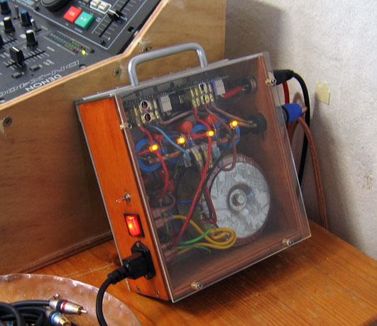

UCD180 hiss
Hi folks,
ive had a UCD-180 amp running happily for some time now, and one thing ive always noticed is that even with no inputs, the amp is far from quiet.
theres a 'hiss' that is always present. not terrible, and ive been lving with it happily for a long time, but ive finally got around to wondering if there is anything I can do about it, or whether it is just how the modules are.
when a source is connected, its a balanced line connection from a denon mixer, but the hiss is present regardless of what is plugged in.
any ideas?
cheers,
ben
ps: heres a pic of the amp. wiring is messy, but it was finished in a hurry. has worked flawlessly as a portable amp.

Re: UCD180 hiss
If you leave the inputs open, hiss is quite normal because the noise voltage of the 100k input resistors will be amplified. You get approximately 180uV worth of noise with the inputs open. On the other hand, I don't know how quiet your source is. Could you try shorting the input and report back on your findings?anomalous said:theres a 'hiss' that is always present. not terrible, and ive been lving with it happily for a long time, but ive finally got around to wondering if there is anything I can do about it, or whether it is just how the modules are.

Re: UCD180 hiss
anomalous said:Hi folks,
any ideas?
cheers,
My UcD180s are the earliest version having the 10k input resistance I believe. With shorted inputs they are dead silent, just amazing, far more silent than my tripath (big difference) and far more silent than ZAPpulse (2.2SE). In fact, in my case, the preamp determines the noise level, with shut-off preamp, no noise at all, really have to put my ears in the tweeters in a very silent room to be able to hear something.
Are you using very high efficient speakers (like horn tweeters?), no problem with other amps? I think they are among the most silent amps on this planet. So maybe, try shorting the inputs as Bruno suggested and see what you get.

UCD 180 silence
time to own up to being a silly boy.
It was the mixer. I thought i'd tried unplugging it, but clearly i hadnt. ive used this mixer with other amps and never noticed the hiss, but then the speakers im using in combination are extremely sensitive.
sorry for wasting your time folks. 🙂
