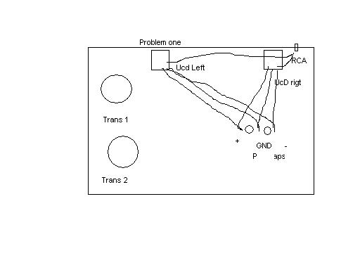

A Question to BRUNO.
Yesterday I work with a couple of UcD180 (8620 version) to solve some noise problem.
What has been detected.
When I switch on one module (Right channel) everithing with noise is Ok.
But when I startin' to ON the second one (left) some minor 50 Hz noise apeared in BOTH channels.
If reconnect right cable to the left unit and so on, everything is similar. When startin first (silent) modul everything is OK and when the other is ON noise apeared in both channels.
In any configuration the left UcD produce minor 50 Hz noise when starting them ON.
So whats can be wrong out there?
Sounds like a grounding problem. Can you post a detailed electrical diagram of how you connected everything?Alex_J said:A Question to BRUNO.

I Just put modules in my old amp for immediate check.
1.+/- and power ground connected directly to the PCU caps by wires appr 10-15 cm length for both units
2.signal In connected to the original RCA input jack via twisted pair cable
(inverted In wire grounded at RCA gnd pin)
3.turn on wire grounded for both units at one point near the RCA ground
4. T-shape radiators possibly not grounded, only bolted to the back plate of the amp. I am not check the ground at this points so I'm not sure on it.
