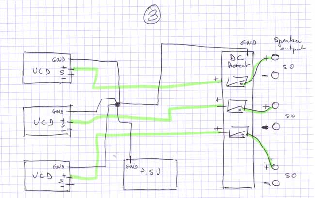

Yves Smolders said:Don't do 1.
UcD feedback is optimal when the - terminals of the speaker outputs are not connected to a common ground. Using common ground will affect quality!
This has come up at the UcD400 thread also, but for another reason - a DC protection that took all speaker grounds together.
Don't go cheap on a few inches of speaker cable when running these wonderful modules!
You're right and in fact my problem is here. What should I do when using a CC protection circuit (with common ground for the five channels)?
Stephane
In my drawing, speaker ground are not connected yet.

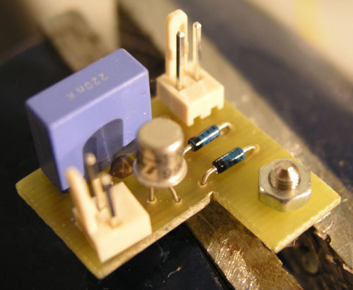

silent-off problem
I'm having problem with the small circuit for silent turn off.
I'm using the below circuit with few changes 1N4148 diode and 2N2222 bjt . In a board ,it is travelling to Hypex, I had intermitting signal output , then once turned off and then on it went completly silent with 9,7Vdc at the output and no signal . I completly semiconductors in the silent circuit seem to be ok and circuit cecked several times.
What could be the problem?
Giorgio
Giorgio

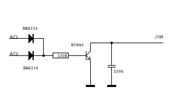

stef1777 said:The JP's mute circuit.
And the PCB is here: http://audio.cyberkata.org/UcD180/UCD_PSU.pdf
T1 = 2N2222A
R1 = 100K
C1 = 220 nF
Ok this is the circuit
Giorgio
the circuit is in the same board with the diode rectifier, ground circuit is connected to central transformer wire and than to chassis.
Giorgio
Giorgio
Done it, 8R power resistor as load and no signal at the output except 9,7Vdc regardless of the 33k resistor betwen -V and output I added to avoid the Vdc at the output with no load.

Dear Stef1777,
Using the circuit from Jan-Peter but using 2N222A instead of BC846, I got 7mV with AC and 65mV with no AC input. Is these value good enough?
