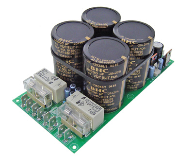

ps dimensions
What are the Hypex HG Power Supply dimensions?
