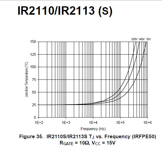

does ir2110/2113 can drive 4 irf4227
1.Yes they have the same layout , the 74AC... serial is prefered , it's faster.
2. It depends on the working frequency of the amp , if above 250-300kHz - only one! If you try to drive more , the ir2110 will just simply overheat.
Look at the curve (it's from datasheet of the 2110)
It's not for 4227 , but find some approximately matching.
