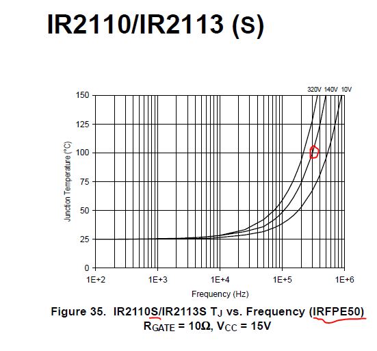

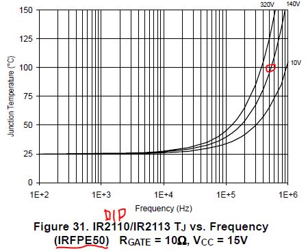

Hi Manoj
Yes it can , but it'll overheat
The DIP package can dissipate more power that the SOIC one
IR2110 can drive 2nos of IRFP250N(Qg=140) 3nos of IRFP240 & IRFP4227 (Qg=70 minimum)
I already posted the graphs from 2110 datasheet
Maybe you missed them?
They are for a IRFPE50 with it' 150 nC total gate charge at 15V at gate.
How you can see the SOIC can heats up to 100 degrees at 300KHz , i think it's too much IMHO🙂
Yes , it can sustain more (up to 150Deg) but it's too critical.

I use IRS2110S (soic) with IRFB4115 (similar to 4227 dinamic parameters) for subwoofer amps at freq. around 200-250 kHz and have the temperature of the IC about 75-80 degrees.
