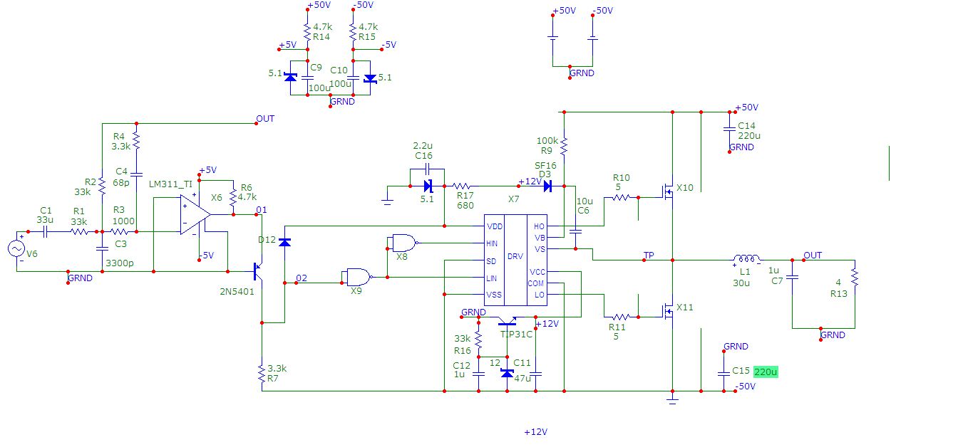

Huge distances between mosfets and driver .🙁 .Also ir2110 can not drive more than one pair,for more you need tc4420 to help.Put mosfets close together.
Also you have no decoupling,to much copper for whitching bus=>huge emi.Resistor sensing for short only in neg supply is not a good ideea,it may not save amplifier with short to rails when upper mosfet is on.
I posted a pop free start and stop level shifter modification a while ago..use it..😀..speaker conection delay is needed anyway because the amplifier will not always start to oscillate with load.Also 1 kohm dummy load and 10kohm startup resistors are needed.

For 2 ohm and 1 ohm load you also need to modify output inductor and capacitor,also you need 50 A rated power transistors .

Also manojtm you have a huge ground loop around the entire board..do not make it like this ..it is not very good...

So you want to say I'd get clipping on the below schem ?
GAIN=1 , supply +-5V , input = 40V rms
And NO clipping!
Yes you are right,my mistake...🙂i was thinking at something else😀..in this configuration there will be only power stage clipping at 40 volt rms sinusoidal....
