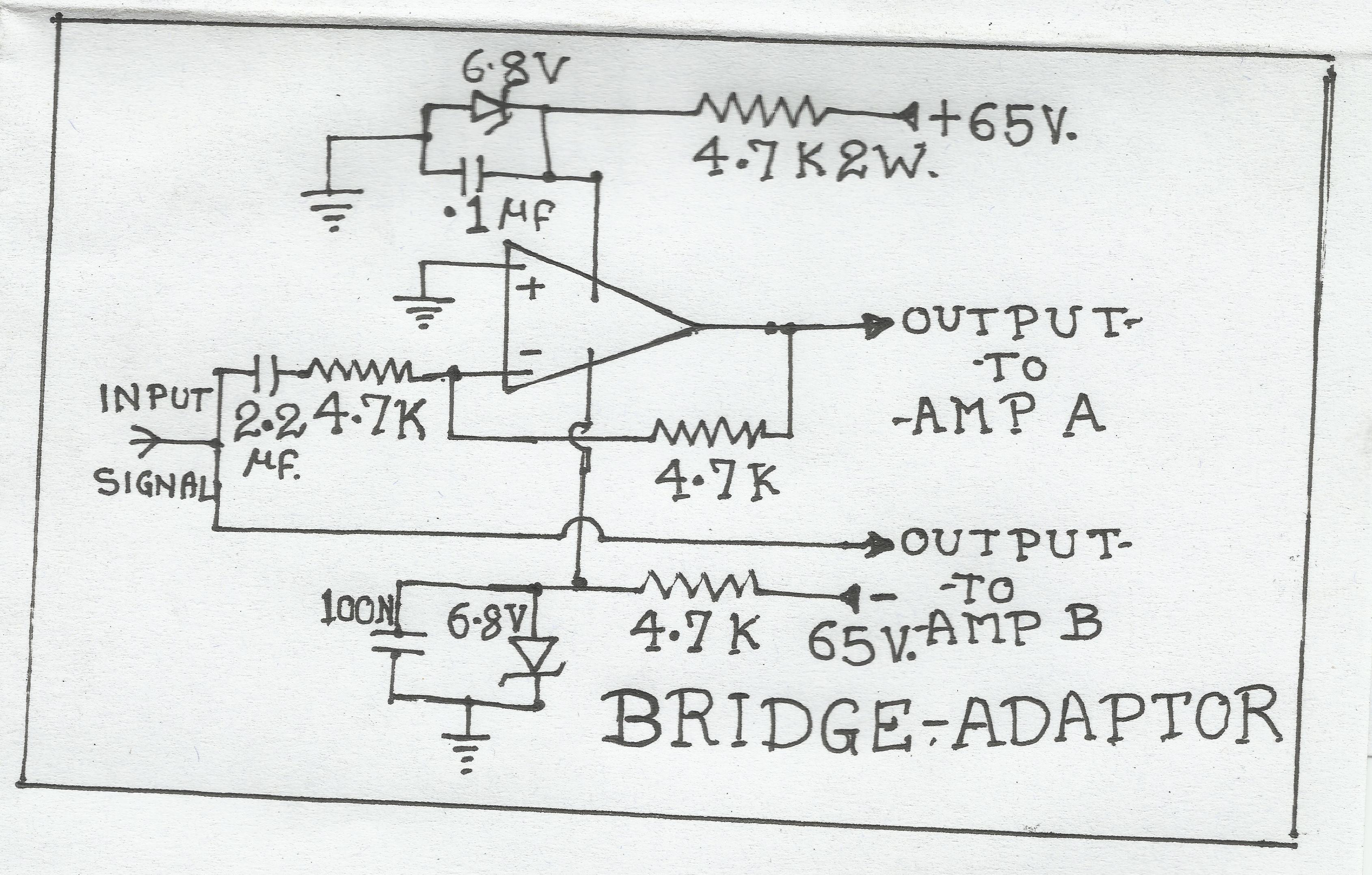

greetings is this simple bridge schematic ok to bridge ucd 1200 for 8 ohms load ic TLO71 zeners 6.8volts 1 watt

You can even use ultra low noise opamps if you find you ucd noisy,decrease lm311 gain to 5x and increase its supply rails to +-15v and use this modified circuit to obtain total gain 25x with global noise much better than with standard lm311 with gain of 25.
ok, i`ve some issue when up the gain of the op-amp, it will distort the input signal if the gain is too much even at low volume, so i think need to find out the maximum gain can be accepted for each amp, 25x gain lol its too much i think, but i like ultra low noise.
regards.
Yes gain 10 is good..but snr is better with gain decrease if you use a ultra low noise op amp befere ...
If you decrease gain you have to increase lm311 supplies to avoid clipping..for gain 10 and +-12 volt suplies you can have maximum 60 volt rms output,for gain 5 you can have maximum 30 and so on...for gain 5 and +-6 volt you can have maximim 15..etc
I see , clipping occures on the input , not at the output 🙂
I'm using the inverting kind of input , hence i'll dont get any clipping even at low supply.😉
