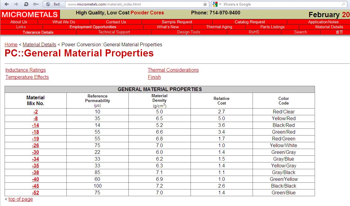

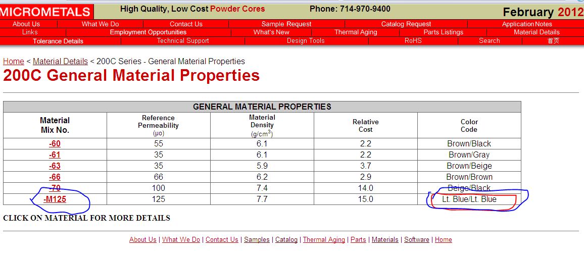

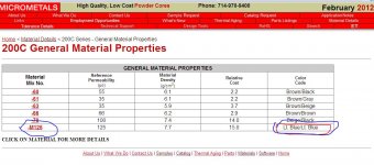

Can't find nor 17 , nor 28 mix , the only blue is "-M125 Material: This 125 permeability moly-permalloy powder material will have the lowest core losses for frequencies of 200 kHz or less. Similar to the -70 Material, physically small sizes will be most competitively priced."
17 Mix (Blue/Yellow).
Also the red i have is red/gray in fact....there are lots of variations..😀
Black/red in fact🙂 a good material Mix № 14
And a lots of variations ..... make be fake.
here is the like of the core we use
HF-157060-2 Arnold Powder Core
Expensive !
I paid around 90p for the Amidon t106-2.
Expensive !
Here's your T106-2 T106-2 Micrometals Iron Powder Toroid
And a good guide from Arnold/micrometals - http://www.arnoldmagnetics.com/WorkArea/DownloadAsset.aspx?id=4441

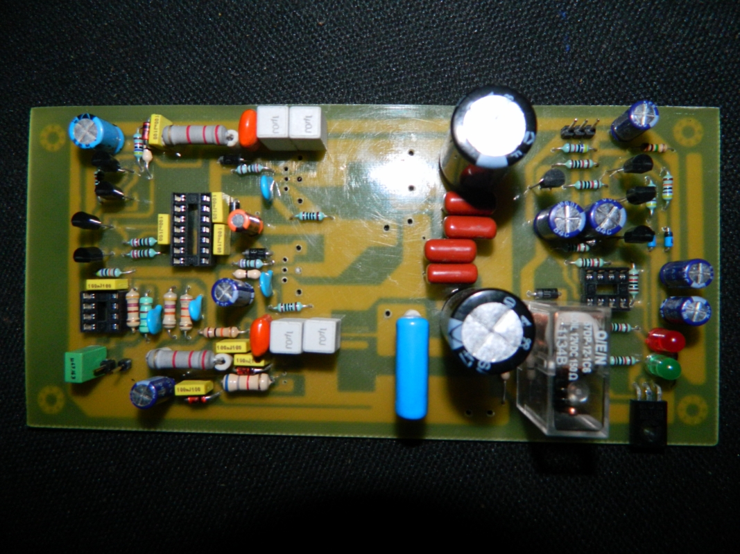

Hi Sameerx1
nice pcb good to have dc protector pcb has holes for IRF250 and
IRFB4227PBF

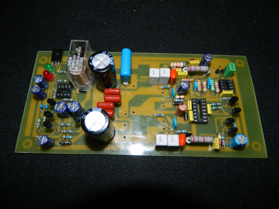

Hi Sameerx1
IRFB4227PBF

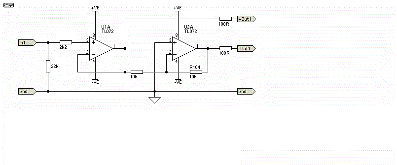

For Andrewlebon
you can use any two amps for bridge with this! Amps must be the same as much as possible.
I use this schematic for this ucd amp. On out+ goes in of first amp and on that amp you conect + of speaker. On out- goes in of second amp and on that amp you conect - of speaker.
And that is all about full bridge. With this amplifeir this is very good schematic because in inputs of both amps you have op amps who is low impedance soruce of signal, that means you can use 4.7nF cap from input to gnd and you have low noise and full audio range. Before input (in1) on bridge adapter, I recomanded you 4.7K lin pot for volume!
All is power with +-15V

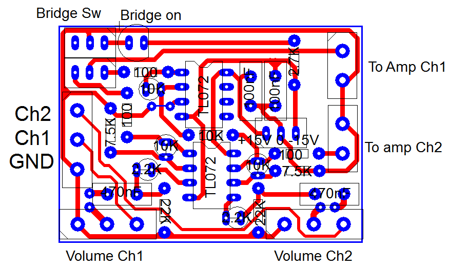

If you build classic amp with two chanel, you can use my "Volume panel".
With this panel you have volume control for both chanel and easy can swich all amp in full bridge mod with bridge swich. When bridge is on, Led is turned on..
All is powered with +-15V and when is whole amp in bridge mod, then you use Ch2 pot for volume control

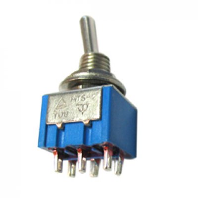

6 pins double swich that I use for this. It's no metter side of conection, only is metter conection of swich PARALEL to pins on pcb (like the swich is on top of pcb, if you understand me).
Now you'll know when is bridge mod turned on because led will turned on too.
