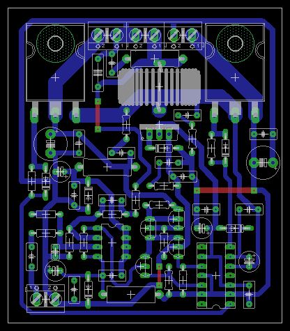

Ok i'm gonna build with my own design..
I'm not a good PCB designer.. anyway it is worth to try building this amp as it is so simple.. and thanks for the idea dear Luka.. if the schematic is fine then I can check out with different layouts..
I'll keep the space for any pro designers to make it while i'm trying my own..

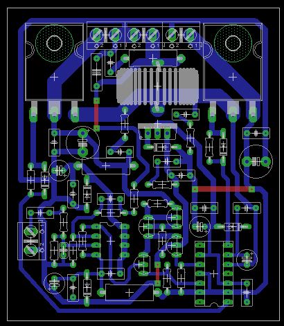

I'm still designing my own pcb.. more to think at the output stage.. (just ignore the component values there.. i need to rename them in the end)
regards.

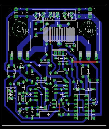

hows the design..
I'm not a professional PCB designer.. but I can handle myself to build to make it work I guess.. I still need to tweak this board.. you are free to give suggestions..

if I can give you a little advice.
shifts up the two mosfet and moves the pair of capacitors to below so that they can be welded directly to drain / source of the MOSFET (to VCC).
Then, the track com driver is too long and thin (this is a high inductance) Vs. source of mosfet
or shorten the approaching driver, or do the greatest thickness.
