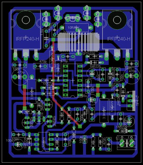

🙂...You ruote component but...a small problem
not solve.
If you confirm connections without mistake, at weekend I develop
this pcb and put on thread.

I've corrected a little error i found and added a resistor i forgot, i also put a smd solder blob jumper on the feedback so its easy to test out to which pin it should go to on the comparator:
I also removed two of the resistors on the input so that either input can be signal or ground. Now also added another jumper for pre/post filter feedback.
I think about spending the 10 euros on the materials needed to make this board at home.
If you want to have a go, i could email the files.

I think the PCB misses the diodes from the gates of the mosfets.
please check this ...

I flushed the pre filter feedback, heres a completely new board:
which device is SJ1 and SJ2
hi tekko pls show one done using single cicuit board like lycanl's circuit or pls e mail me . it's difficult to find double circit boards where i am stewin stevekamala@yahoo.com
I would not reccommend single sided boards for class d.
If you cant find double sided copper clad where you live, you might wanna consider letting a boardhouse make the boards.
Two good ones are PCB Cart and Olimex.

Finally I got to work !
Its really powerful ! This is my first Class D amp.. even running it without a heat sink and there's no distortion in my PCB.. super efficient.. +/-25 dual supply .. I'm gonna increase the voltage step by step.. will let you know the result.
DO not follow My PCB.. caz It has a couple of errors.. This amp works fine without a dual layer board.. I'll send pictures of my dam amp.. Its like a garbage ..LOL still works fine.. I'll be finishing errors on my board and rebuild the amp..
I would say, dont worry people who wants to try this.. !! 😀 Its a fully working amp ! and the simplest class D amp ever I saw .. I'm really really happy .. may thanks for the designer !
