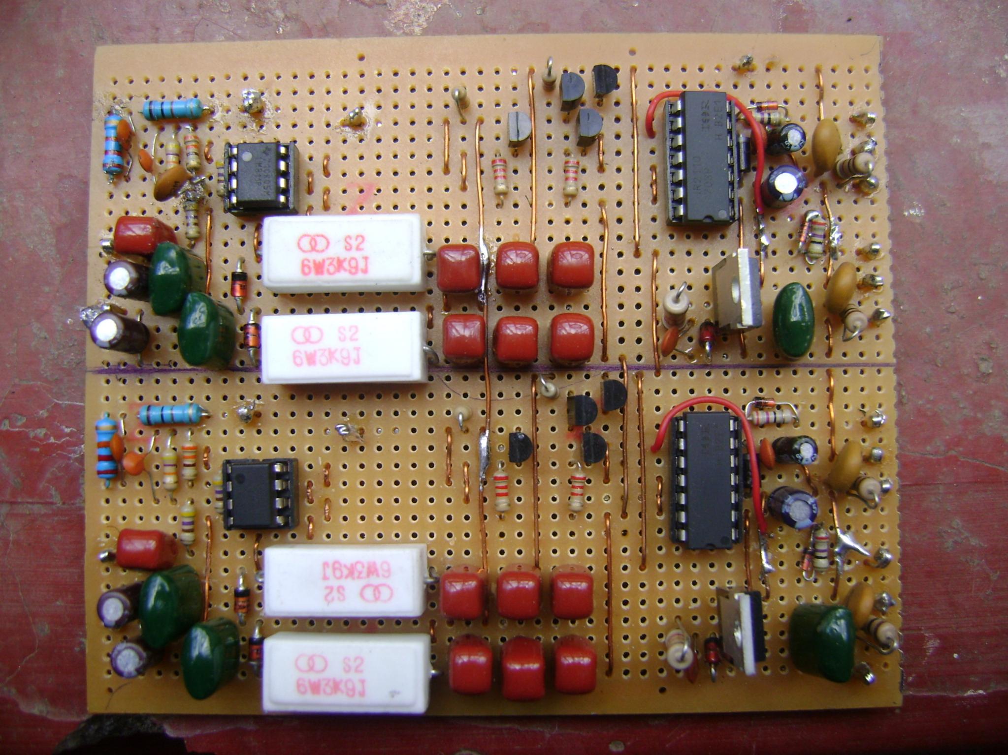

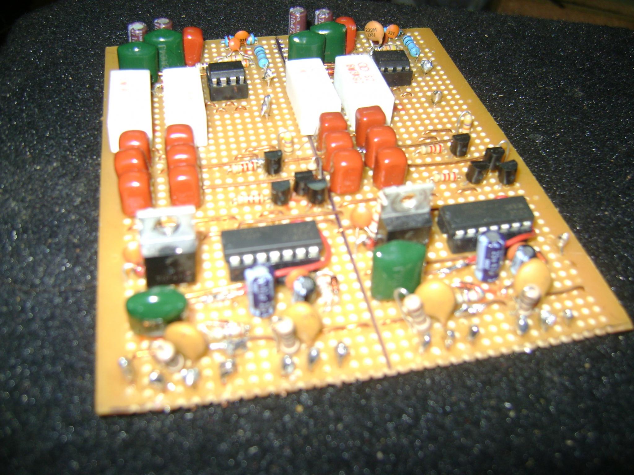

the photos
very good without pcb and very nice capacitors...I not find in Italy.. You want send me?🙂
Regards
i live in east africa i dont know how to send them but if there's a way i'll be glad to. the caps are 105 and i'm assuming they are 63vlts . but in the board they worked o.k @ 62 -0- 60 they are quite affordable here you can get 10pcs for 1$ glad to be of help stewin

hi stewin
greetings thanks for the pictures lucky you at least one project
for d class diyers affordable and once the mistakes have been rectifed it will
be a nice project how is the sound and is it really powerful bye
thanking you
andrew
thanking you
andrew
Good work, Stewin !
Nice board! If you could get it to work then I have no doubt that the amp works well..
