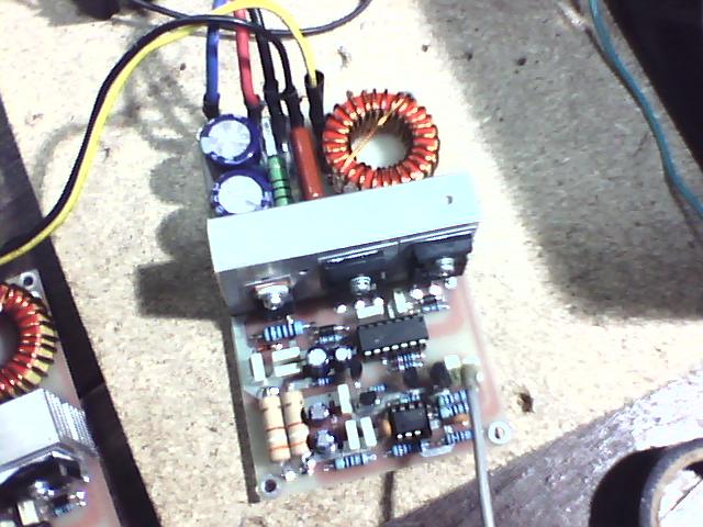

hi to all!!! at first when i build the amp ,the IR2110 was FAKE! i bought 2 off them both FAKE! after i bought the third IR2110 the amp came to life.....the sound is just amazing...very clear ...i use IRFP260 they are cold ....the output coil is hot..i use a toroid from an old pc power supply ....but even with that the amp works very well and sunds great...(sorry for my english)

This is mine .

Yes, I have made my own pcb. It works well. Amazing . I have not try to increase power rail yet. I will do it soon. But I have the same problem like many guy,coil is hot.Even through I try to use good coil from broken Behringer amp. Waiting for some suggestion.
