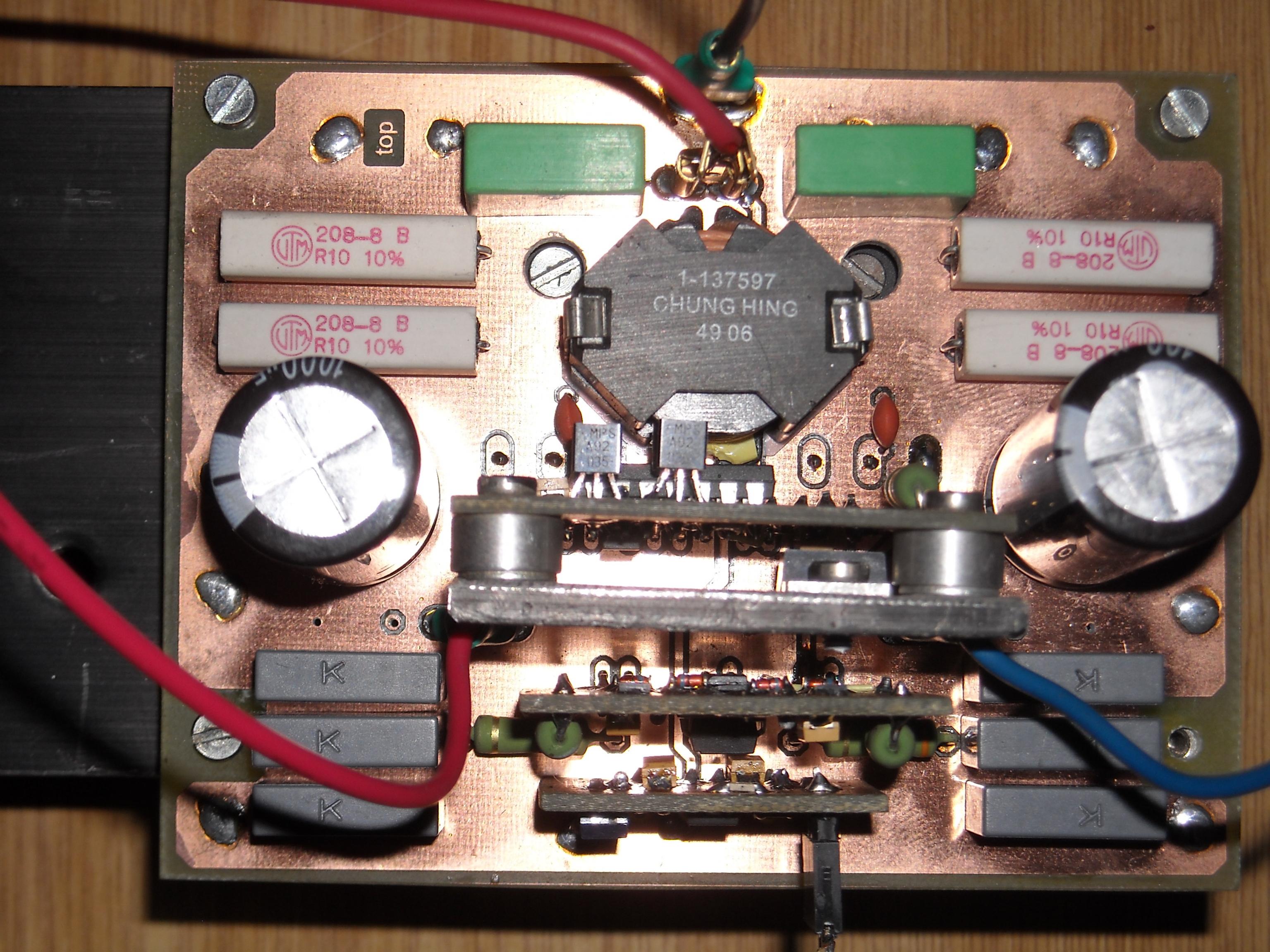

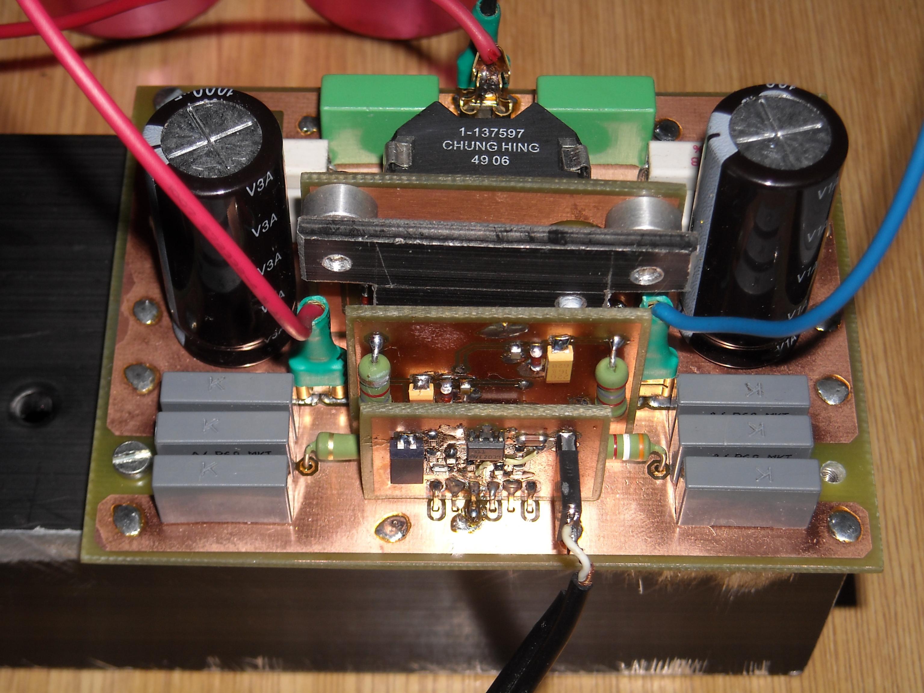

This is my module. With +-42VDC .All on the heat sink is warm. Coil is cool.

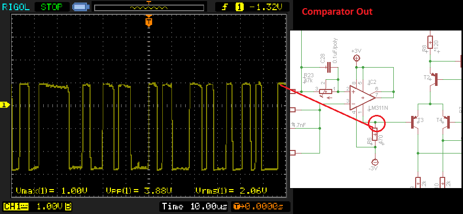

With +-42Vdc and with this big heatsink, heatsink should be cold. You should check for cross-conduction! (measure current from rails with no signal).
You should also check input nodes of comparator LM311 for transients from the output.

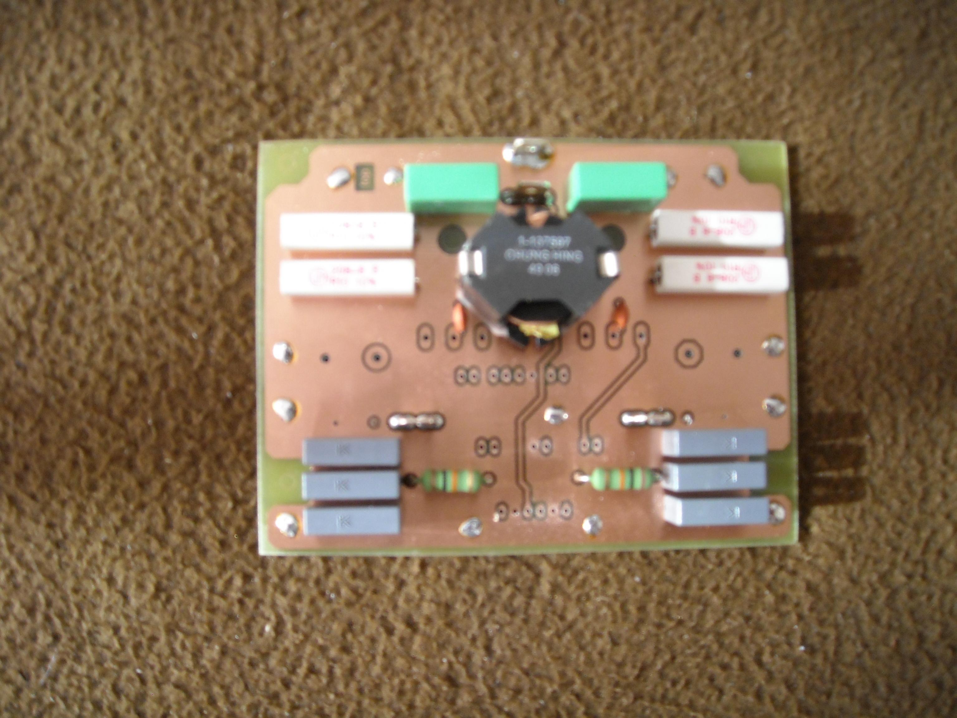

The PCB has the following improvements to do:
- bypassing should be close to the fets, exspecially ceramics for HF noise supression.
- the feedback path makes a loop just around the imput path (which also forms a loop)
- for filtering (specially HF noise) use ceramics
All these can cause high noise, since your supply lines are not well filtered (both main rails, and +-3V for LM311). I cannot see the main path of the ground line. As I can see the body of the TIP transistor is not connected to heatsink. Is the heatsink grounded? It can supress also noise too.

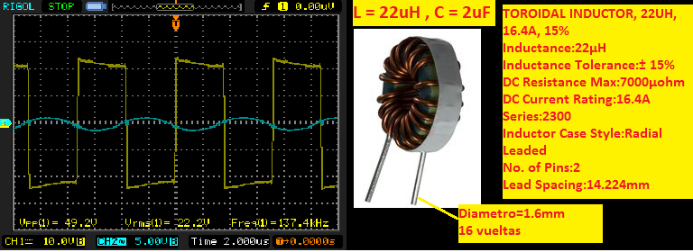

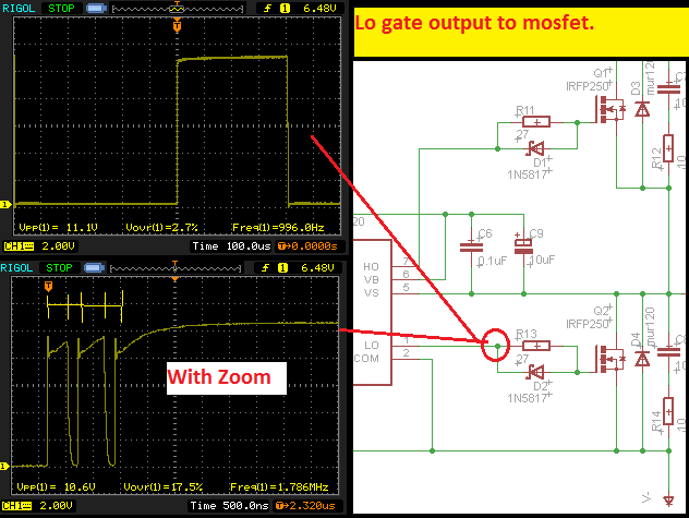

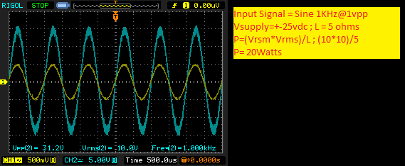

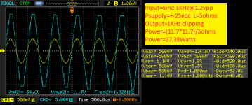

Some captures at low voltage.
I should have get 50w@4ohms but the gain value in my design was at medium so the 24 watts were right.
The inductor it´s getting hot quickly , the filter is good.
I think i could get skin effect by the wire inductor diameter.Also maybe the low oscillation but I´ll change that value later.

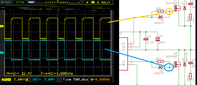

The oscillations on gate pin are better than old ones .

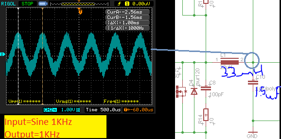

Which inductor are you using ?
I´m using this inductor
Its no good for class d, its a power inductor for a power supply.
Try a t106-2 core with a couple of meters of 18swg enamelled copper wire on it. I did and it doesnt even get warm.
You will get a core on ebay.
Your inductur is not good for class-d. Get somematerial -2 or material -6, use gapped ferrite, or there are lots of other solutions. (at 16A your inductor losses lots of it inductane.

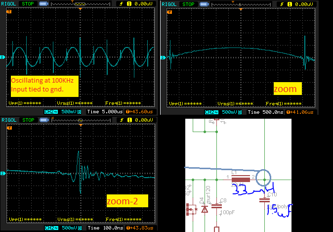

You should chek for cross conduction, dure to the spikes in you graphs. Measure your current from rails, with no input signal. The spikes may be also causef by the body diodes of IRFP250Ns.
You should also change frequency now. The high residual at 100kHz due to insufficient filtering heats up almost every core. Change it to about 200-250kHz.

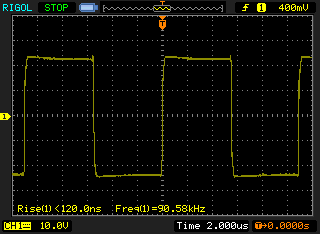

Good documentation!
But I think there are still some inconsistencies. The clipped output voltage should have been very close to power supply voltage. Probably the power supply was not 25V in loaded state.
A more detailed (100 ns/div, or less) drain signal transition at idle state would help to check if there is enough dead time, but basically it seems good. The spikes on output are probably caused by bad layout or badly connected oscilloscope cable (too long GND cable).
The last picture seems to be a measurement error, but I don't know how you made that circuit to work that way.

The spikes were with the old inductor as the pic show , 33uF or more idk , unknown value :/ .
The firts pic shows a nice filter and no spikes with 22uH@1uF.
I´ll upload more pics if my last test.

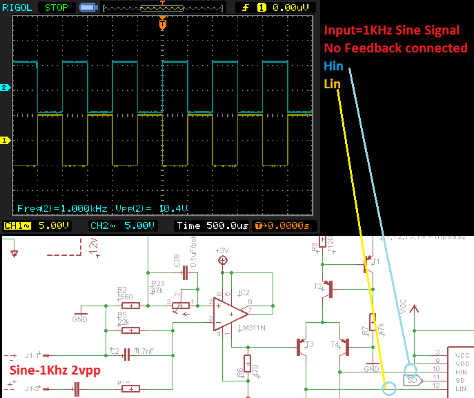

is it possible to reference the the comparator to negative supply rail?
In a full-bridge design, it is easier, and more widespread.
It is also possible in half-brdige, but more complicated (common of output and input will not be common 😀 )
