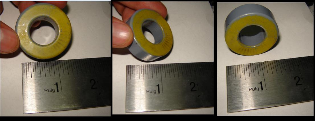

What material could it be this toroid ?
I want to use it but i dont have any specification.
any sugestion??
Color gray-yellow.
External diameter = 1 1/5" (1.5inches) - 38.1mm
Internal diameter = 13/16" (0.8125inches) - 20mm
wide = 9/16" (0.5625inches) - 14.28mm
-images atached
regards!
any sugestion??
Color gray-yellow.
regards!
I guess it's ferrite. You should measure AL!
If you don't have inductance meter, there are many other ways! You have to find some AC voltage source with a few kHz output (for example your sound card), put a resistor (for example 100 ohm) in series, attach the coil with 10...30 turns, and measure the voltage accross the coil (again, with your sound card input, and some SW)! You have to chose/altern such resistor/number of turns/freq so that Vcoil=0.02...0.3*Vsource!
You can differentiate between ferrite and metal powder with a very simple test: wind 20 turns, and put it in series with your regularly used tweeter (4 or 8 ohms, dinamic type!). If high tones are almost completely gone, then it's ferrite, if highs only slightly decreased, then it's metal powder. In the second case you can try to use it. In the first case first you need to break it into 2 or 4 pieces in order to avoid saturation!
An other way to differentiate between ferrite and metal powder: try to saw it! If you can do it easily, then it's not ferrite.
