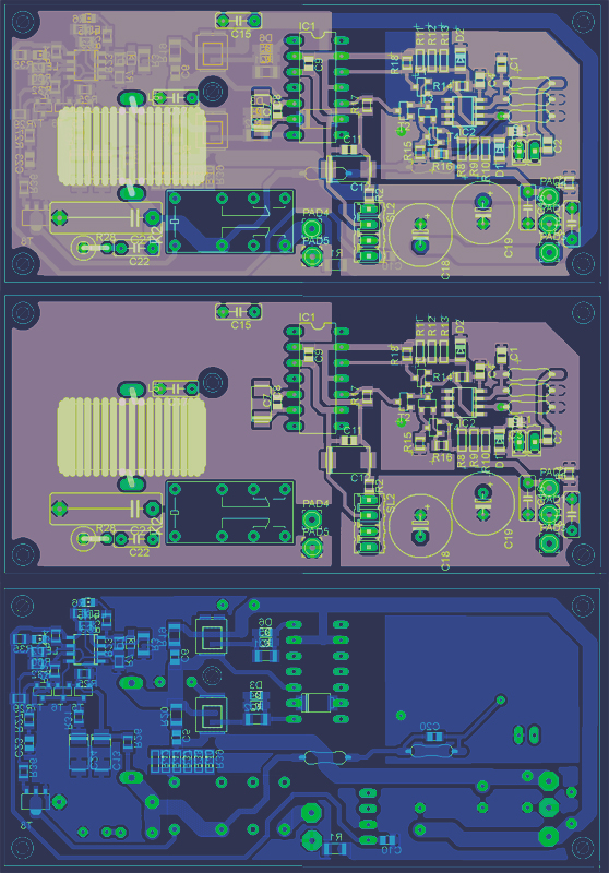

Almost done, still haven't figured out that AC connection, probably goes straight to the secondary of mains transformer...

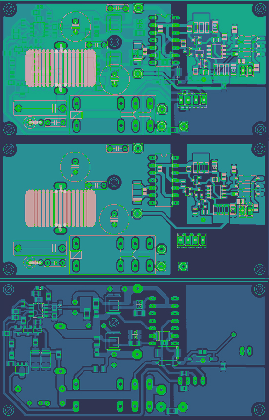

The new pcb will have the dzony's protection part..
Dimentions are 96mm * 45mm
The layout is not the best. One of the supply lines makes a loop around the comparator part. The other still goes straight next to them. Imagine the current path from power supply to speaker. Then imageine your right hand there, and check the induced magnetic field. It points right through the comparator part.
So this way there will be high noise, in the most sensitive part.
Lay the power lines so, that these high currents should flow next to less sensitive parts. The loop should newer contain noise sensitive parts.
Yes, AC conector goes to secondary of main transformer!
Relay will not turn on if you don have AC. On AC conector use 1N4007 and dont use 470nF, its bad, use 1uF 100V elko but be careful on polarity because on AC conector goes AC voltage from transformer and after 1N4007 its NEGATIV volatage, so negative pin of 1uF elko goes to R6 and positive pin goes to GND.

I forgot, on relay coil pins you can use led - named Active (show when relay is turn on), but from R5 to raley track use 2.2Kohm resistor and after him conect + of led, - of led conect to colector of BC639.
I atached new schematic in protection.zip with all changes that i told you!

Finished. I have uploaded eagle files. Feel free to make changes.. Also there is a drill marker that somehow got in the wrong place of the board, anyhow I'll post the results of the amp soon..

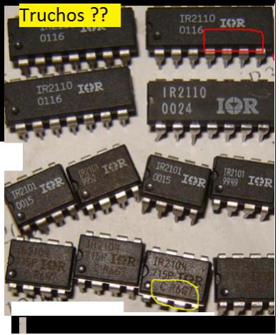

2N5401 burning...
Hi ClassDbuilders
I'm trying to build this UCD amplifier but always when I switch on 3 or all 4 2N5401 are damaged and also the IR2110 and fets😕
I use +40/-40VDC rails, IRFB4227, IR2110, LM311N. I don 't understand what is happen with my UCD amp... somebody can help me? All comments are welcome.

Can you post pcb that you use? Whic output coil? What is swiching freq? Did you chack all resistor values?
Can you post any photo, schematis that you use!? Are you shure that was 2N5401?

As Dzony said, please post you plans. If you do so then we can help.
Its 99% that you misconnected something, or you have designed something bad on your schematic/layout.

Yes please post.....and it can be ... you have fake / counterfeit devices
That happened to me twice.
When i turned on the amp specialy Q4 and Q2 were burned,also the ir2110.
While I was measuring resistance on each pin I discovered that pin COM and VDD were shorted ,also Hin with vss with a resistance of 40ohms.
In other ir2110 ic burned. Pins VDD and Hin were shorted with a resistances of 80ohms.
So

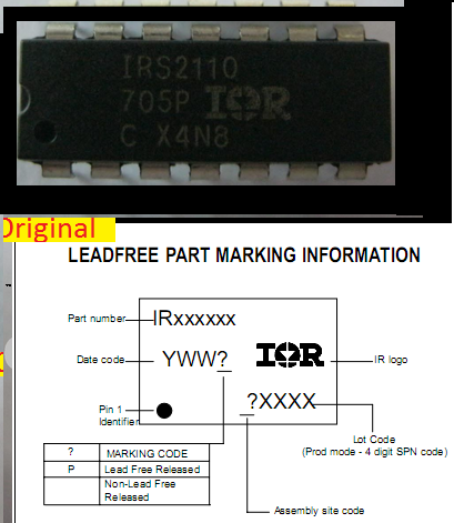

I have all fake ir2110 chips. Some of them burned quickly and others didn´t resist at high level voltages.
The originals have a laser print , it haven´t ink or something like that and have other code like the pics showed below.
I discovered it by tacatomon.
because He saw the ir2110 that i used in the amp and he explained me all about these fakes ics. Also there some posts about this in this thread.
My ics haven´t lote code only the ir2104 that i own
So
