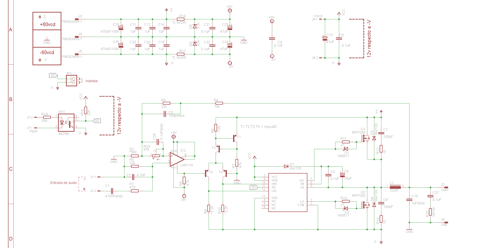

What is the resistor before the 12V zener? You should check it. At your schematic its 4k7, but it should be 6k8 for you supply rail (but that should not be an issue).
If you have a FET with high gate charge you should not decrease the turn on resistor. At higher temperature, the fet usually gets slower, so cross-conduction rises. Ant it can kill not only the FETs, but driver, and every other.
Put some scope probe on the supply rails, and see them at load condictions. You have absolutely no decoupling, they will be extremely noisy. Then anything can happem...
Your gate signals are really messy, but switching signal seems nice.
You must put the oscillation frequency up over 200-250kHz. I looked the spanish forum, and from the schematics (as I cannot understand spanish) nobody tried the normal connection of the comparator, and even raising switching freq. I haven't seen any input stage with differential inputs.
(offset is a tiny problem, and for example differential inputs should decrease it too, and I've seen lots of photos with air-coil inductors... forget them. Most of all the inductors heat up because low switching frequency and the bad filtering)
Rule of tumb: switching freq should be a decade higher then corner freq, to ensure good filtering of carrier signal.
Dzony988: output filter is good as is (for 4-8 Ohm load), with your values, the corner frequency incereases. For 2 Ohm you should redesign the filter: 20uH and 2.2uF would be better.

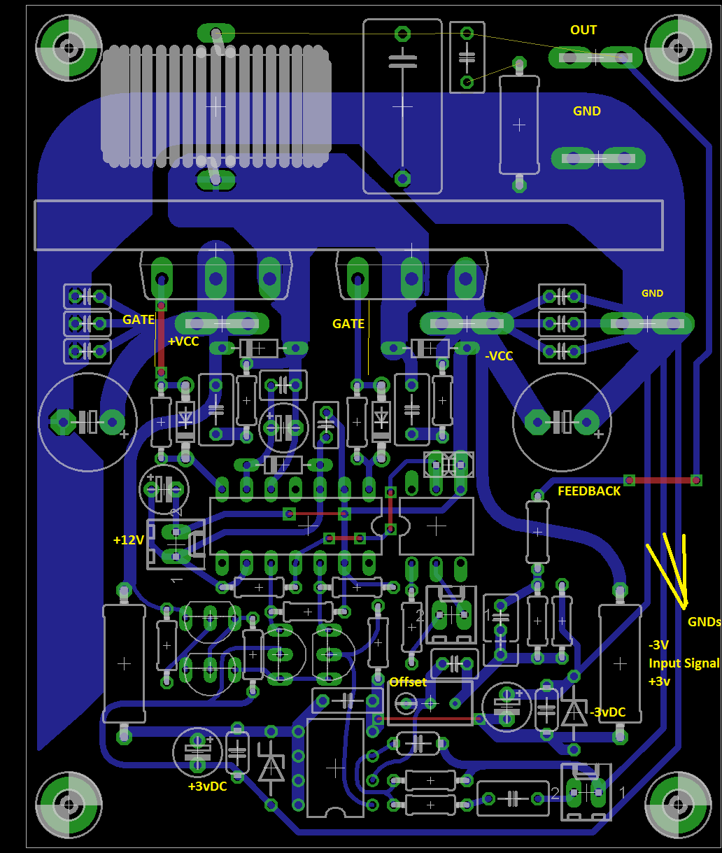

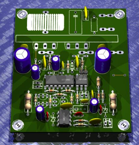

Now I'm making this pcb .It is like 80% done.
I have to check the gnd returns :whip:
Ty luka, I´m working on it.
Gate signal is closest to mosfet.
Power supply line is direct on mosfet pins.
Capacitors are closest to Drain and Source pins.
What do you think about this new pcb routing?
Is there anything to change ?
I´ll apreciate your comments and tips. :grouphug:
ty
regards! :cheers:
P.D. I´ll add some test points to pcb.:trapper:

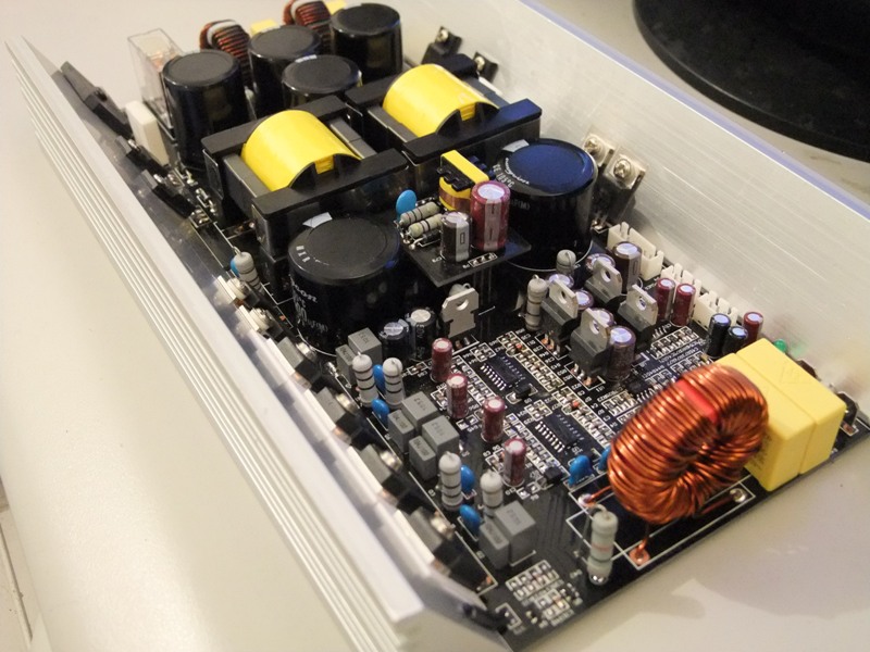

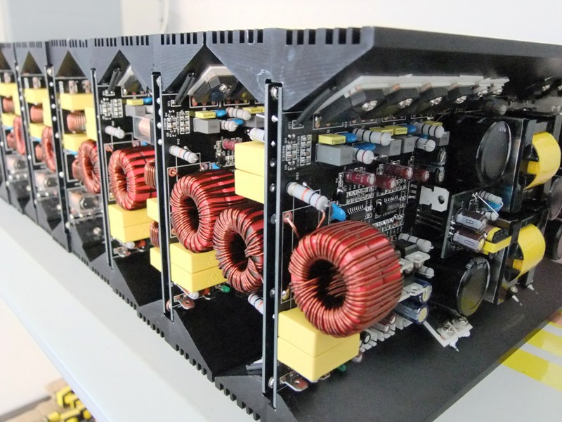

Prototype pics below:
ty
regards! :cheers:
PCB seems nice. C9 is not necessary, instead increase C6 to 1u ceramic. Then you can make gate drive path shorter.
What does the opocoupler do? Only MUTE function?
Use the normal connection of the comparator. I reccomend to redesign the input to be balanced. Then the 47k trimmer is not necessary, (if you decresease R5 to 10k then the offset is also smaller, or put a series capacitor with R2 to ground)

This weekend I made an amp with this (with modifications) for sound reinforcement in a church. It is very nice. The 250W @ 4 Ohm amp, with SMPS, and preamplifier with into a 20x10x6 cm box.
I reccomend you do biamping. It is much safer for the tweeter, and you can even push it much harder.
