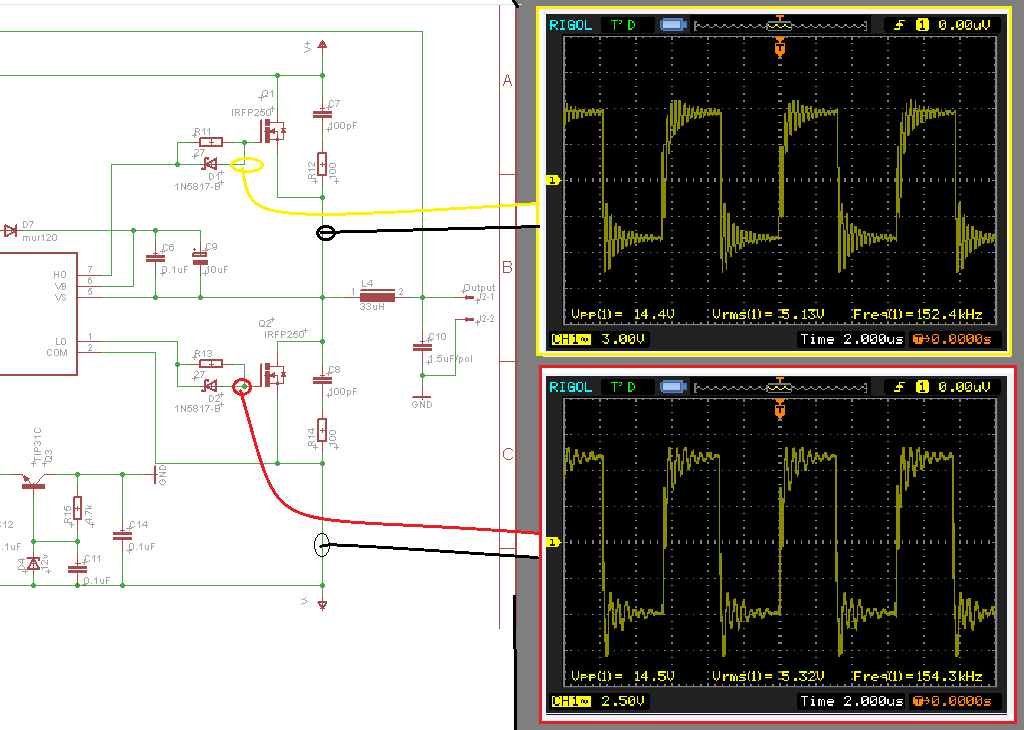

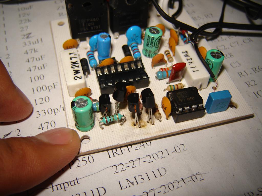

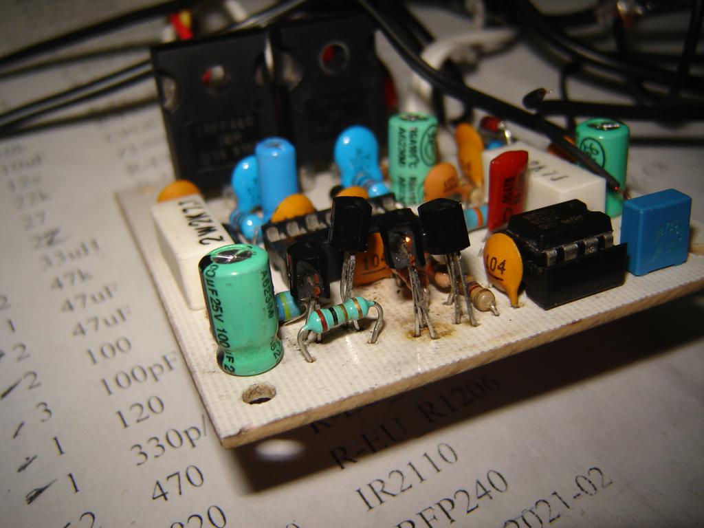

Has anyone had an overheat in the bjt transistors stage?
I built the amplifier to 400W@4ohms,,power supply= +-60vcd , but the transistor stage(shift level) gets so hot that it cant be touched. It sounded good but then Q1 and Q4 transistor blowed up.:flame:
When I replaced these transistor the overheat still. So, I have changed the values of R3=1K instead of 120 ohms. R9,R8=18K instead of 2.2k.
The heat goes down. When I turned on it again it sounded at least some seconds then Q4 transistor blows up again. The ir2110 was dead. :/ :RIP:
What could be happening ?
P.D.Muerto = dead :dead:
I had troubles with zener-transistor regulator , it blowed up too , when i turned the volume to max. Now it´s solved with an external power supply.
Are you sure they are 2N5401? Did you checked the footprint? Other manufacturers can use other footprints, check the legs with a transistor tester.
Since your trnasisturs burned, the HIN and LIN inptus of IR2110 got high voltage, so this is why it burnt. The Q1-Q4 should disspate less than half watt, they should be lukewarm only.
You should not change the leverl shift resistors, otherwise the delay of level shift will be very slow, the given values are quite good.
Your reglutaor for Vn+12 burnt? Are the FETs okay?
Are you sure you have 2x60V DC?
If you chosed your regulator resistors well, they should be warm, but they should take.
If you turn up volume, bus pumping due to bass can raise the power rails.
There must be lots of stuff you missed, or misconnected, or did not measured or calcualted well. Check all the values after.
How much capacitors do you use? What was the load (pure resistance or speaker) What was the supply?
The original design itself is not reccomended over 200W, because there is no enough decoupling at the supply rails. There should be some elkos near to extend peak current, and cermaic capaitors under them to extend high frequency current.
OMG!
Now i see you used IRFP460 !!!!
I'm sorry to say that, but you must have been really stupid, first read after, then try.
(Or you will learn it on your own fault. - as now)
The IRFP460 Fets are very old 500V Fets, they have very high gate charge. They intended to use at n*10kHz SMPSs, not in Class-D amp.
You should use the lowest (but in safety range) voltage rated fet. You must cehck for gate charge, body diode charge and rdson. If body diode charge high, you must use diode trick. If gate charge high, you must use extra transistor to help turn off, or totem pole. IF rdson is high, but any other is low, you wil have high conduction losses. IRFP460 is in ALL WAY a bad choice
Try some IRFP250N or IRF640N if you can't get any good, modern fets. And first read some...
I'm sure you had cross-conduction, and I think everything was conducting everywhere...

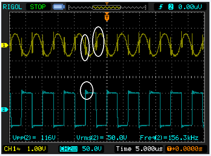

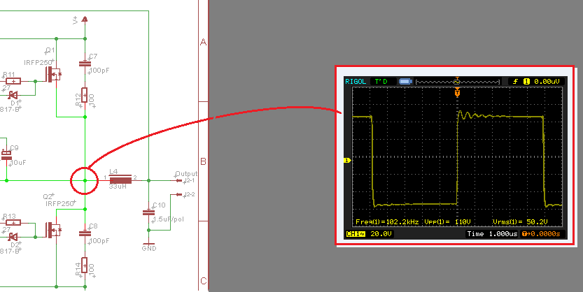

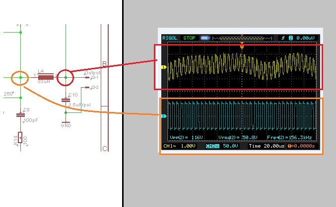

My first try was with the irfp250 , but i haven´t more of them. I know irfp460 its slow but i havent any problem with the mosfet stage.
I use mpsa92 instead of 2n5401.I checked the footprint and it´s ok.
(irfp250)I had one prototype working a long time , but when i did the test to get max power the power supply blows up again.(12v supply Zener-transistor ,Opened Zener).I measure atleast 150W@4ohms (4ohms speaker and 6ohms pure resistor.)
I thought that i got bus pumping effect when i was trying bass tracks. But now trying with 1Khz signal it happened again.
I measured all supplies.
10,000uF by rail
I use bypass diode , mur120
Snubber 100pf-10ohm , I did not see spikes in the output stages.
Also the amp its oscillating at 150Khz
I read all thread , spanish and english threads.
I change the Rg resistor 27ohm to 22ohms.Whit the 12v external supply to the ir2110 the signals looks better less noise and oscillations.
The pics below are with irfp250.
i´ll upload more captures soon.
