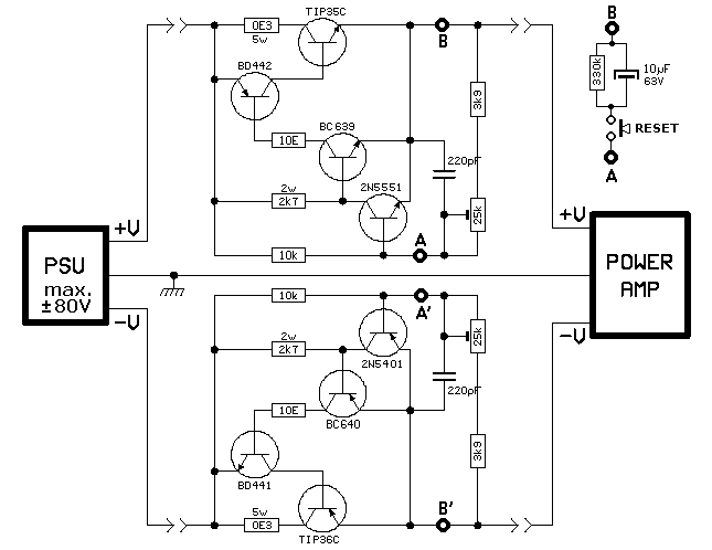

Overload protection without shunt res.
Hi to all
One good engineer from my country was recommended to me cheap and very good solution for overload protection without SHUNT resistor. He used this schmatic many times (for 30 years) and this is good because can use with any amplifier including this.
Actually its electronic fuse, very fast and stable and good because it has trim pot for setting current when amplifier will shut down.
Look at the schematic and read the word document that I atached. I belive you can understand because I use google translate from serbian to english.
What are you think?

"without shunt resistor" ???
There is a 0,3 Ohm + transistor shunt in your schematic.
It will dissipate more than a simple 0,033 Ohm shunt (for 20A current sense).
So this idea is idiotic. You can do better with only a shunt and 2 transistors per side.
So,for electronic end led its need 12V. J1 is short curcuit and J2 conect to SD pin. SD pin goes directly to J2 or have something with Ucc-. Did you test this. If you didint, i want to test this on my amp.
What about with voltage to gate of BF and conections to Udd and Ucc- ?
The 12V supply is all referenced to the auxiliary supply of the IR2110. So the ground in this schematic goes to negative supply, SD pin is the SD pin of IR2110.
I haven't tested this, I've only simulated it.

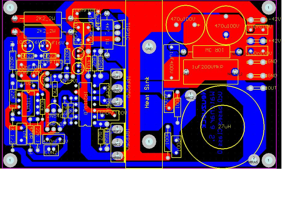

Why do you think everyone uses the same layout editor as you?
If you want help post things as, so we can help.

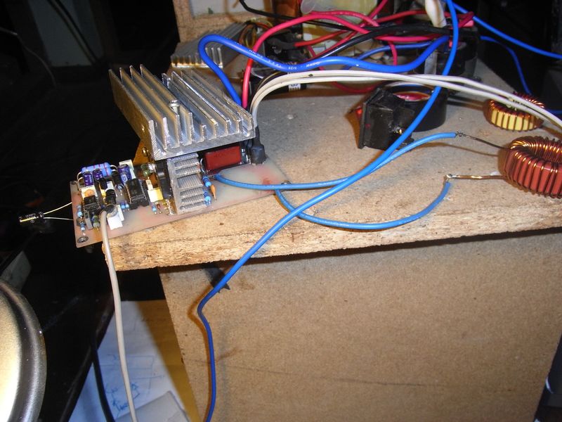

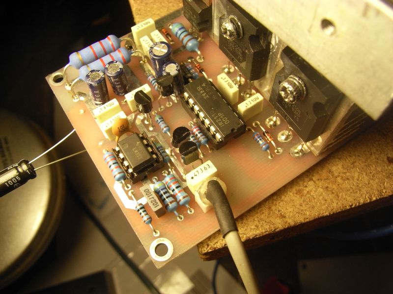

Please post pictures about your setup. (the module you built, with supplies... connected) I find my ask trivial, cause the problem is sure be there, then we can tell what.
This is my module. With +-42VDC .All on the heat sink is warm. Coil is cool.
