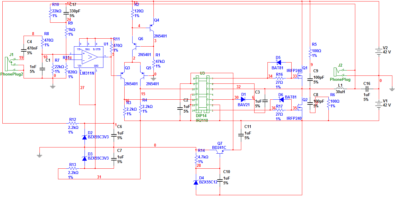

This is my first prototype of UCD. 400W/4ohm sin @ +-60V

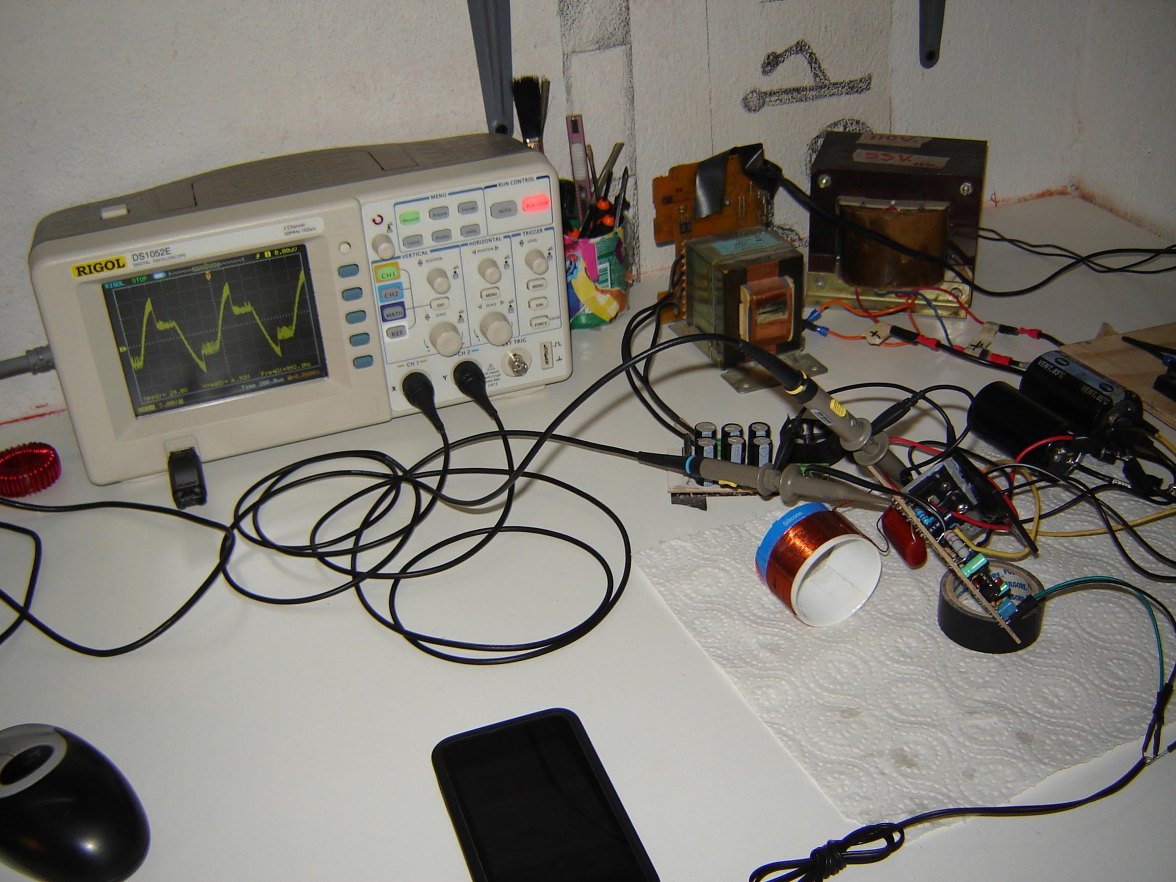

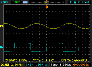

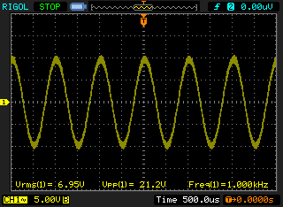

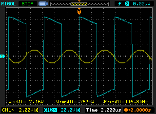

Testing my prototype at +-60 vdc .
Input Signal at 1KHz , less than 1Vpp.

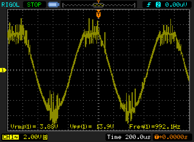

I got these results.
Before the inductor I´m getting a nice square signal,after the inductor i dont know why the signal it´s like cutted/. I got less tha 5W 😡
What do you think?
a inductor problem?,high side mosfet driver problem?

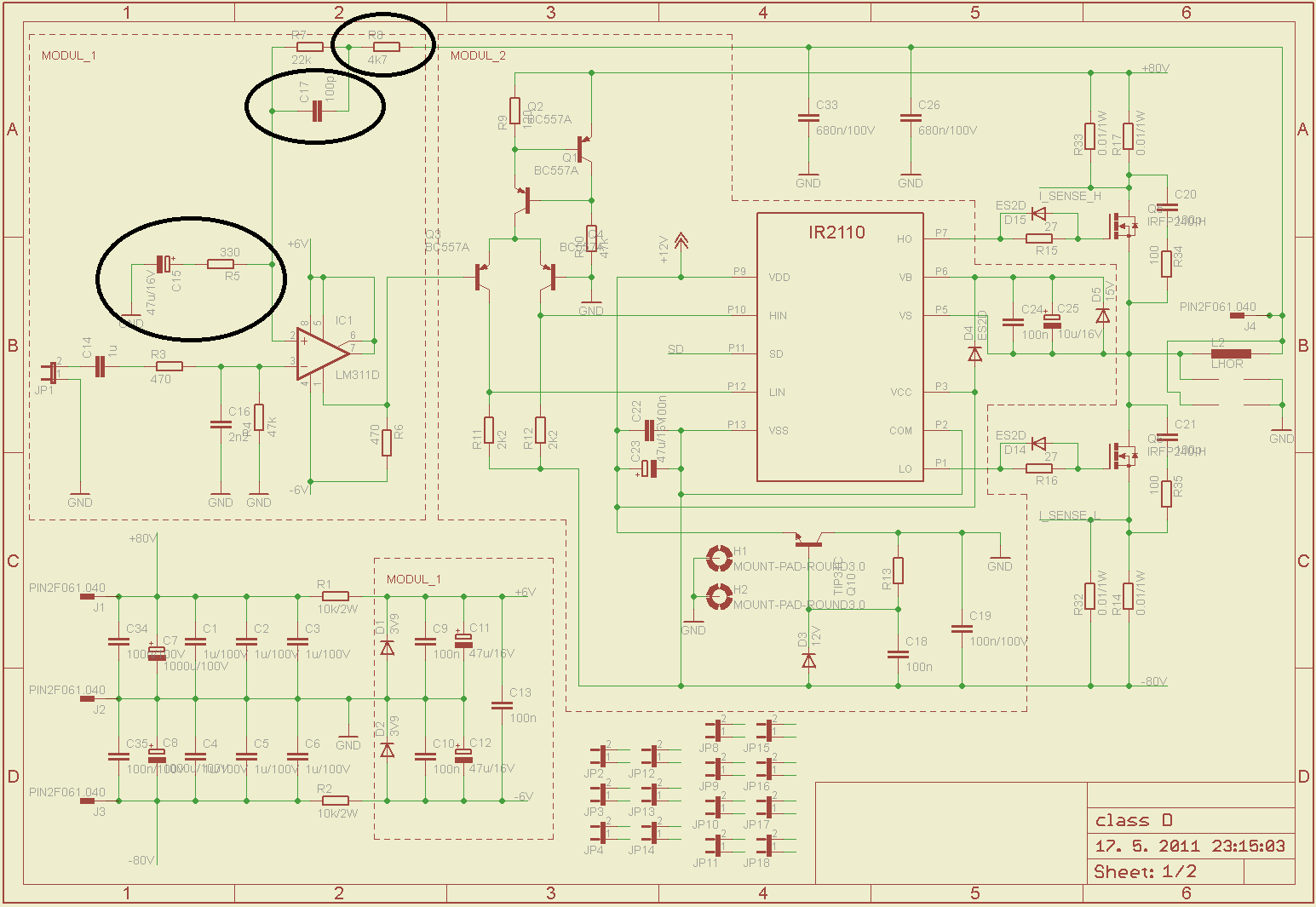

Hello, try change these components. R5 change amplifier gain and R9, C17 change oscilation frequency to 250Khz. 😉

For modern fets with fast diode (or older like IRFP250N +bypass with MUR120) you can change gate resistor from 27Rto 22R for better gate charge and C15 to 100uF for beter reproduction of low frequency because 47uf is lower limit in feedback for low frequency (like 70Hz or lower)
Do you measure swich freq with this satup? Do you exceed 240KHz without noice?

Amplifier run approximately on 250Khz with small noise. How I can start oscillate amplifier without signal? Because when I turn on, amplifier not oscillate.

Is it a saturation problem ??
I can't go up more than that.

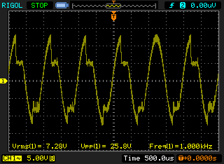

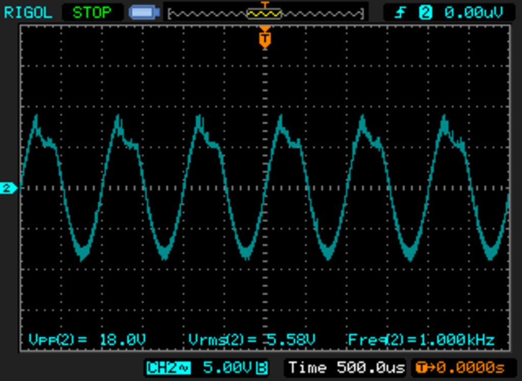

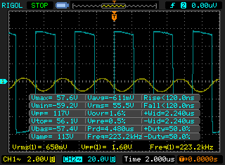

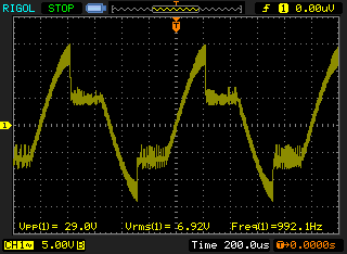

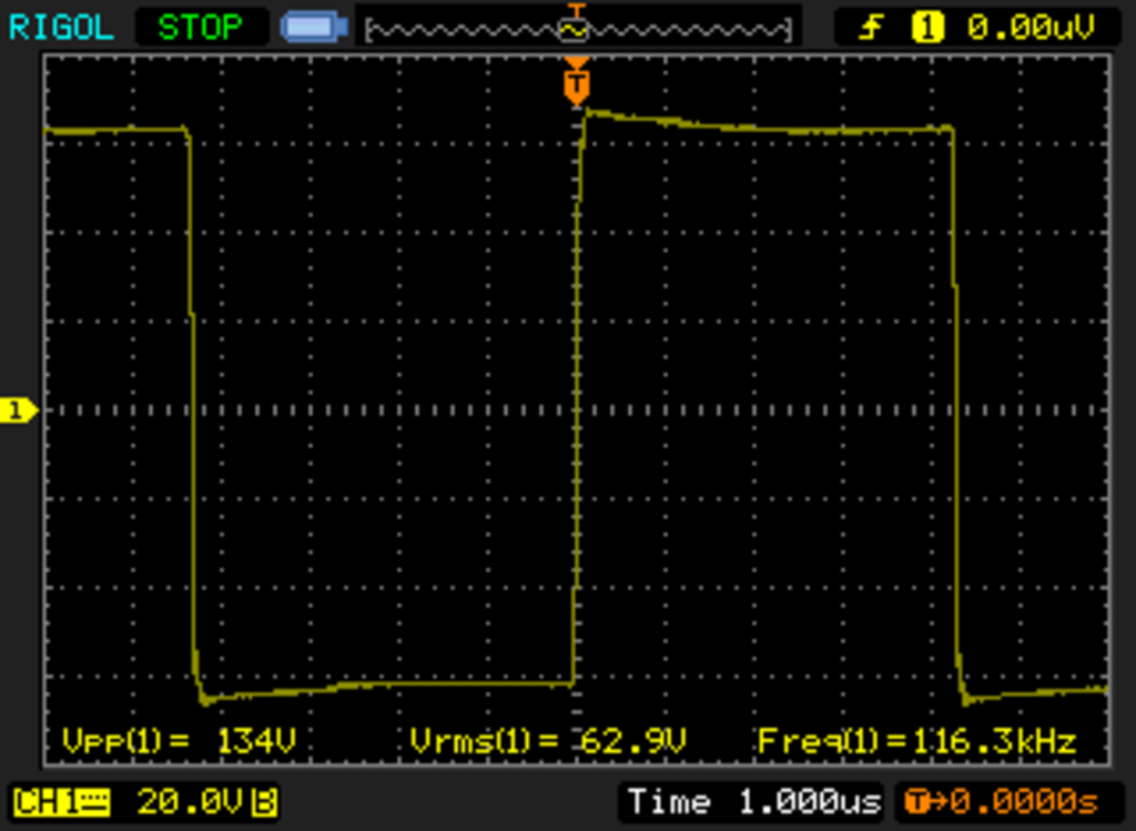

Well, I changed the toroid core .
Now i can get more power , a little more.
Toroid core 22uH . It is getting hot quickly.
The output looks very clean . Now the oscillation goes up to 230KHz.
I got the saturation at more high level than before.
So I think the problem is the toroid core.
What do you think ?
Pics below :
Old inductor.
New inductor before sat.
New inductor Sat.
Oscillation and output.
Oscillation

And something else.So I think the problem is the toroid core.
But you didn't tell enough/any informations about neither the old nor the new core. Also the load is unknown.
I don't see any sign of saturation.
5 ohms load.

And something else.
You are right , I have changed the core coil to air core and i had the same result almost at the same rate VRMS 29vrms.
So , the problem is in other place , I´ll check comparator output,Hin -Lin inputs and mosfet gate signals.
Any suggestion??
