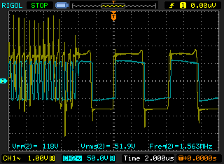

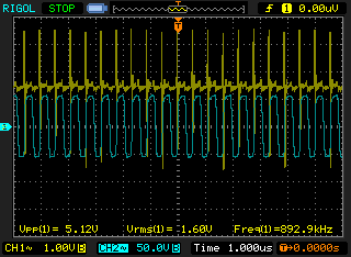

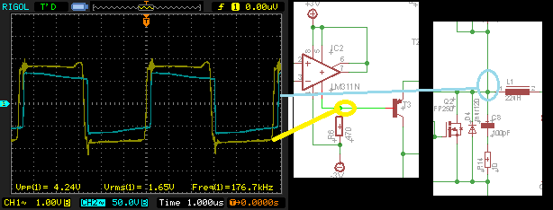

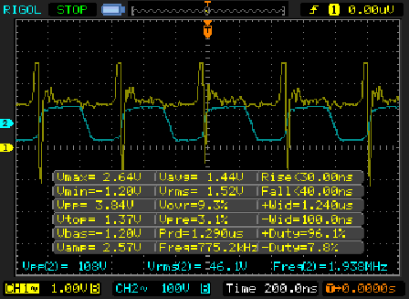

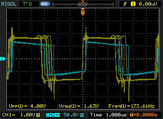

hi Pafi
I´m using bypass diode , mur120.
Maybe the layout
I have checked the oscillation on comparator output and mosfet output(Input to Inductor).
It works great at low volume even with air core.
The problem comes out when I set the volume hi as 0.8Vpp.
The oscillation goes wrong , on comparator output pin the signal has gone up to 900KHz and it isn´t square,if I turn down the volume the signal looks good again.
I did a double check in feedback stage,all looks good.(Components values,etc..)
What could be the problem ?
Noise ??
the lm311?
Pics below :
-Oscillating without input signal.
-Oscillating with input ignal 1KHz less than 0.5vpp
-Comparator output error if I set the volume close to 1vpp.
-Comparator out zoom.
-Turning down the volume the signal looks good again.
-Output Signal after inductor, the problem occurs at same level like 30VRMS(inductor 33uH,22uH,air core).

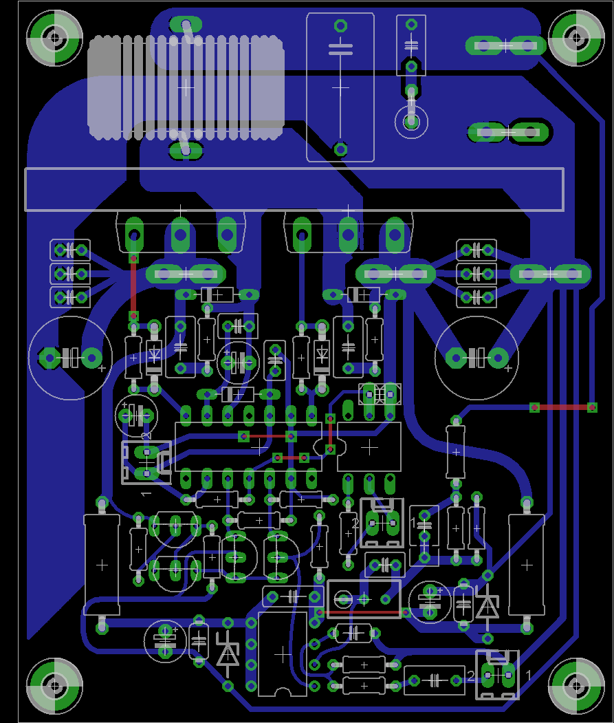

Please post your board with labels and post your schematic too. Can you check the supply busses for the comparator for any ringing?

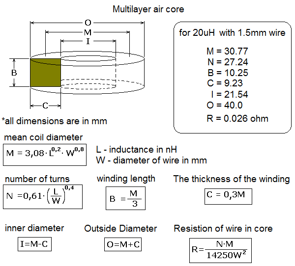

This is multilayer air core inductor, with dimensions is very small.
Maybe we can use it, what do you think?
I posted example on pisture for 20uH and 1.5mm wire (dimater is 1,5mm)
If you use other diametar of wire all dimensions will change, then use formulas
There are some problem with it:
- It radiates more magnetic field than any other inductor.
- With solid wire it will get very hot. Litz wire is a must!

It's been a long time, I haven't been here. I try to answer some questions people asked me:
- DZONY: Changing swithcing freq to 400kHz can be really hard. First you would need a faster comparator. But 400kHz needs very fast FETS to. If you increase the switching freq but with the same prop. delay, the output distortion can rise at lower power levels, due to modulation error! For an IRFP250N >250kHz is a no go... (mybe with some IRFB4227 hmmm 🙂 )
- All people favorising air cores: Air cores radiate a much! They are lossy. Even when they are colder then other inductors, they can have more losses! (why? heat is spearated to a large volume, and the cooling area is much bigger). Due to losses are mostly copper losses, and wire is long, you need stranded wire or litz! The AC resistance can be much more then DC resistance (due to skin effect). You even not thought about parasitic capacitances. In a good designe toroid inductor there is only one layer, and a sufficient start-end gap, this minimises parasitic capacitances, thus increasing filtering at very high frequencies, where a multilayer air core inductor would be seen as a inductor with a big parralel capacitance.
- pedro: Why am I stupid? Fuse can not be an efficient and reliable over-current protection at power amps.
- electronico: you inductor is still no good one. Due to your relatively low switching freq, you need at least 30uH (rule of a thumb: swithcing freq should be about a decade higher than corner freq...). Get some proper material, like T130-2 or T157-2, check it here: Toroids, Ferrites, Parts, Kits, Toroid King, QRP Erector Set, I am sure they ship to Mexico, or get some gapped ferrites. You can take apart transformers from SMPSs by cooking them in water, they are usually gapped, with increased gap, you could build a good inductor. Last weekend I cooked "transformer-soup" for an hour, the reward was a dosen of ETD cores. You could also check supply ripple at the legs of the fets for proper decoupling.

Air coils are big, ineffective, and radiate noise.
Because they are big they were able to dissipate the loss because of the high current (because of low switching freq).
Since this is an UcD amp, the feedback is after inductor, so every non-linearitiy of the inductor is compensated by the feedback. Gapped ferrites also very linear until 80% of saturation. Iron-powder cores are less linear.
So chosing air-core inductor for linearity is stupid. I think they chose it because any other could not dissipate, mainly because the low switching freq. A bad solution for a bad choice.

Pedro!
A core is not an inductor. Air core can be good, if you want to build an induction heater, or antenne.
Forget about low DC resistance, it's not really important! Any resistance below 0.01*Rload (40 mohm at 4 ohms load) is perfect!
What is more important is Q factor at switching freq, and this is quite low for a multilayer air core inductor made of solid wire. The reason: magnetic field doesn't stay inside the "core", it penetrates into the wires as well, causing eddy currents. The density of this eddy current can be (and will be) much higher than the idle ripple current density, because it is induced by many turns.
And of course the opened inductor radiates very much EMI.
Capacitance can be low or high depending on the winding scheme and insulator type/thickness. (This also applies to any other cores.)

The inductor from class d amp may be a good choice.
