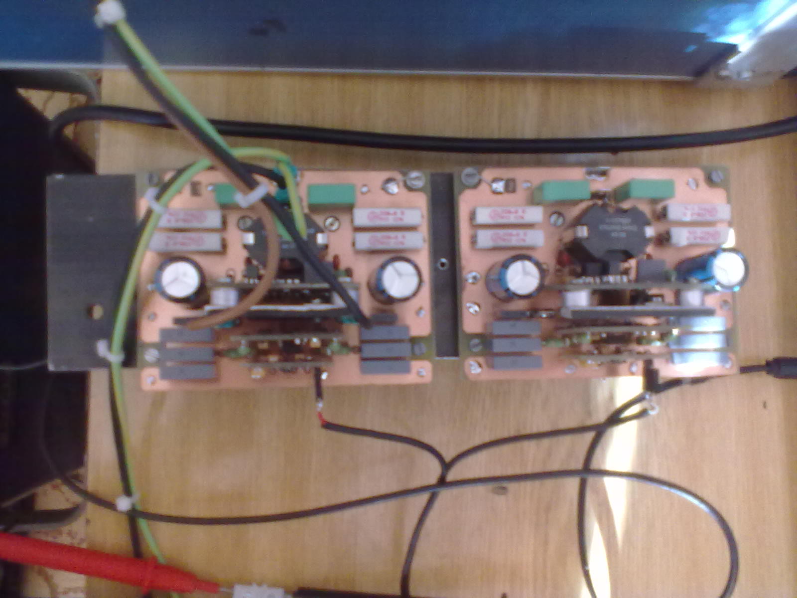

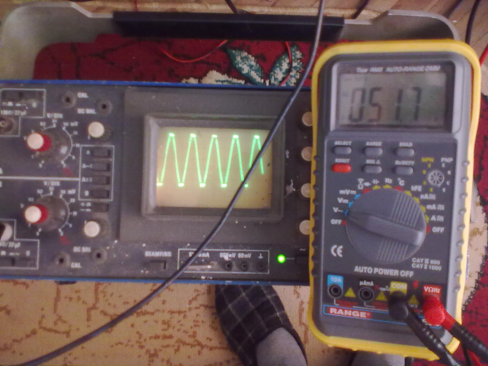

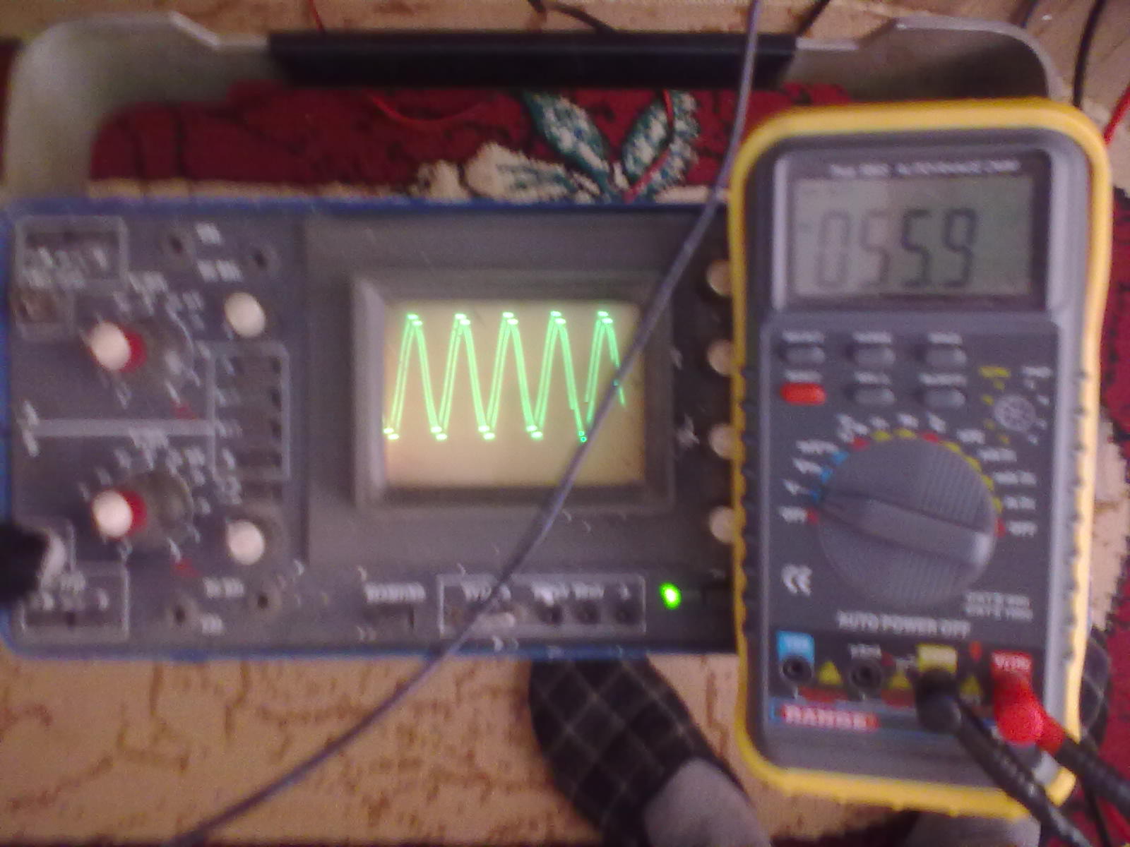

Dont know, but the difference between 10k and 1 k in noise is small.
I think it isnt worth to add 1 NF, ok with 4,7 nf noise is really goone but the good sound too...
any solutions to kill noise and save the good sound
NMOS: think about the little of what you did, because you don't want to think, just want answers. This is not a way it goes.
As Pafi said you must first realize where noise come from. If you have an oscilloscope measure every point with it if you can.
