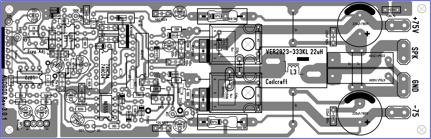

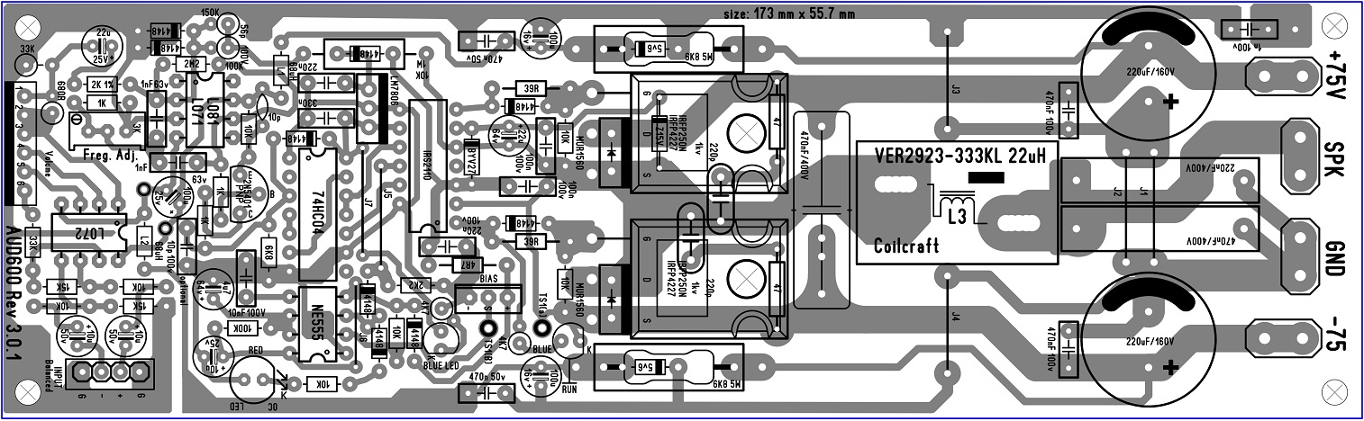

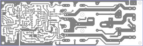

Hello gentlemen I made a re-drawing for the AU600 and mister manoj send me the schematic and I notice just a few changes on the older PCB layout what I did is fallow the Rev 3 and go from there, and from the schematic I notice some components that were not present on the older layout PCB but they are in SMD to bottom PCB and what I did is to give them some room to place regular through hole components, this has the Coil Craft coil but I can also modified to get the regular T106-2 also, I will leave images here so I really appreciate if some that has build already can see if there is any bug or errors "do not mind about the coil it can be changed later" :) the other image grey color is for you to see with the silkscreen so no hidden connections , well I will continue here checking the layout still and lastly I found space for some of the LED's but there is one that might be difficult for me to place it is a blue LED SMD that is close to 74HC04 I will try to figure out where I can placed :)
Best Regards
Juanhttp://www.diyaudio.com//www.pinterest.com/pin/create/extension/
  • AUD600 Rev 3.0.1 Juan.pdf

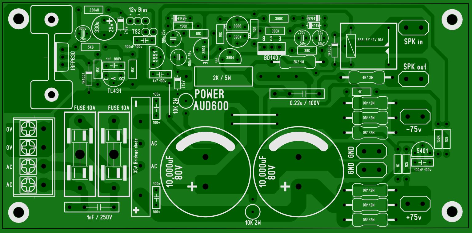

I have a question mister manoj, the power supply circuit this one you see (green) has DC protection or just a soft star circuit time delay seconds for the SPK out ? on lastly I made the updates from the AUD600 circuit you send me and it was difficult for me to find space for the components but I was able to do so, yesterday I forgot to add the 470nF 400V caps and now is on the PCB I think this will be a great project for me :)
Best Regards
Juan

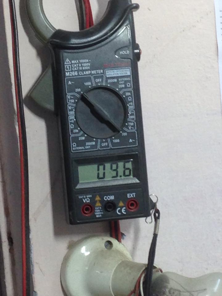

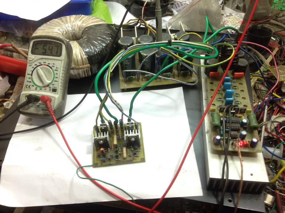

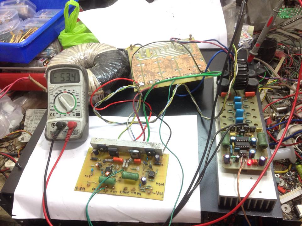

CLASS D
Hi Manoj
greetings testing class d with some rail switchers 220 input AC current
reaching 12 amperes per ch
warm regards
Andrew
